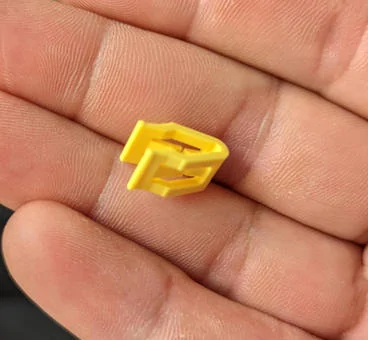

I found it on the passenger side's floor mat today, not sure if it's from the car or what, can someone confirm?

Looks like a wire clip. Check under your seats and see if you have any stuff like it?
stev3french
Jun 11, 2021
44
42
2021 Mach 1 Twister Orange w/HP
These clips typically are used to hold trim pieces together. Check to see if it seems like any of the trim is not being held in place well. Otherwise maybe its a spare that you can hold onto :like:

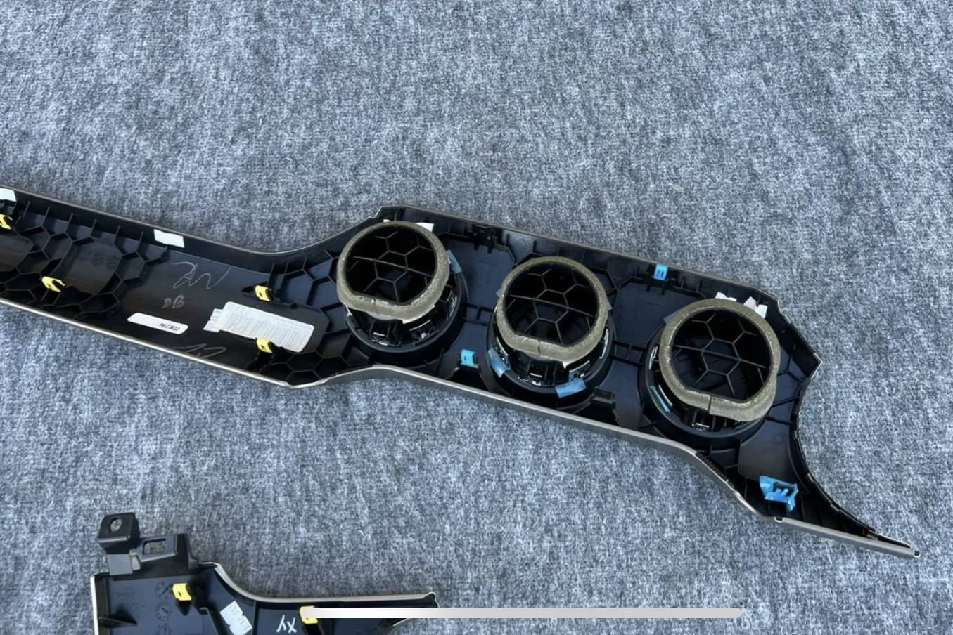

Those clips are located on the back side of the dash trim pieces - L side by headlight switch, Center HVAC/gauges and R side along side glove box. Possibly used elsewhere for upper speaker grille and/or center console trim.
They can be blue or yellow - not sure what the difference means in color, but those are the most common.

would it be possible for you to take a pic and point where you mean exactly?

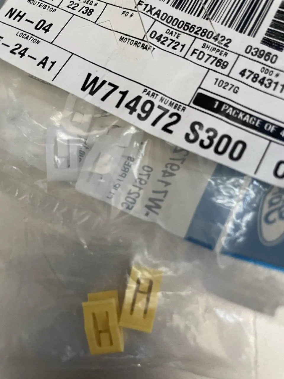

Hey I recognize these clips! I have a spare set or two. As others have pointed out they are a retaining clip for the dash trim - The yellow are part number: W717661-S300.
The white clips are W714972-S300, and used on the trim around the shifter/lower center console area, I believe.
Other than the color they are identical (as far as I can tell).
There is also a blue color clip seen on the trim near the air vents, and probably other colors used elsewhere. My guess is the color indicates where it's used in the interior, so in the assembly process if a loose clip is found they'll know where it came from.
If you pull the dash trim off you'll find where it is missing. Be prepared to have a thin pick or trim tool handy as these tend to come off inside the dash but can easily be fished out or pushed through far enough to fall down onto the floor. If you lose one they're cheap to replace, something like $3 for a set.
