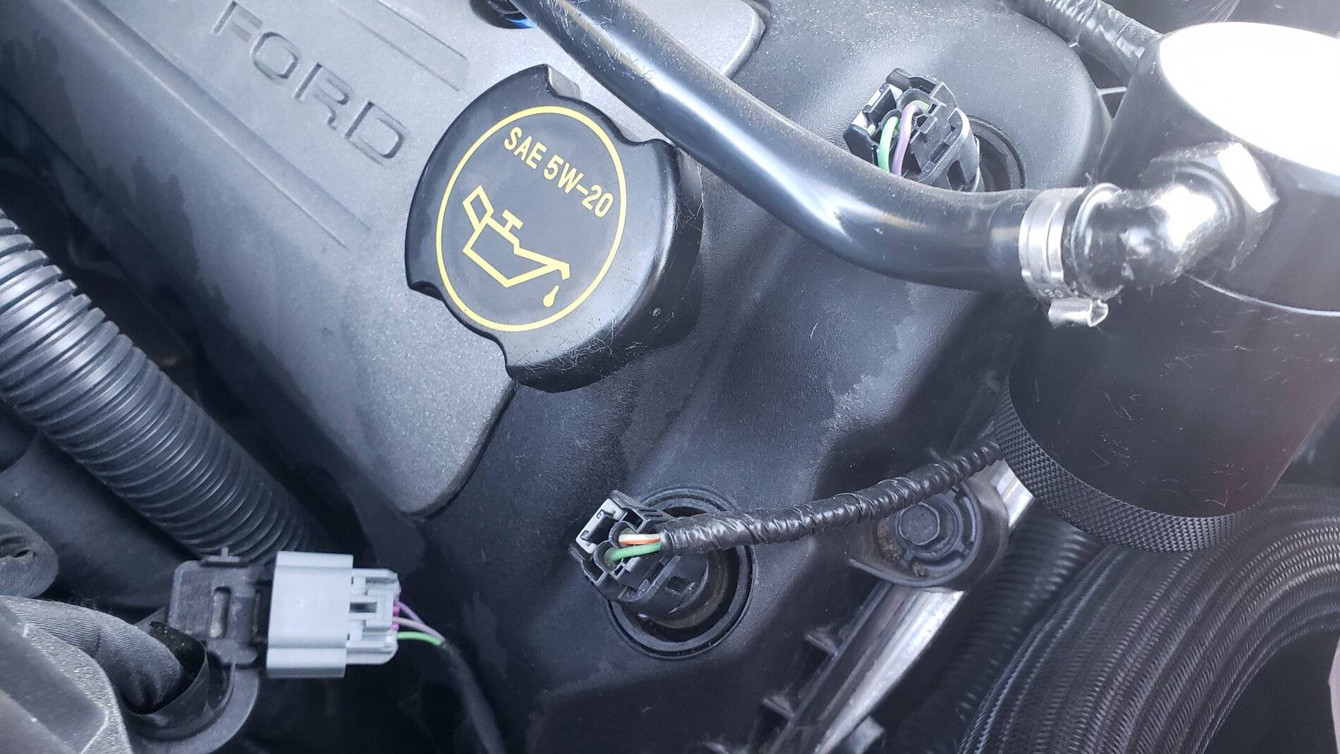

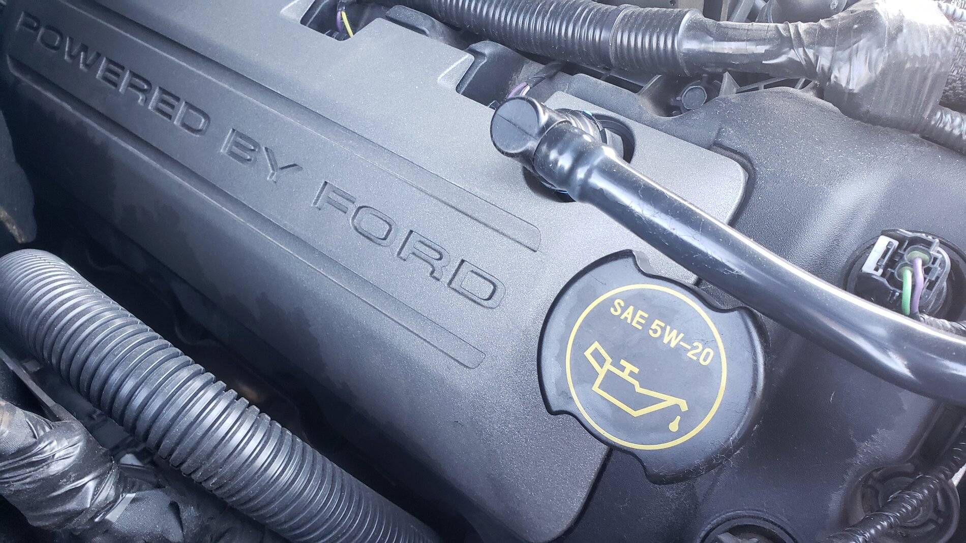

My thoughts were also that I really should be noticing it somewhere. The car does have another year of powetrain warranty left, which is why I thought going to the dealer ASAP to start a list of events (of sorts) may be a good idea, in case it ends up being catastrophic. I went back out this evening, looked at the catch can, looked in the engine bay with a flashlight, and really got no further. The catch can had maybe an ounce of oil in it, there was some oil residue on the coil cover, passenger side, but I'm pretty certain thats from a bad clean up job when I put the last quart in and spilled a little. I ran it and didn't notice any smoke at all from the exhaust, and the engine bay was otherwise dry as a bone. I'll try to get it up this weekend to pull the PP underbody panel off and get a real good look from underneath.
Pics attached show only residue I could find.

Looks pretty clean on top so I’m in agreement with #Arknsawchuck that it’s either leaking underneath or blowing smoke, especially under acceleration.
