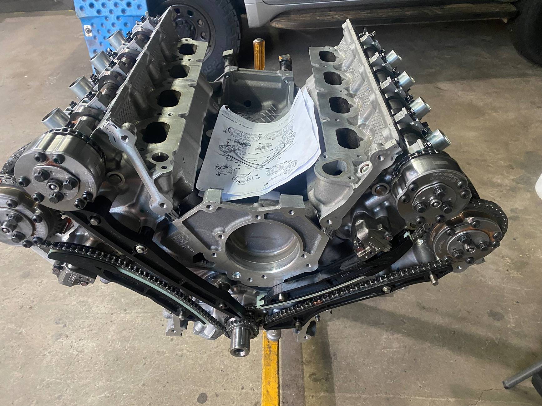

This is my built , sleeved gen2 For reference
