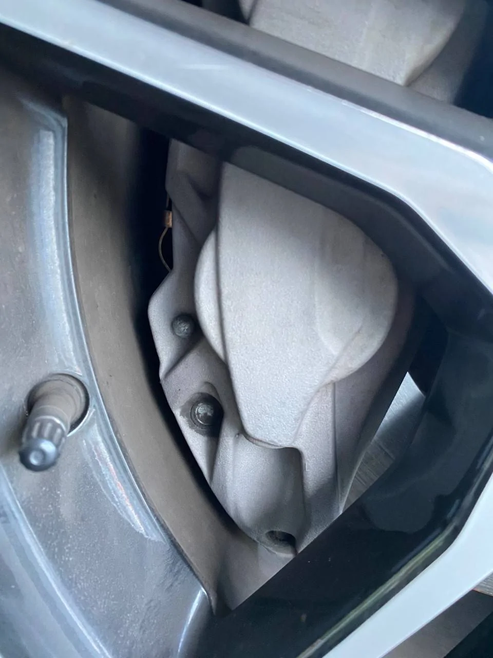

Is my caliper leaking?

Brake fluid looks good, brake feels fine.
Thank you for help!

Looks like where brake dust has maybe stuck to some of the factory grease on/in the bolts that hold the caliper?

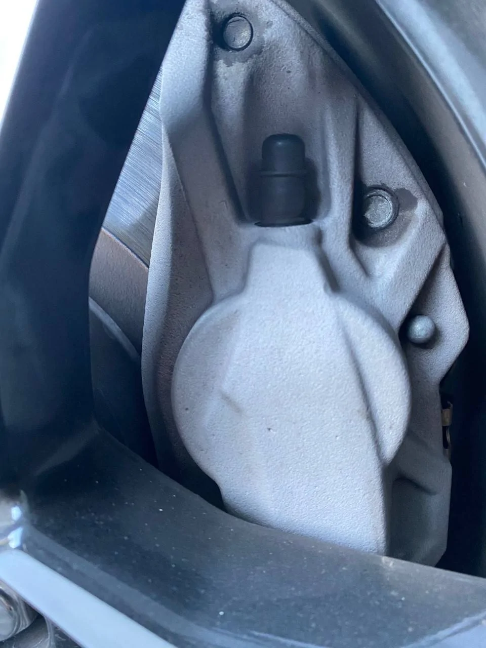

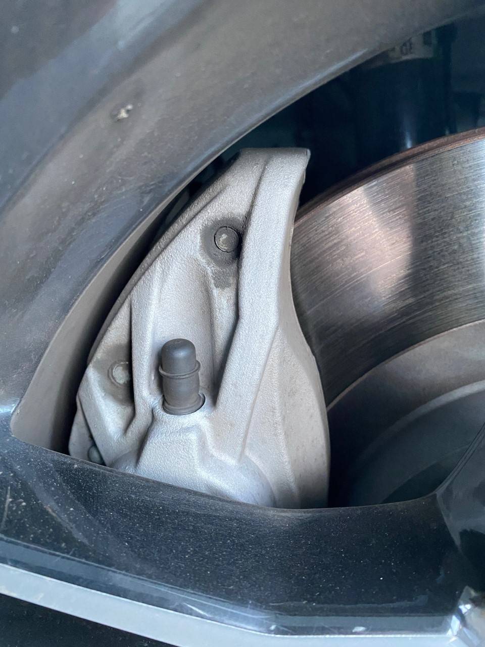

The only place it would be possible for a caliper to leak in those pictures is under the rubber cap on the bleeder screw. It's not leaking there. The rest is just a dirty wheel and caliper.
Yep, nothing to worry about. Wash it off next time you wash the car.
