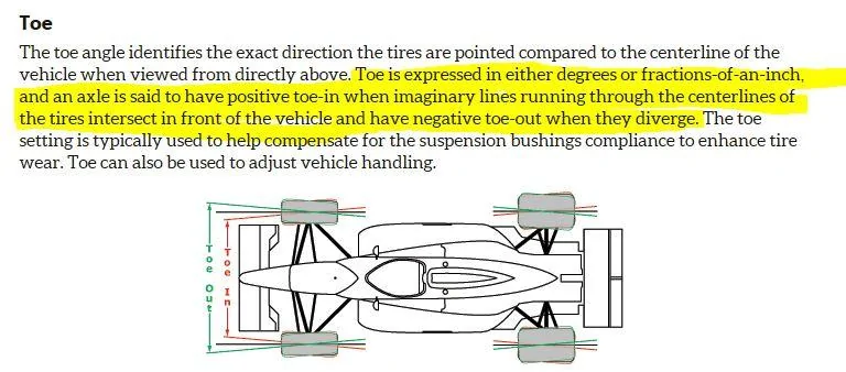

Just so we're not living in a world of alternate facts. I stand by what I posted earlier......+1 deg toe indicates a "toe in" condition.
Lol alternate facts!!! TireRack the tire pros and my alignment shop are full of shit then lol

Guess you need to square away FP and their pamphlet. They reference - as in and positive as out.

Like I said. I think this is all terminology confusion. The tirerack diagram shows toe in as lines converging in towards the car. So positive toe-in in degrees is negative??? Lol:headbonk:

Positive toe = toe-in
Negative toe = toe-out

So here is the FP settings again along with my alignment. If my alignment is correct then we are arguing differences in terminology. If my settings are incorrect and therefore FPs' settings, How so?

Will you take a look at my alignment settings and the FP spec sheet I provided and tell me what you think? Right, wrong, good, bad?

With it now clarified that FP's alignment sheet is a type-o, your car with Toe-OUT in the rear could be quite evil and unsafe to drive.
I'd probably shoot for +.25 to +.30 toe-IN at the rear.
