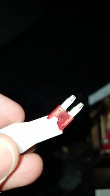

this is the fuse that needs replacing
Micro Mini 2 (Mm2) 10amp Red Fuse. Can't use low profile ones either... [MENTION=21522]Eclipsar[/MENTION]

I did the exact same thing Manders, (blew the fuse trying to replace the boot light) I believe it's an ATR fuse. I couldn't find any UK/European sellers so I've ordered some From the USA and hoping they'll arrive some point next week.
Good luck finding those:lol::lol:....I had to get mine from a ford dealer....
Then I got a friend to send a full set from the USA....... Got loads in my special drawer in the garage:D
Top tip, disconnect the boot light before removing the bulb.....if you don't, the metal prongs on in the lamp touch each other as you pull the bulb out and then short the fuse.......but you know that now :clap2::clap2:
