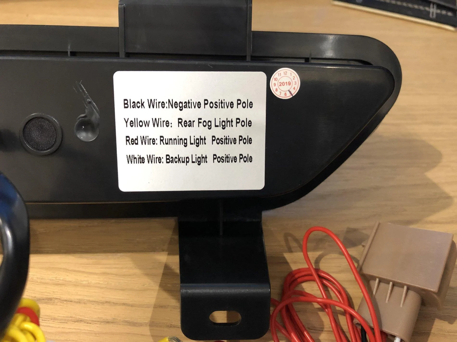

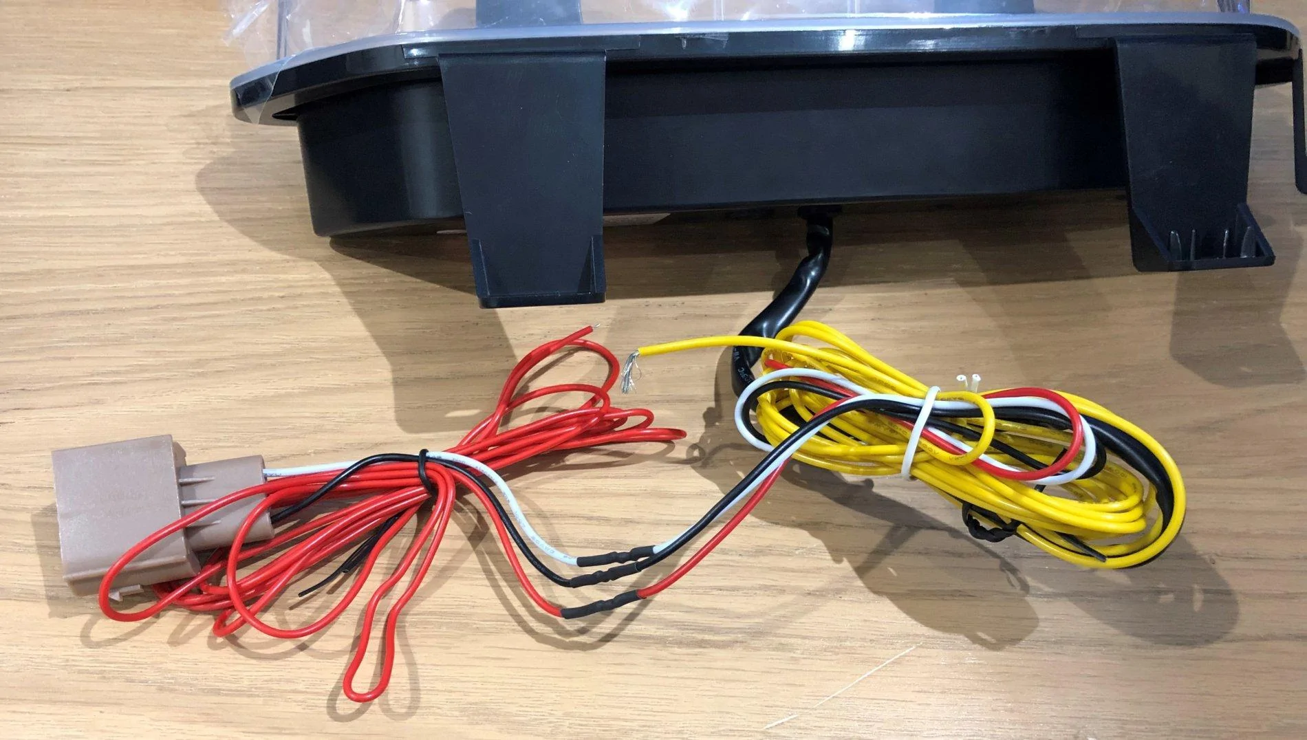

Just received this has anyone else fitted one of these, i am assuming you just plug it into the factory wiring harness and the reverse / fog-light will function, it also has three loose wires on it which i imagine are to wire it into one of your tail lights so it would then also act as a extra tail / brake light??

yes the extra wire can connect to lights for extra running light that's how I have mine fitted mainly cos I have the black covers on mine so at night its an extra light for the people that cant see lol

yeah ive got a similar one installed you dont need yellow unless you want it for side marker with your side lights on, just check which one is brighter and use that for fog they got it wrong on my cheap chinese one lol
