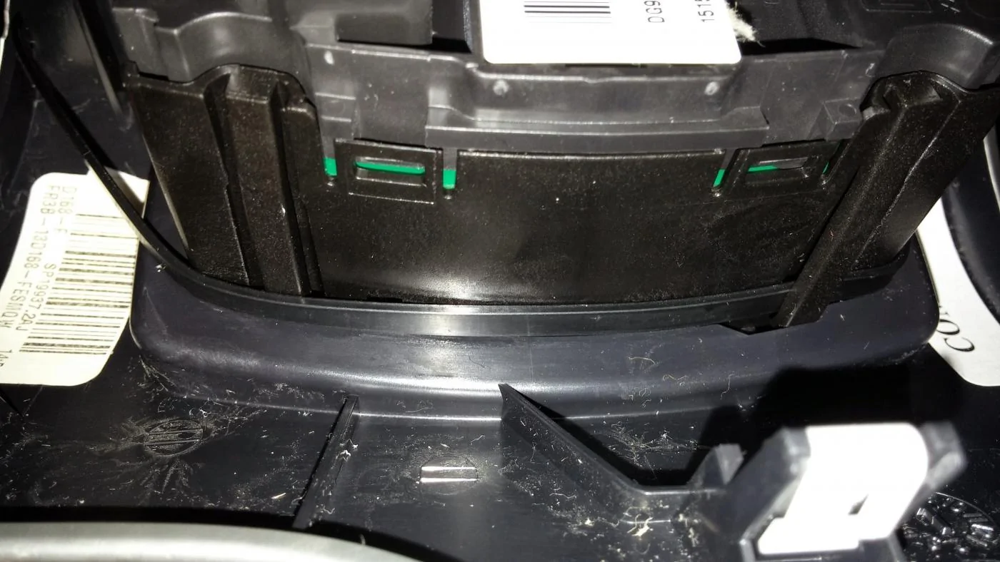

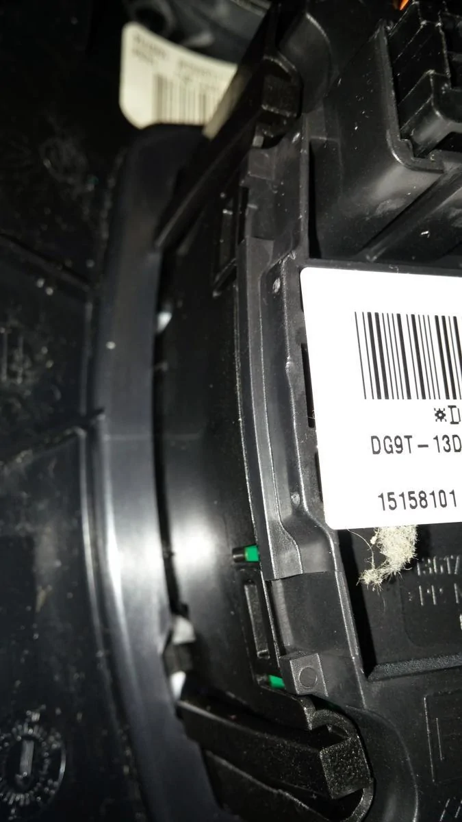

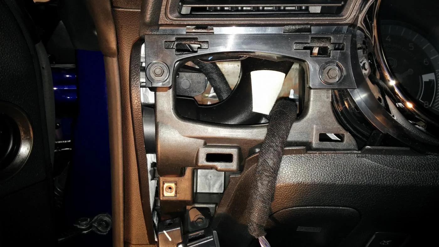

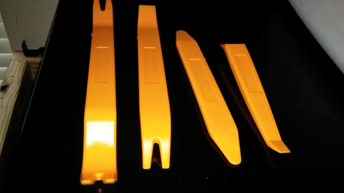

I investigated the driver side trim/light switch noise today. I bought some plastic trim tools off of Amazon for less than $10 and managed to remove it in about five minutes. I've yet to test if what I did made a difference but thought others would want some pics on how to remove the dash.
1. The bottom trim piece that runs along the door just pulls right out. I just used the plastic tool to pry on one side.
2. Under that piece is one screw. I used a 7mm nut driver to remove it. (2nd pic)
3. I also removed the side of the dash with the door vent tube but I don't know that it was really needed. It's only held in place with some plastic clips. It did allow me to grab the trim/light switch piece a little better. It took a hard tug to pop it out.
4. Inspecting the light switch I've come to the conclusion it is the only piece that could be causing it. The dash piece was really seated. It has metal clips at the top and the 7mm screw and two other plastic clips hold it tight at the bottom. The light switch does wiggle inside of the dash panel. It is only held in place by four plastic clips. Pushing in on two clips at a time and the light switch falls right out. Three of the four clips have a straight edge to catch but the fourth one (shown in pic 3) for some reason has a slight cutout to it.
5. The only thing I could think to do was try and secure the light switch from wiggling around. I stuck a small screwdriver under the one clip and was able to slide a tie wrap behind it. I could not use the screwdriver to slide it behind the other three because they were much more secured so I wrapped it around the plastic that hold the two upper metal clips in place. The switch doesn't move at all now. (pic 4)
6. Snapped everything back together. Time will tell...

With the above description on removal, I was brave enough to try to fix my squeak last night. Mine only required removing the lower piece, it popped out pretty easy, but the lowest white clip popped off the piece in the process. It had me worried for a moment that I'd broken it, but the clip was fine and went back on with no problems.
All I did was take some electrical tape, and put 2 layers over the three areas where the white cloth is. Hoping that now the clips will be more firmly holding on.
I didn't notice any squeak this morning, so I'm hoping that fixed it.

What I did seemed to improve it, but it is still occurring. I hit a rough road today and at first it squeaked for a split second two times in about a minute. A few minutes later it was almost continuous but sounded a little quieter than what it was originally. I still believe its the plastic of the light switch rubbing the metal of the dash panel.
I'm thinking of adding a layer of electrical tape to the edges of the inside dash panel and then snapping the switch back in place. Unless I don't get to it before taking it in for service.
