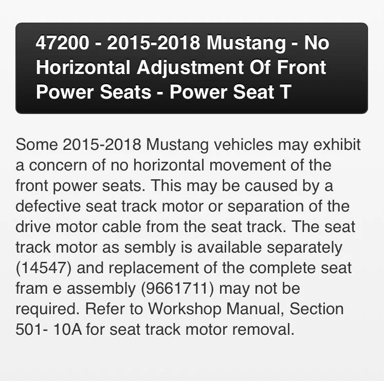

Check under the seat to make sure there are no obstructions.
It could be that the seat motor is failing - see attached Ford SSM:
