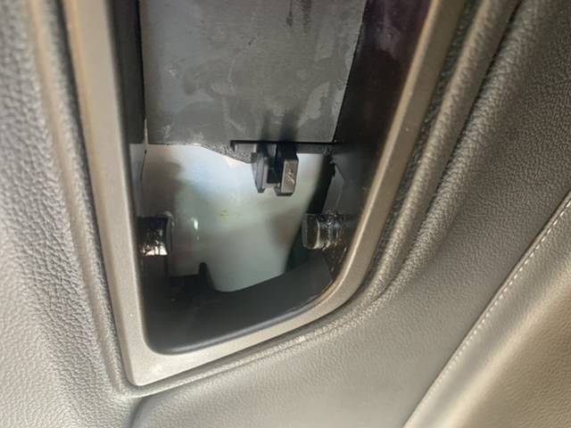

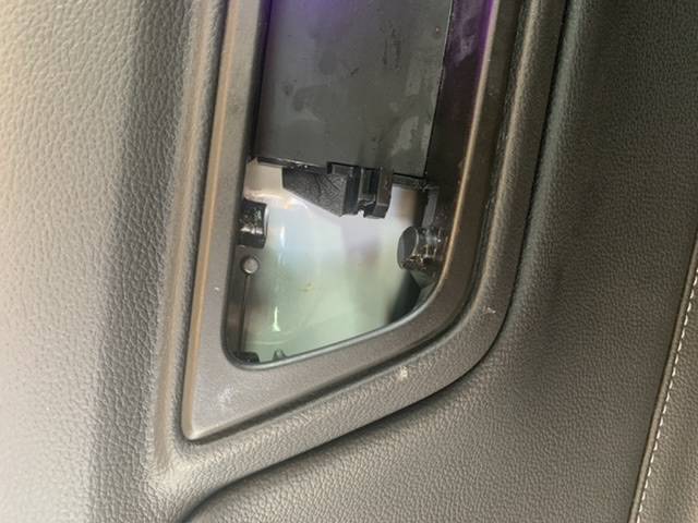

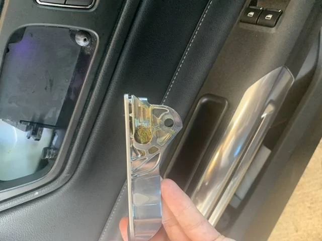

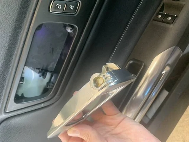

Structurally noting looks broken. I could be wrong though. Only thing I saw was the spring that came out. I was hoping I didn’t have to drop the door panel which looks like a pain. Here are some pics of it helps.

I see. Still shouldn't just come off like that. The pins look like they are worn down. Unless you can re-fit the cable, the spring, and manage to pop it back onto the pins, you're probably going to need a new handle assembly. If it happened once, it will happen again.
