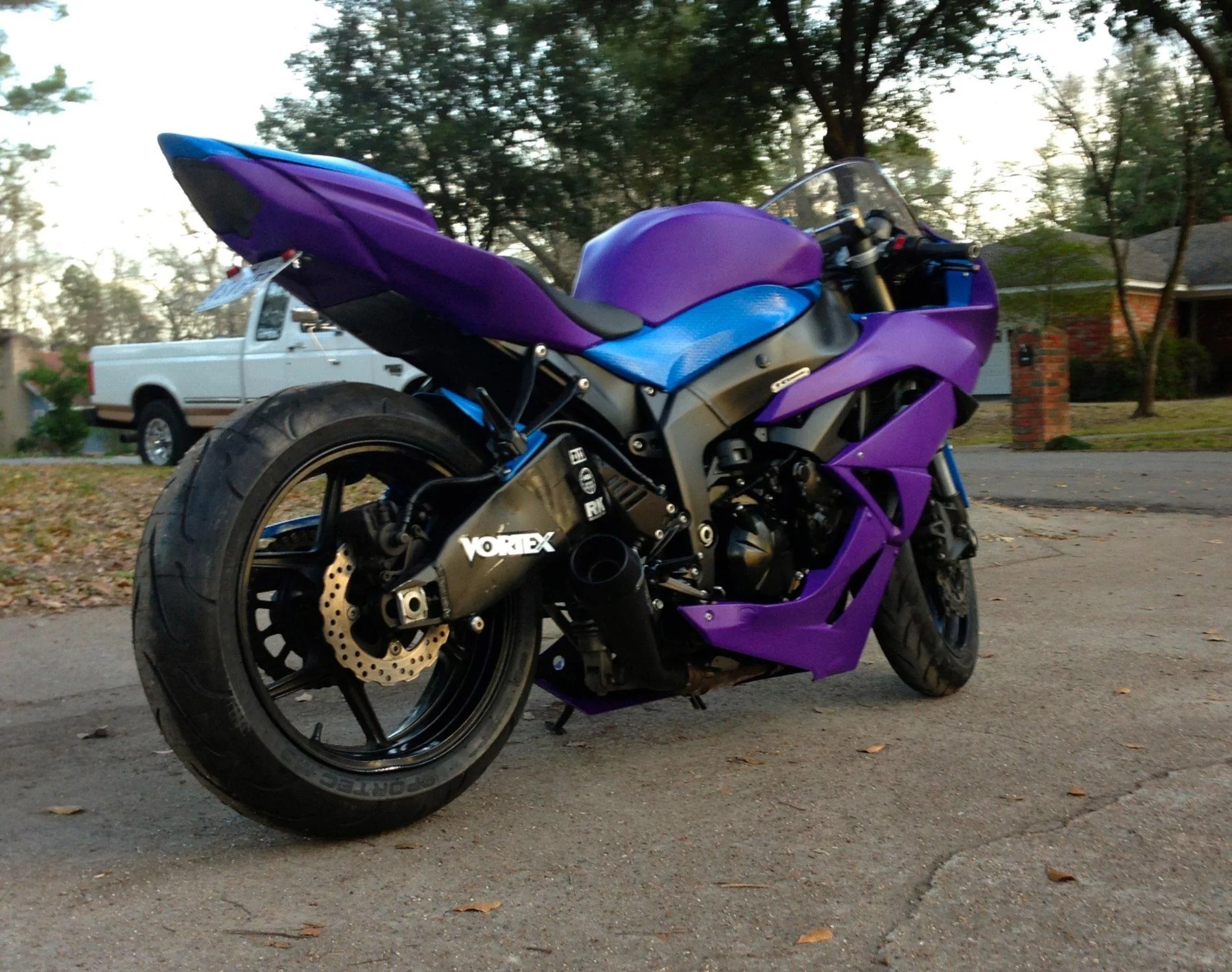

Damn that looks awesome wrapping a bike is a whole different ball game because there are so many weird angles lol but yes the dash pieces are really easy to get off less than 10 minutes it's all off just pull them in the right order. (Passenger side main pice then passenger lower. Driver lower then remove the screw below the light switch then that piece comes off) Avery does make a great product just haven't used them as much.
Wrapped a few bikes myself. The purple is Avery Film

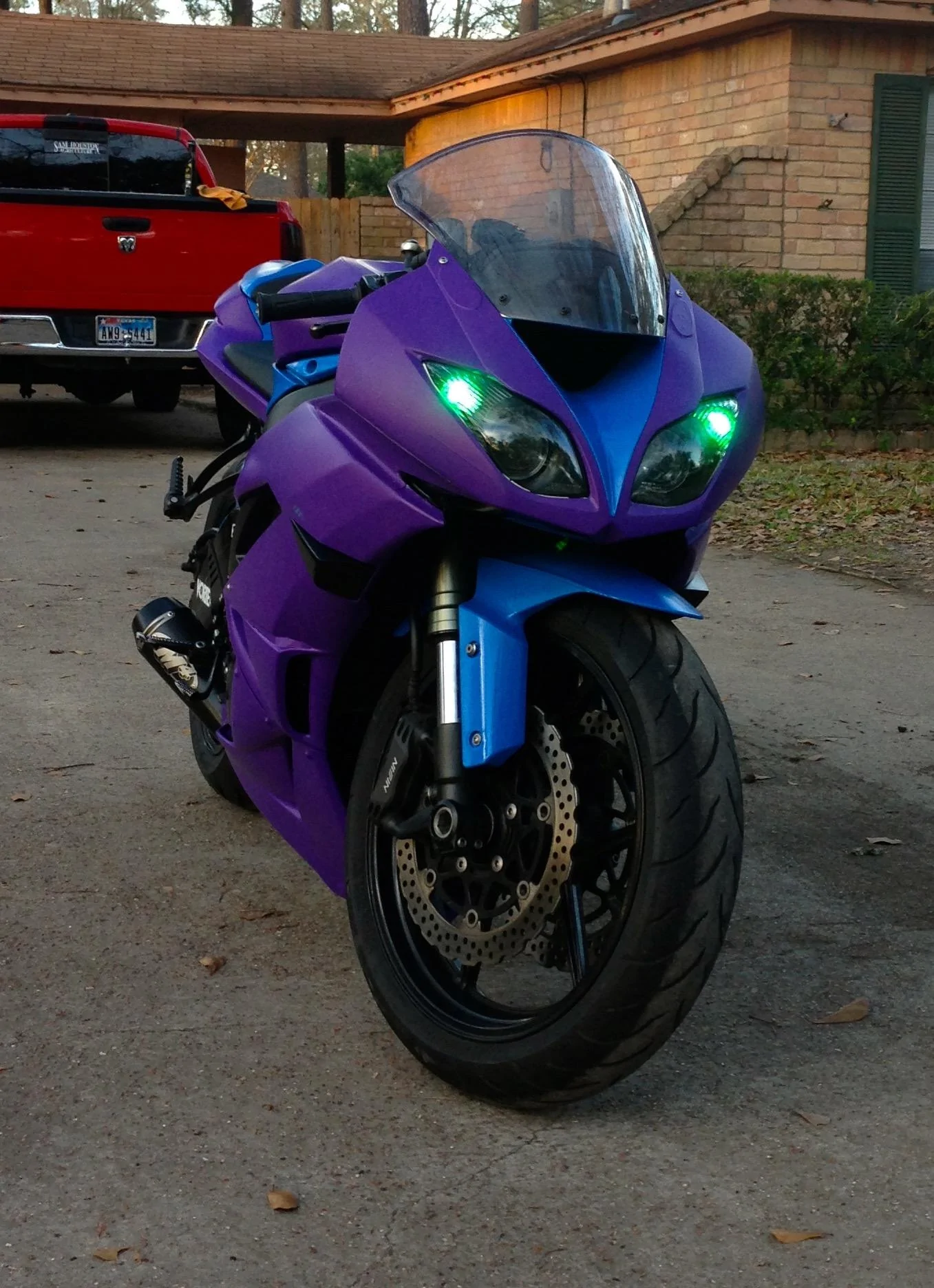

Nice bike! yeah, it takes every bit of 6-7 hours to make everything perfect. there's like 1 little wrinkle on the bike on an edge bottom I was like ef it. I didn't really want to redo the entire piece for a millimeter of defect and I didn't have much material left to risk again. People compliment it everywhere I go though. The hakunaa matata was a fun little add on. Its not a fun undertaking at all though.

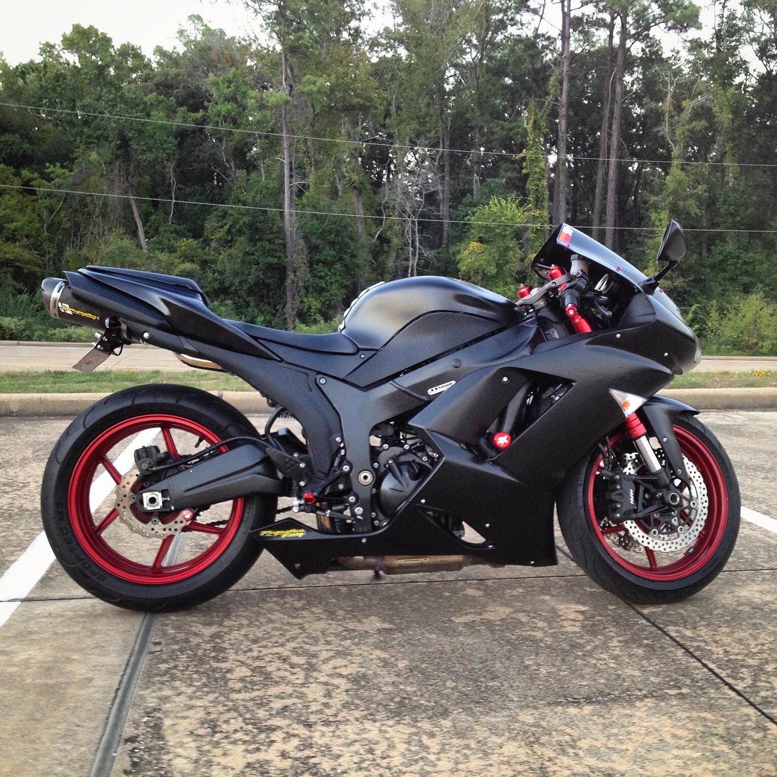

You definitely have a thing for blue lol and ya I've had plenty of those "I'm not starting over to fix that. Well on my stuff, customers stuff gets done perfectly lol. What bike is in the back right? Looks like a wide glide

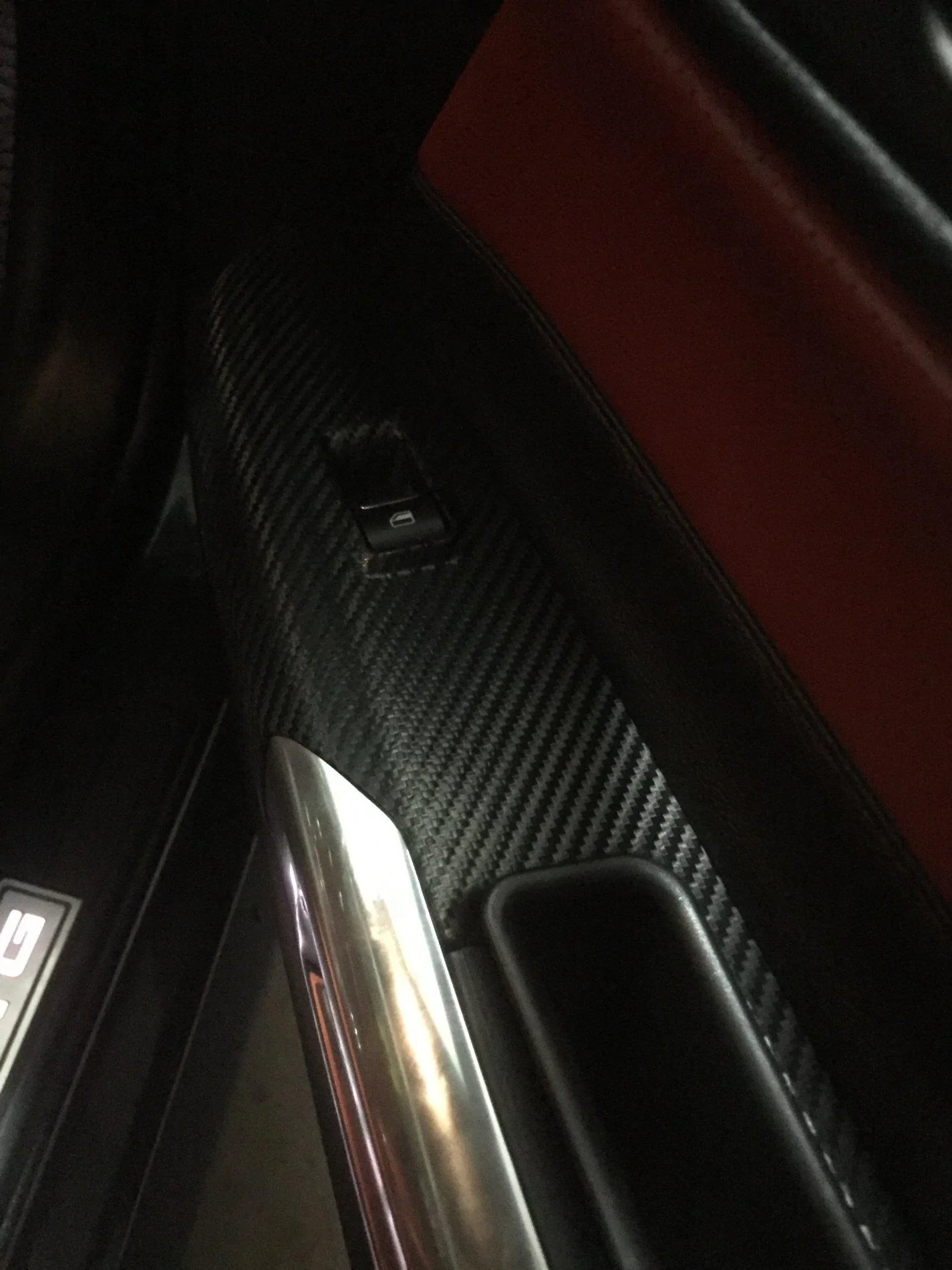

It should work I did the shifter bezel but not the whole center console. Was considering doing the kick panel at the bottom of the console. I'll have a short day at work so when I get home I'll take some scraps and see if it will stick and finish good and I'll let you know. I would say yes though because it stuck to the window switches and that had a similar texture.
