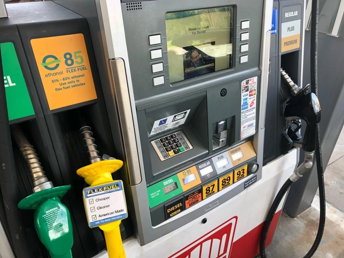

@Oxford white 10r80 gt Assuming you don't have a tune? That will make a huge difference on your car and the 18+ models really wake up with a "flex tune" if you can source E85 (really more like E50-70) pretty easily.
What do the Summer blends look like in your part of Florida. My first tank was 63%. I only have two stations at a reasonable distance.
I don't know yet! :D
We only just got E85 at a couple of local stations (Gate), and the pump card showed 53-83%, but I'm assuming that's a winter blend[?]
That is a Flex Fuel pump,, Ethanol content can run between 50-80%,
True E85 summer blend is 85%, winter blend 75%
I have a local station with "Flex Fuel" Local guys sez it runs E85 in the summer, I've checked the winter blend 3 times and it's E75. I'll be switching to it as in few weeks after it starts warming up,
You can get the Holley ethanol tester 36-e85qft off feebay for $19
So are you saying Flex Fuel is _always_ in [roughly] that range? And that it doesn't deviate, winter vs. summer?
You are correct, it was specifically labeled as FF :)

Is E85 ever sold in anything but Flex?
I found a PDF that indicates the winter blend below the 29th parallel (basically central Florida) is 80% for November through February with the transition back to 85 in February. Only Hawaii has 85 all year.
I have a Racetrack, Sunoco and U-Gas to pick from. Looks like I'm going to be getting some Techron additives if I don't use the Sunoco. http://www.intercepteft.com/online/geographic_ethanol_fuel_blend_guide.pdf
AZ doesn't have real e85 we only have flex fuel which usually comes in around e54.
