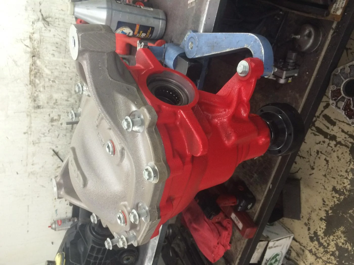

I wanted to update the thread as the 3:31 is now installed. I did not need to adjust the speedo as a GPS app confirmed everything was accurate within 1 MPH.

I like the set-up just fine. My reason for the swap was due to going FI and not being able to hook up, having to shift into 4th in the 1/8 or 5th in the 1/4. Those issues have been resolved (for the most part). I just swapped out the lowering springs I had and installed drag springs to make the chassis work better (hopefully....will find out this weekend). At any rate, the gear swap accomplished exactly what I wanted and have no regrets. As for MPG, I don't really pay attention to that as it's not my DD. Smiles per gallon have definitely improved :)

The gear cost me 189. I paid the tech I know 150 to swap out the ring and pinion. I think I've read a shop would typically charge 2 hours if you took the pumpkin to them. I have another 100 or so invested as I added the BMR differential lockout bushings and upgraded bolts.
