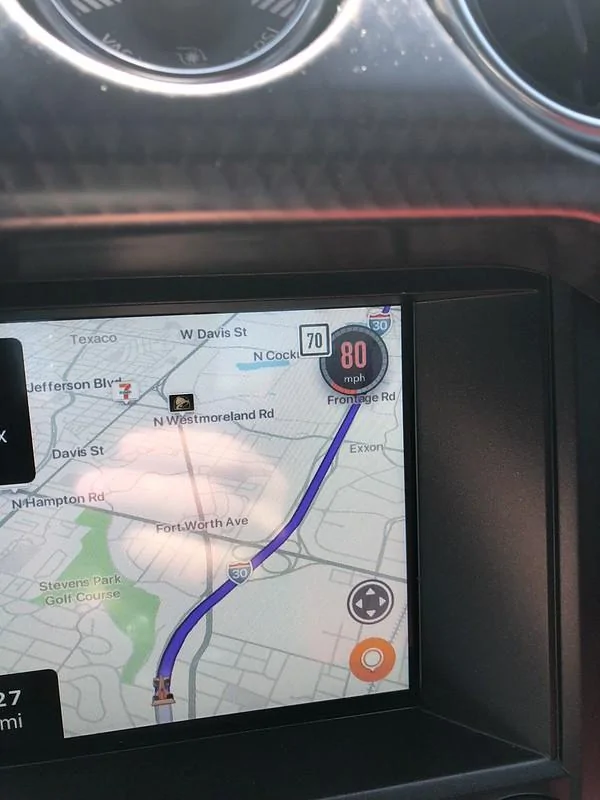

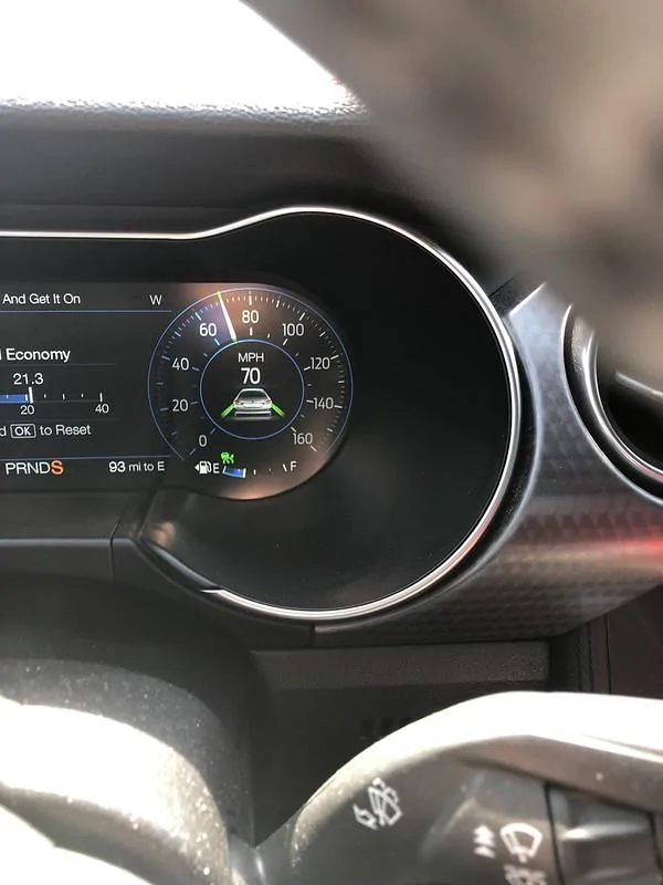

So a few weeks ago, I noticed that the speed shown on the Waze app was way high compared to my speedometer - it had been spot on until I noticed the error, but has been a little over 14% high ever since. Running Waze in any other vehicle shows the speed to be spot on again, so it seems to be either a Sync 3 thing or a CarPlay thing.
IMG_2354 by clair_davis, on Flickr
IMG_2352 by clair_davis, on Flickr
In the photos (professional driver, closed course, etc.), I have the cruise set @ 70, but Waze says 80. I just updated Sync 3 to the latest version for 2018+nav, but nothing changed with regard to the error.

Confirmed on the drive in that Waze reports correctly on its own... hopefully the new update will be out here soon.
