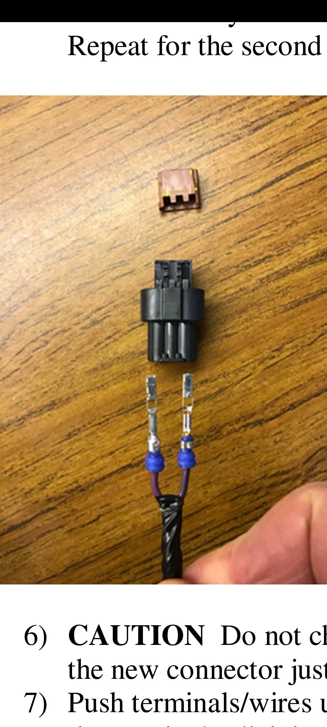

My pins are slightly different similar in size but don't have the space between the wire and pin I'll take a picture of mine tomorrow or Wednesday
That is a different kit with the C. Part M-1202-M50C shows as standard OEM coils for 2011-2/23/2016 https://www.levittownfordparts.com/sku/m-12029-m50c.html. It also stated for vehicles or harnesses built after 2/23/2016, see part M-1202-M50E which are standard OEM coils https://www.levittownfordparts.com/sku/m-12029-m50e.html. The instructions are for M-12029-M52 which are the OEM coil packs for 5.2 Predator; https://www.levittownfordparts.com/sku/m-12029-m52.html. The ones for 5.2 Predator can be installed in vehicle after 2/23/2016 through 2017 models harness by swapping out the red to green clips for sure as that is what I had to do.
