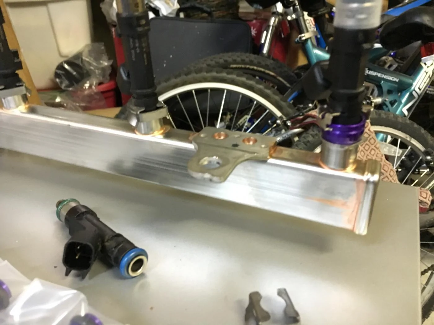

Installing my fuel injectors now and I have a question. The stock injectors have a clip on the fuel injector to secure it to the rail. With the purple spacer there is no way to reuse the clip to secure the injector to the rail. Is the clip needed or do I just I un-clip and pull the stock injector out and plug the new one in? Picture attached so you can see what I am talking about.

The injector does not need the clip to stay in the rail. The bolt that goes through that tab in the picture secures the injector into the hole.
