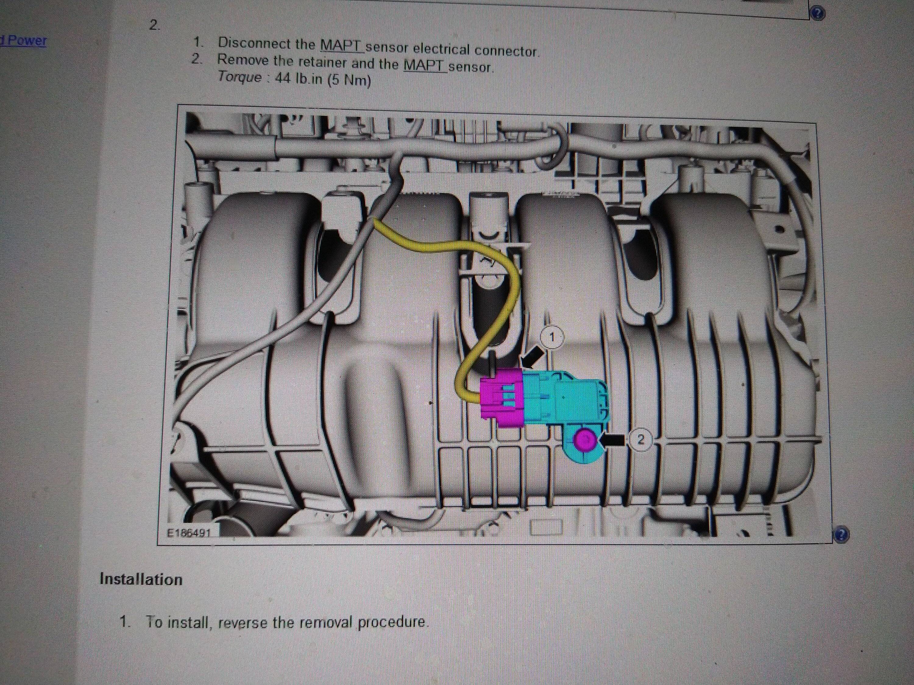

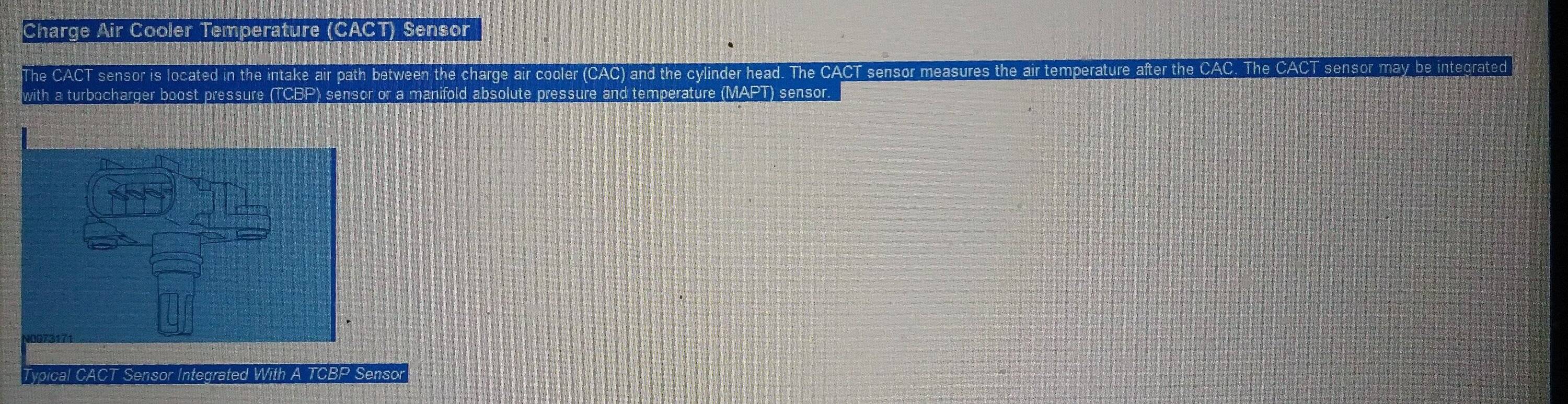

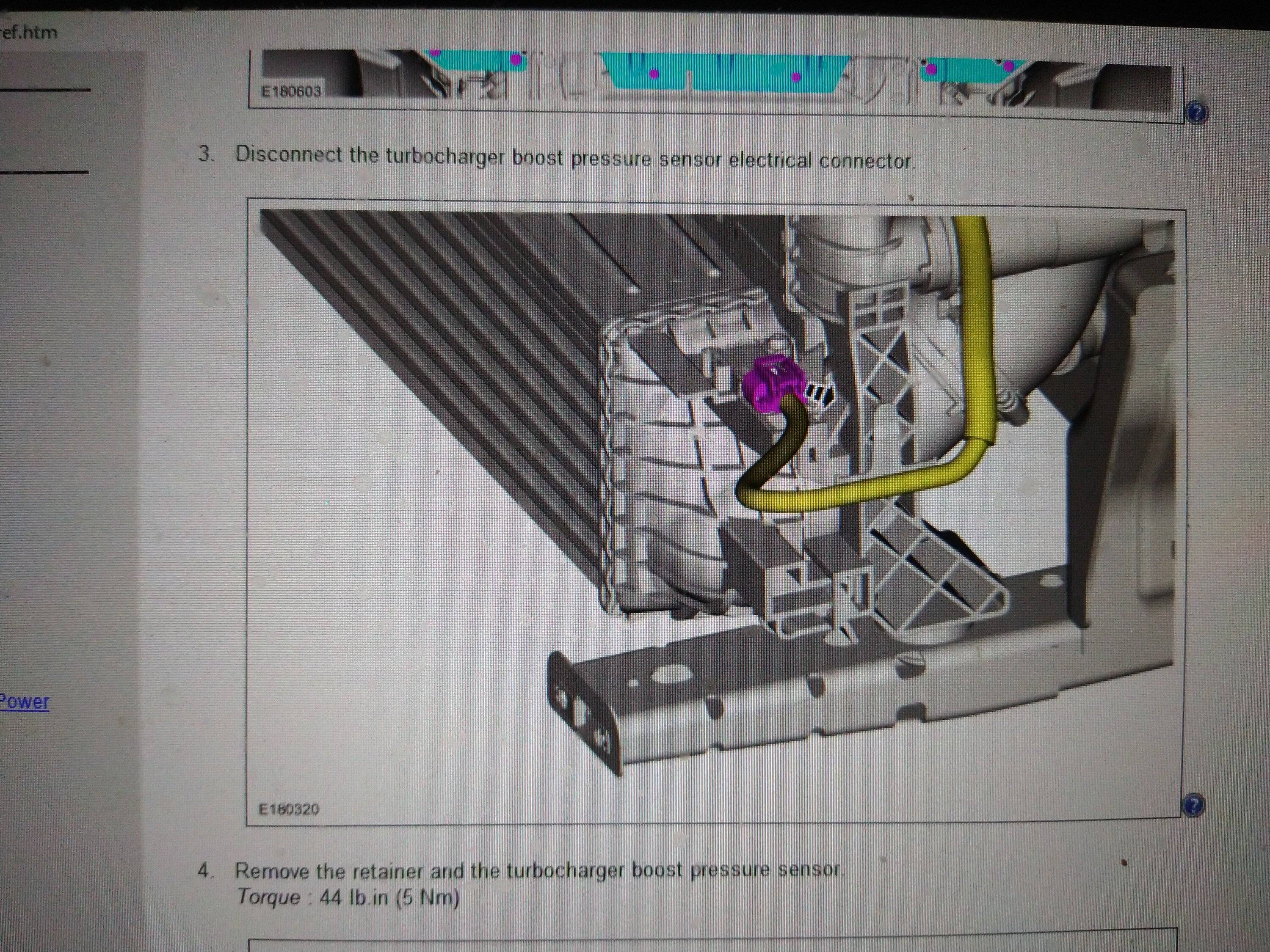

Here's a few pictures from a Ford manual.

I believe (could be wrong) that IAT1 is in the airbox and IAT2 is integrated into the pressure sensor on the intercooler.

IAT1 sensor ( temperature only) is located in the airbox outlet between the filter and the intake tube going to the turbo inlet, IAT2 ( MAPT sensor-manifold absolute pressure and temperature) is in top center of intake manifold per coyotes post above and measures both manifold vacuum and pressure when under boost as well as temp of air in intake before going into the cylinders.
The MAP sensor in the outlet side (drivers) of the IC only measures vacuum/boost pressure out of the turbo/IC not temperature.
