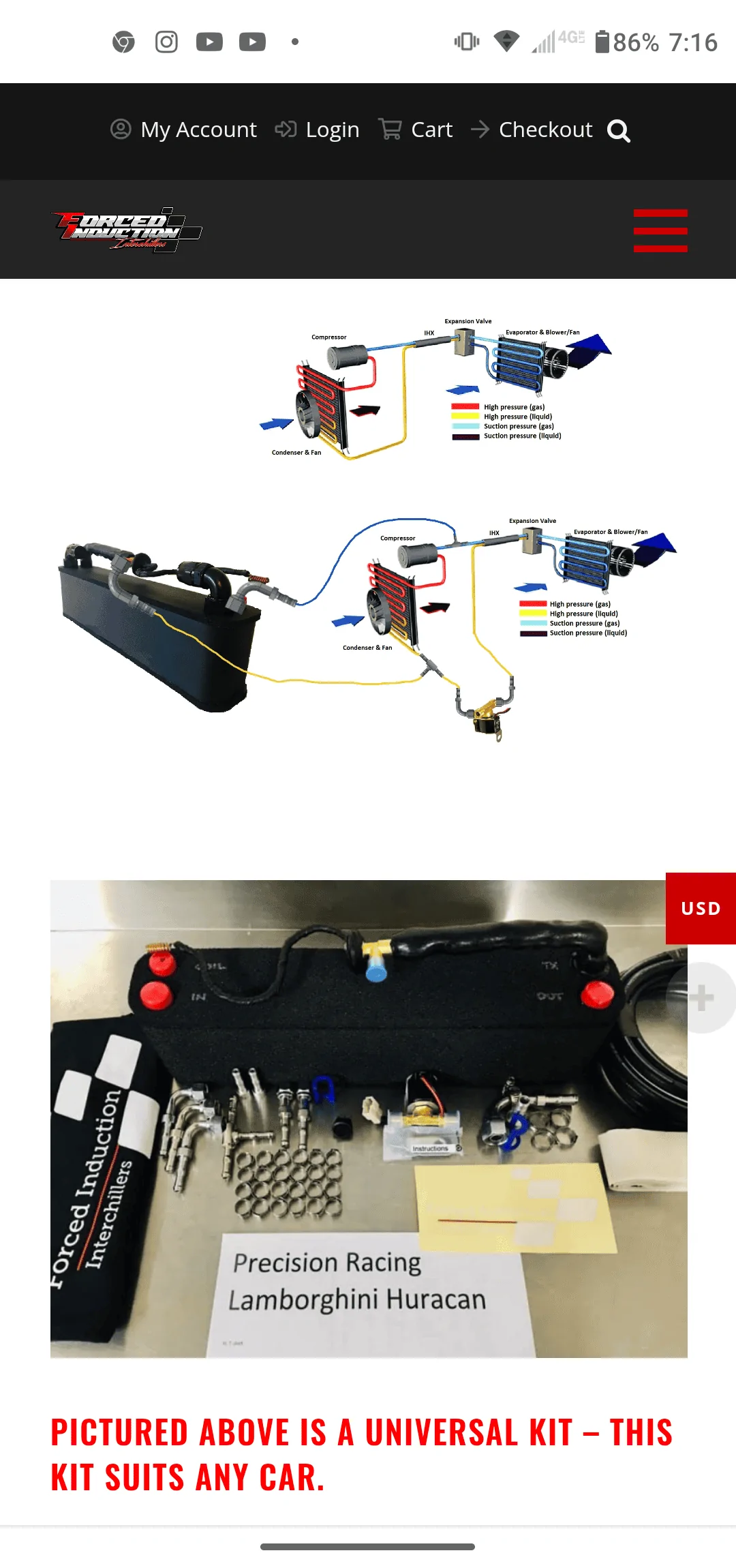

Not Impossible!
I've been wondering if this is a trick question?
Is the car equipped with an "Interchiller", not an intercooler, an Interchiller.
Forced Induction of Australia, builds an Interchiller, which uses your cars a/c system, to deliver below ambient temperatures.

I'm thinking of doing something similar, but instead of transferring the heat from air to water, water to refrigerate and refrigerate to air, my plan is to wrap my cold side charge pipe with 3/8" refrigerate tubing (starting at the top, near the thottle body and stopping at the bottom, near the outlet of the air to air Intercooler) and using 1/4" refrigerate tubing (from the high side of the OEM a/c) as a metering device (and returning the heat soaked refrigerate to the OEM a/c low side).
