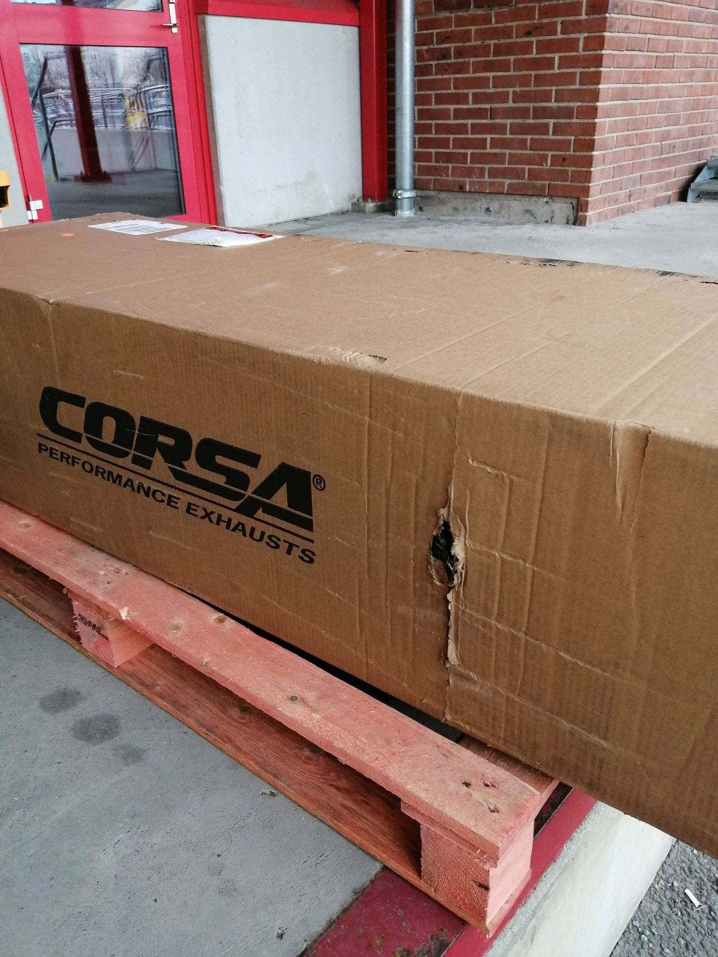

Not sure about this since I installed the catback some months ago and threw away the box, I have a picture of the box however since it came a little damaged, it only says "Corsa performance exhausts" on the side basically
