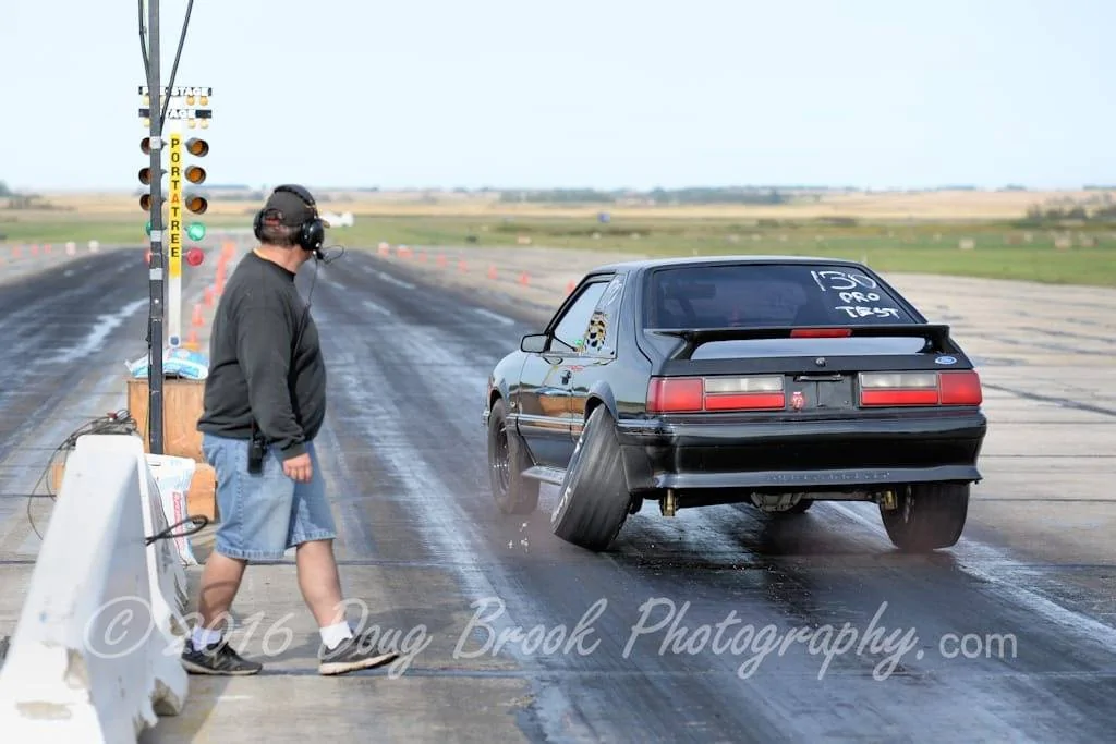

Blow the picture up, focus on the driver side rear wheel, yes it was hub centric but he lost the tire anyway....no real damage and he has gone to larger ARP studs
