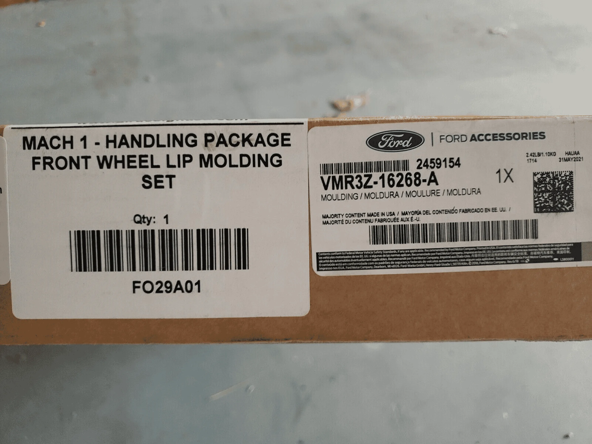

I have been searching but hard to find. I am looking for the part numbers for the HP splash guards, Front splitter, Fender trim and spoiler. Thanks in advance

Front wheel lips or rear splash guards?
