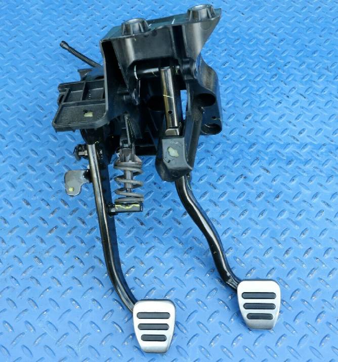

My brake pedal is squeaking. I had sprayed Silicon spray and it did not help much to deaden the sound. I have White Grease spray can I can use, but the question is precisely where to spray to get rid of the squeaks... Thanks in advance for all the assistance.

Anything that pivots or rubs. You've reminded me, my clutch pedal squeaks ever so slightly too. Going to get after it with some lithium spray...

The pedal box is a weak point. Check the brake pedal assembly itself because it's a known fact that the welds on the clutch pedal can be bad (and separate, causing squeaks/creaks).
Some M6G Members have experienced an actual cracked or broken weld at the clutch pedal assembly, which causes clutch issues. Check these (2) threads:
