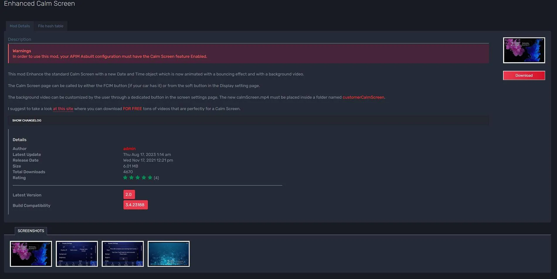

The calm screen, by default, is basically just a display option that shows a large digital clock and nothing else on the screen. It doesn't interfere with the audio playing in the background. On the F-Mods website, they host a couple different mods for the calm screen.

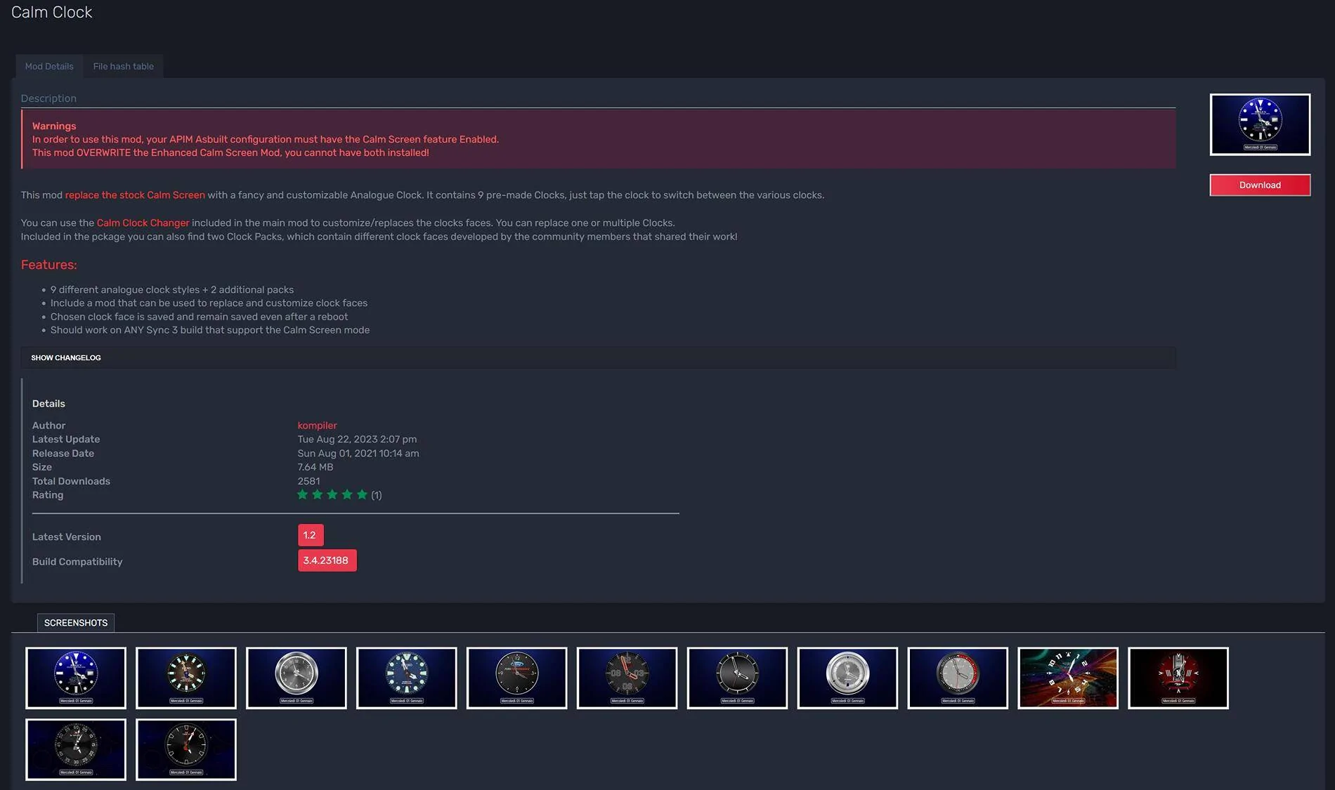

One is called Calm Clock which displays an analog watch face with the current time. That one comes with several different watch face options (Rolex, Ford Performance, etc). I haven't tried running this mod yet.
The other one, that I'm running, is called Enhanced Calm Screen. The mod allows you to play a repeating video with a clock on the screen. The mod maker suggests downloading a free video from this site https://pixabay.com/videos/search/abstract/. Of course, you could upload your own video too. I downloaded about twenty videos from that website and decided on one to use first.
The only problem is, the date is incorrect and I can't figure out a way to edit it. I'm pretty sure that I can fix it via GPS. My GPS antenna recently failed, so I ordered a replacement. Once that comes in, hopefully, my date error issue will be resolved. Not being able to edit the date without GPS is irritating though.
