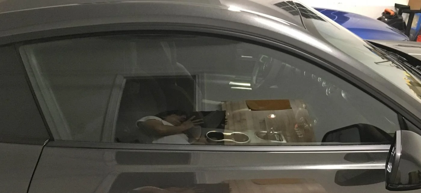

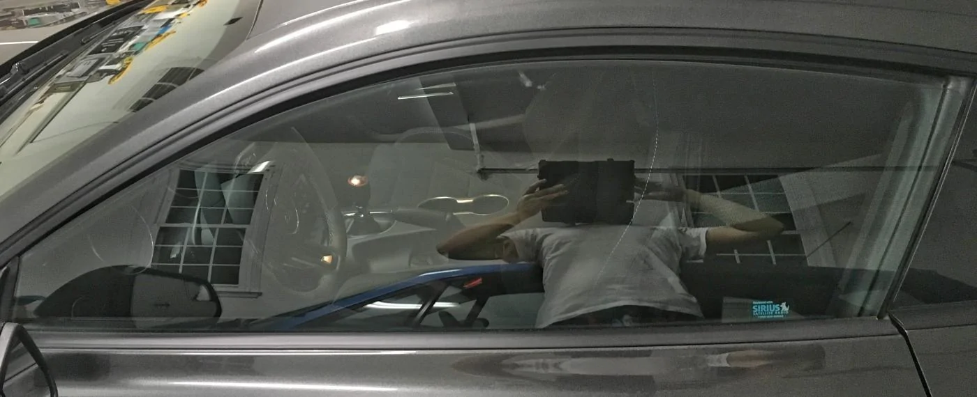

I tried first the procedure you described and nothing improved. Then I started looking a bit at the way the glass looks relative to the body and door, driver and passenger side.
The pictures included show the windows before the final 1/8" step up. You will see that the driver door glass is actually misaligned relative to the door and upper rubber seal. It definitely looks like the rear of the glass is lower than it should (especially when compared to the passenger side which looks good).
Is there a way to lift the rear of the glass only? Basically is there a way to mess with the window tracks/rails inside the door?

Passenger side picture

Driver side (where the problem is)

compared to my door yours still look miss aligned the trim on mine is even,yours looks lower than the fender.maybe its not the glass?just my 2 cents.

As much as I hate taking the door panels off of these, I think that is necessary. If it's under warranty have someone that is good at this do it(someone that cares). Looks from your photos to be out of alignment.

+1. Both your doors look a bit low.

+1... doors need to be lifted straight vertically by about shy of 1/4".

Doors are fine actually. They are just not closed completely so I can show you the gap at the top of the glass (before it raises by about 1/8"). Basically it is an optical illusion since they are not flush with the body. I can take some pics with them completely closed and you can see. The pint I was trying to make is the difference between driver and passenger. I would like my driver side look the same as the passenger.
