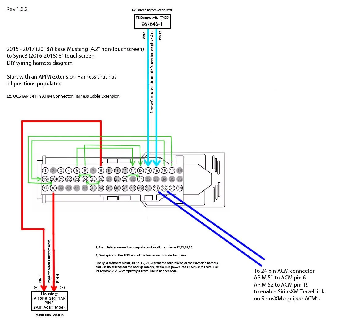

A list of all the things I need to change in a simple post was surprisingly hard to find.Okay, here is what you need to change for a Sync 3 upgrade from base, including some optional stuff.
This is assuming you are keeping the Base ACM.

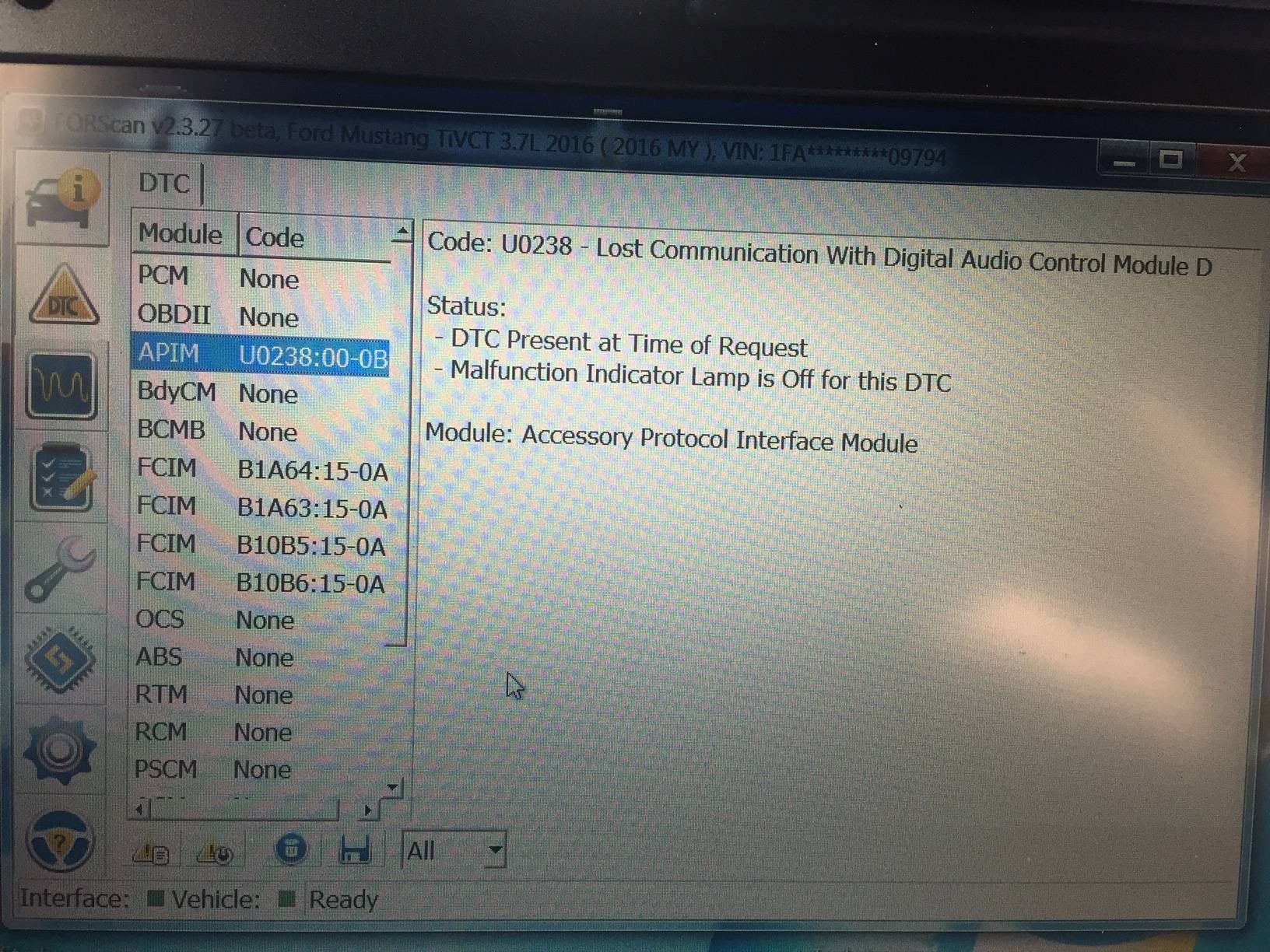

Refer to this - https://www.mustang6g.com/forums/th...-sync-3-to-base-model-s550.31286/post-1811217I did the swap this weekend. Everything works great!

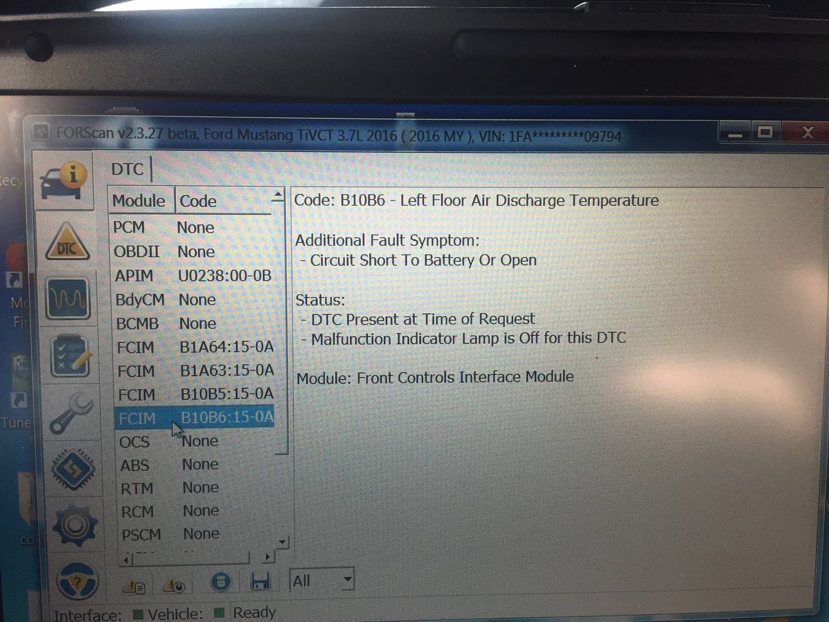

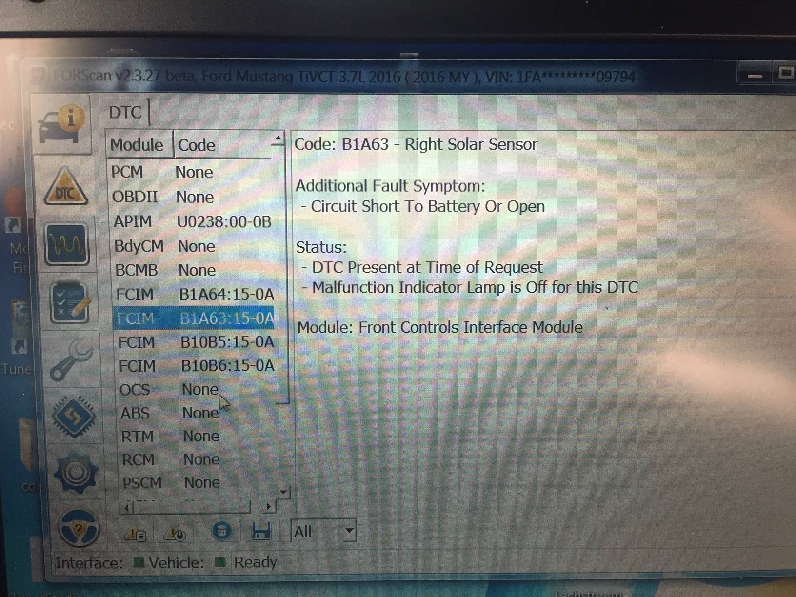

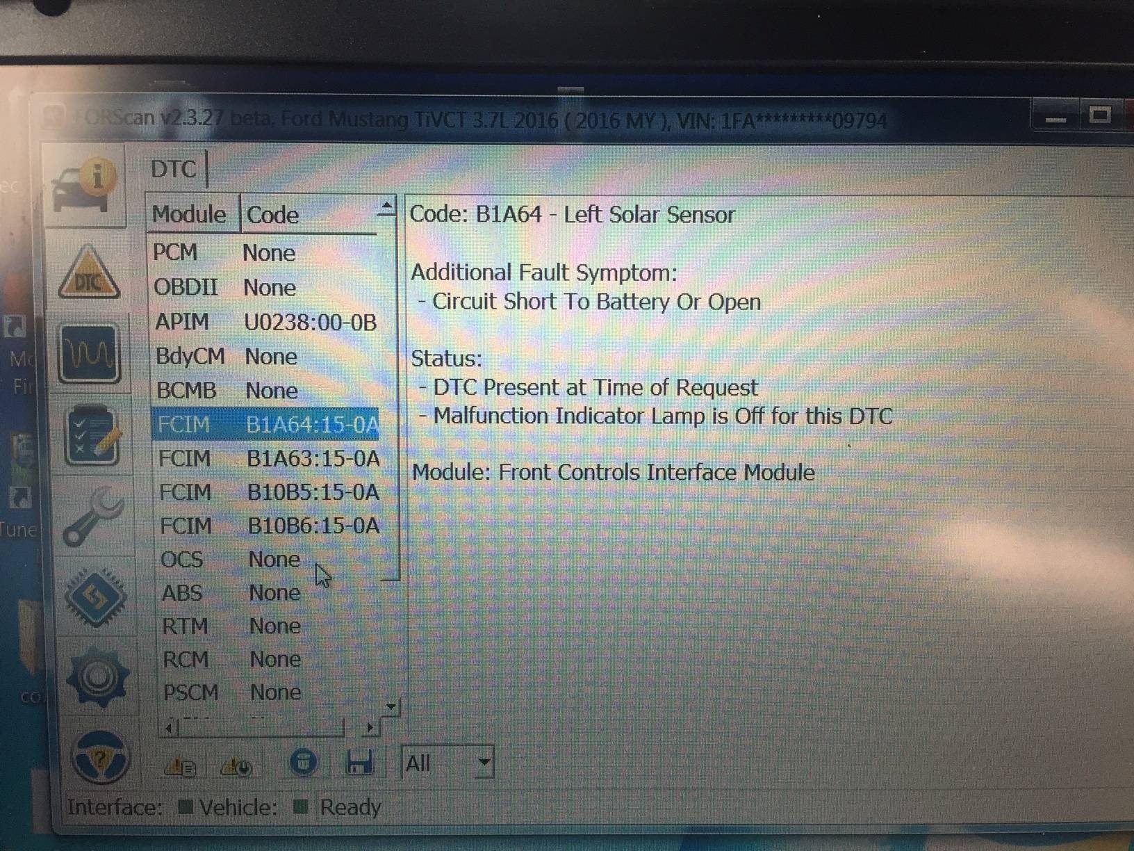

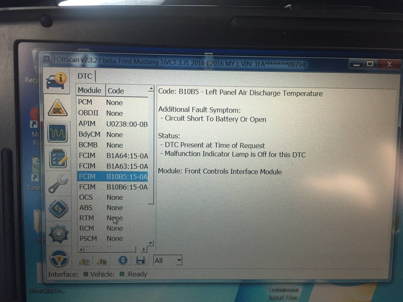

The only issue I have are some non-critical DST's related to left discharge temps, solar sensors & digital audio control module D.
Are there any code changes I can make to remove these?
Thanks!
