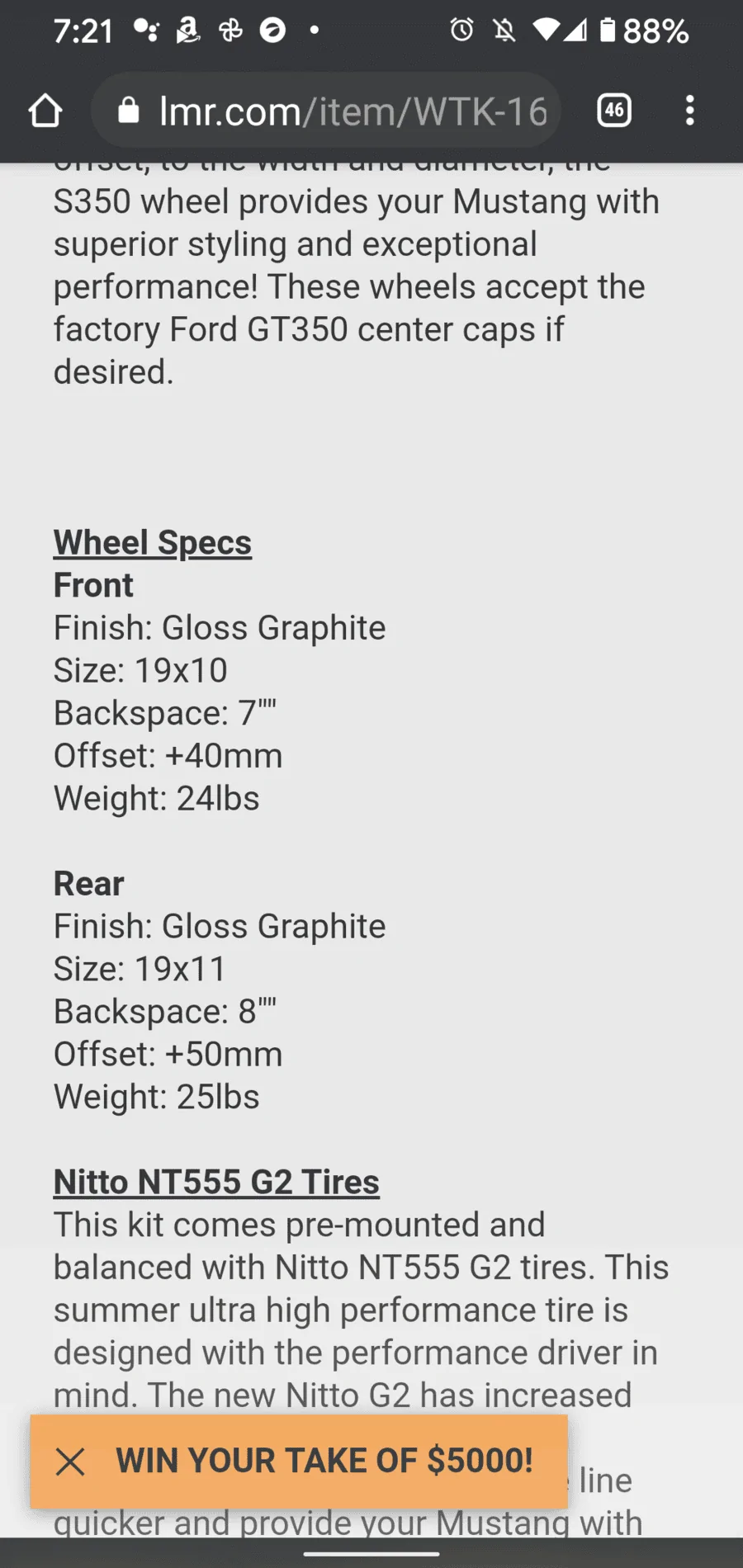

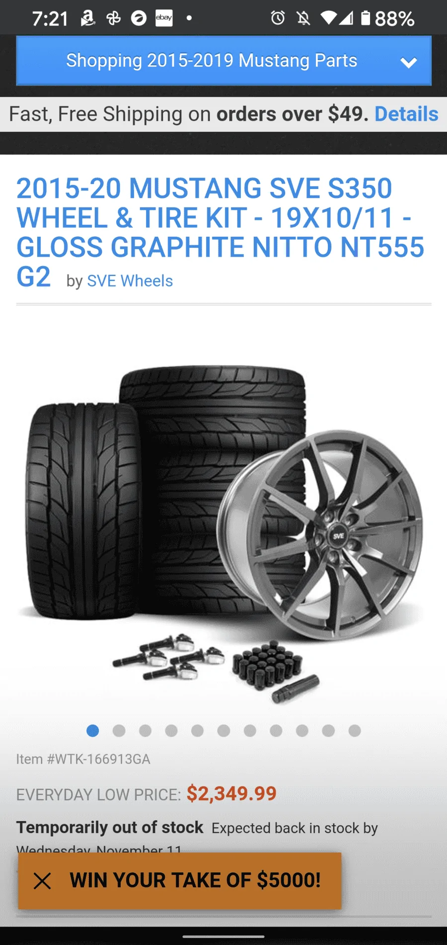

Hi guys. I have this wheel and tire setup. How much wheel spacer should I/could I run? Car is sitting at stock height but will get lowered soon (no more than 1.2 front 1.0 rear).
Thanks!

Those wheels are correctly setup to run w/o spacers. At most a +5mm spacer on the front only.

Right, none to maybe 3-6mm up front.
Tire size is 275/35 & 305/35? You shouldn't NEED spacers with 275's.

I have the LMR SVE X500 that are 19X10 ET35 and 19X11 ET50. The front could even use a 5mm spacer. I think a 19X10 ET30 would be perfect.
