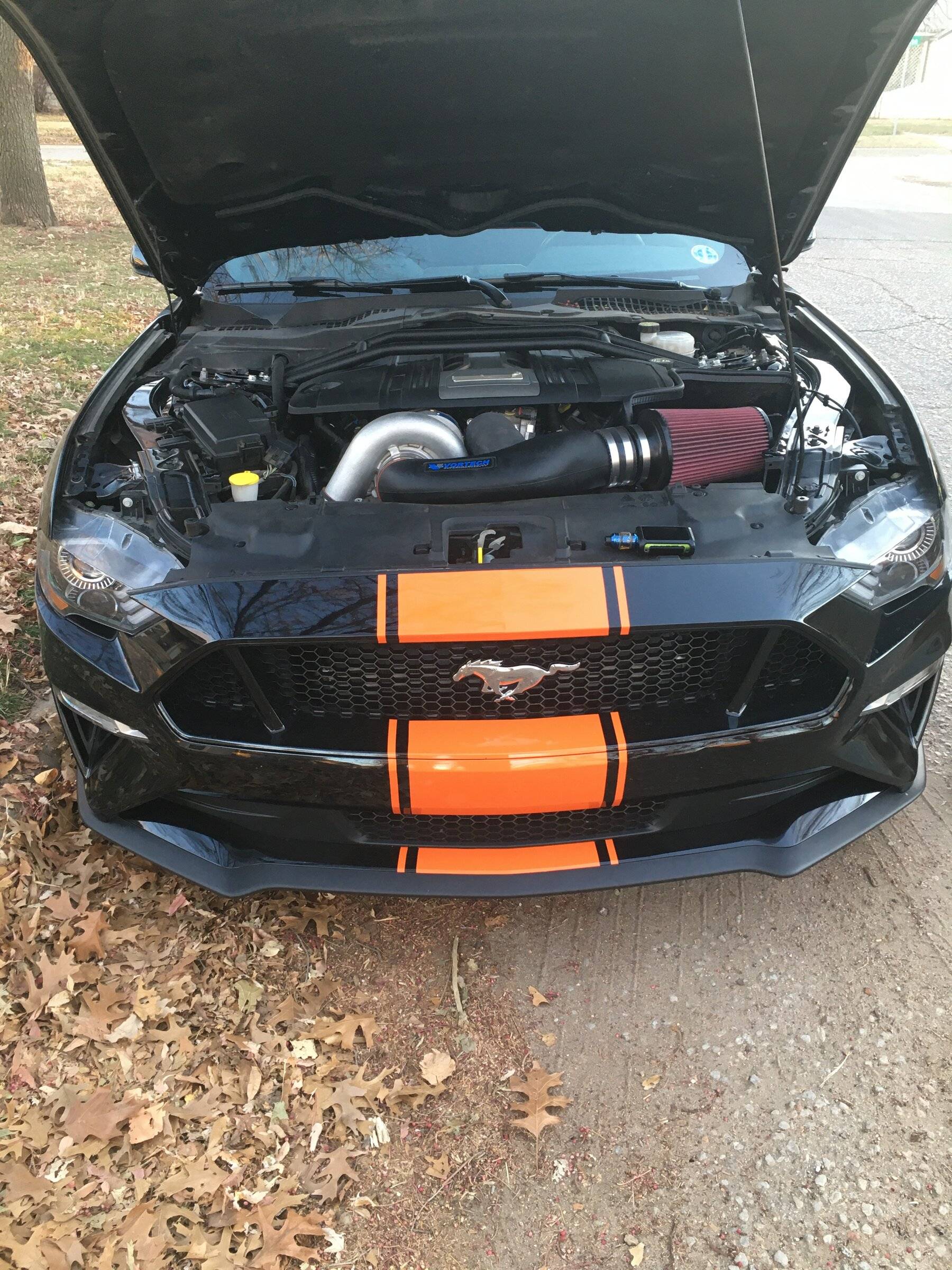

I have a 19 gt and had a vortech si jt installed. I’m making 659 rwhp, I’m planning on getting a fore fuel system in the future so I can hit my goal of 900 rwhp. I know I can get a lot more then 900 but that’s all I really want. I don’t want a track only car. The main issue I’m having right now is wheel hop. It wasn’t bad before the sc but now it’s very noticeable and it’s very annoying. Does anyone know what I need to get to stop it? I don’t want to get a whole suspension kit. Just something to stop the hop.

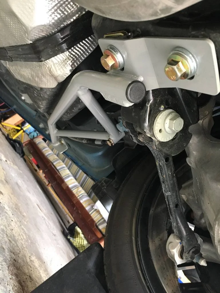

Congrats! Car looks like a beast. I did ONLY steeda rear braces, very cost effective and took an hour to install and it took care of 90% of the hop. For me, no sense in spending way more for a limited extra gain. Absolutely no added NVH.
@TJ - well designed kit, appreciate you all.
