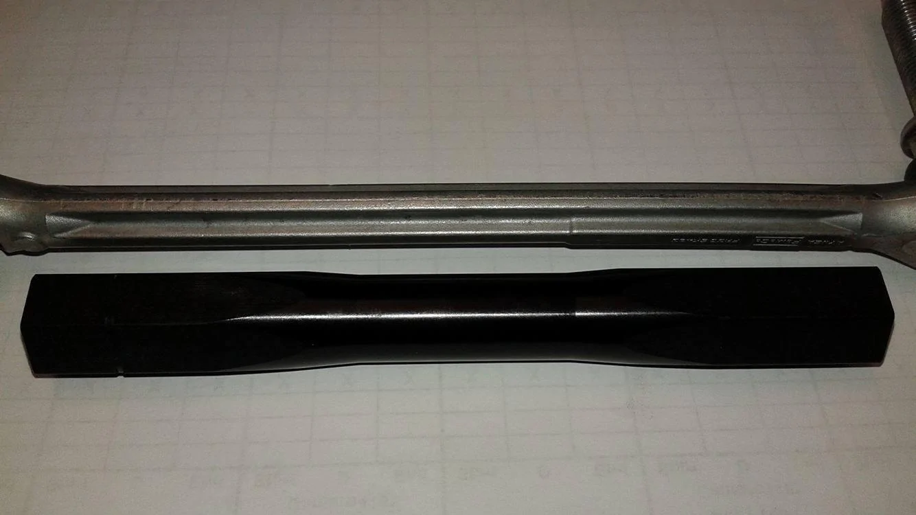

To touch on some of the things mentioned in this thread.
"Their's aren't tapered so they're stronger"
Why not mention our rear links are high strength steel, and not Aluminum?
Let's not kid ourselves, you won't see that become an issue with the durability of our front links.. We did the taper to make them look different. We knew everyone would make a them a full hex design, so that is just "form AND function" that comes naturally to us.
"Flanged nuts won't sink into holes like the washers will"
We came down to two options for the fasteners. Option 1 was a flanged nyloc nut...Option 2 was a zinc washer with a steel loc nut.
Like anything, if someone points out a flaw with ours, I can point out a flaw with theirs. This is seriously splitting hairs.
Since we are splitting atoms at this point - our separate washer design will not rub the coating off of the bar and lead to rusting of the bar end. OH and hey, our steel-locking nuts are more durable than a Nyloc! LOL. I am not being serious, but this is the kind of stuff I see online. ;)
Seriously - we ship thousands of links for various makes and models each year and I have never received feedback about this happening, nor have we seen a reason in our testing to warrant changing to a flanged fastener (nut)
I have attached some photos that show how much beefier even our "weaker" round tapered center is in comparison to the OEM end link. The OEM endlink I just pulled off my PP GT car with all stock springs and bars that is bent....:cheers:
