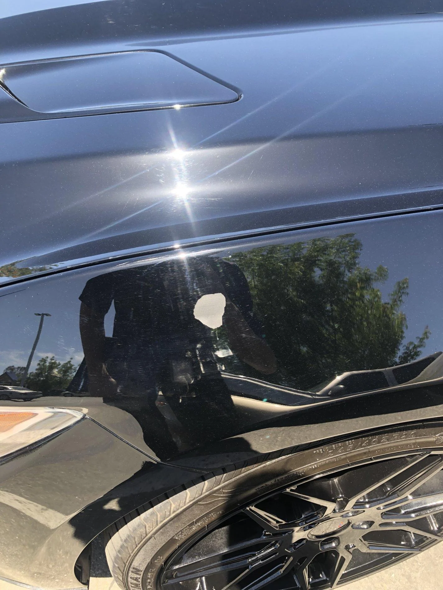

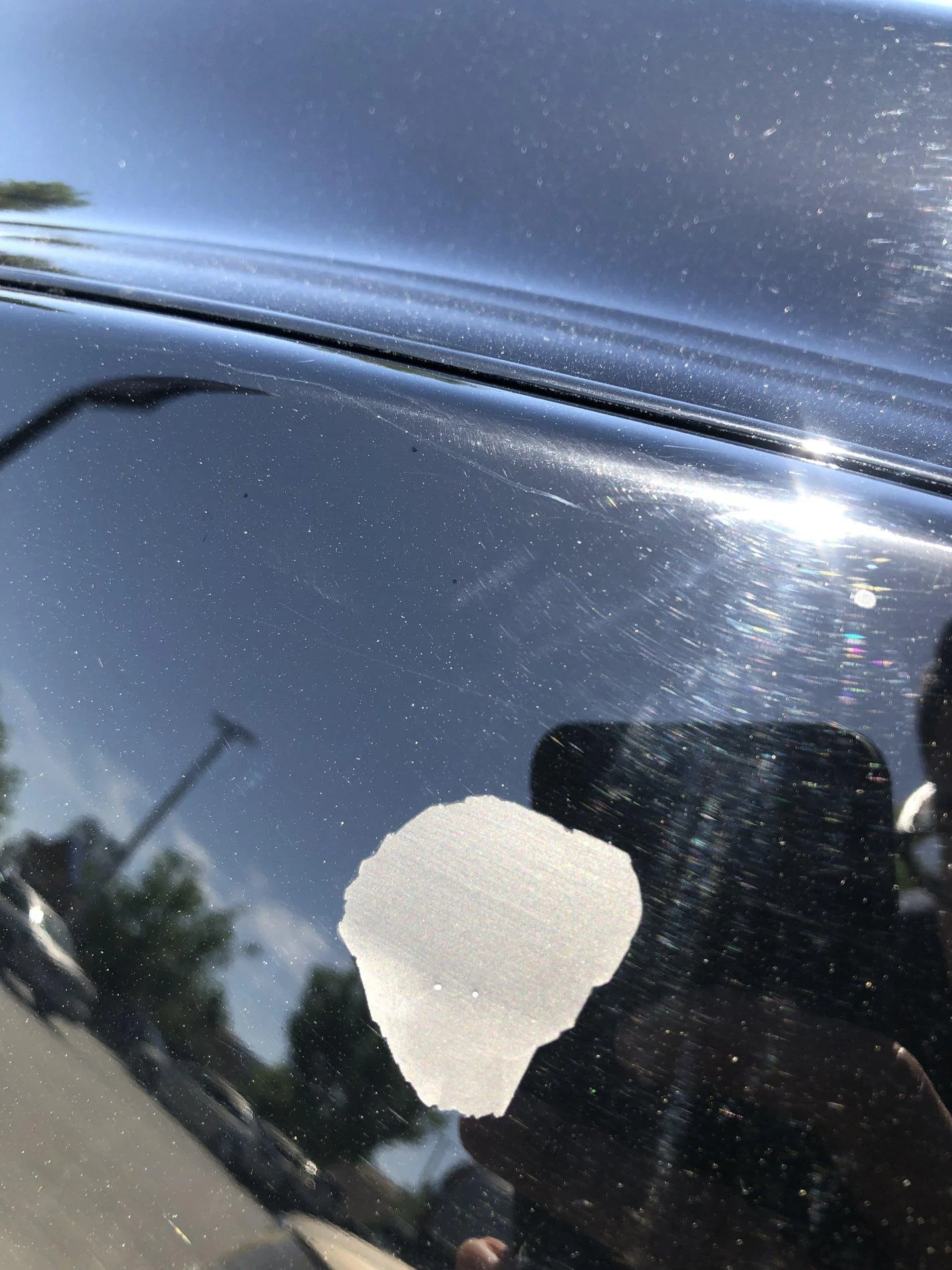

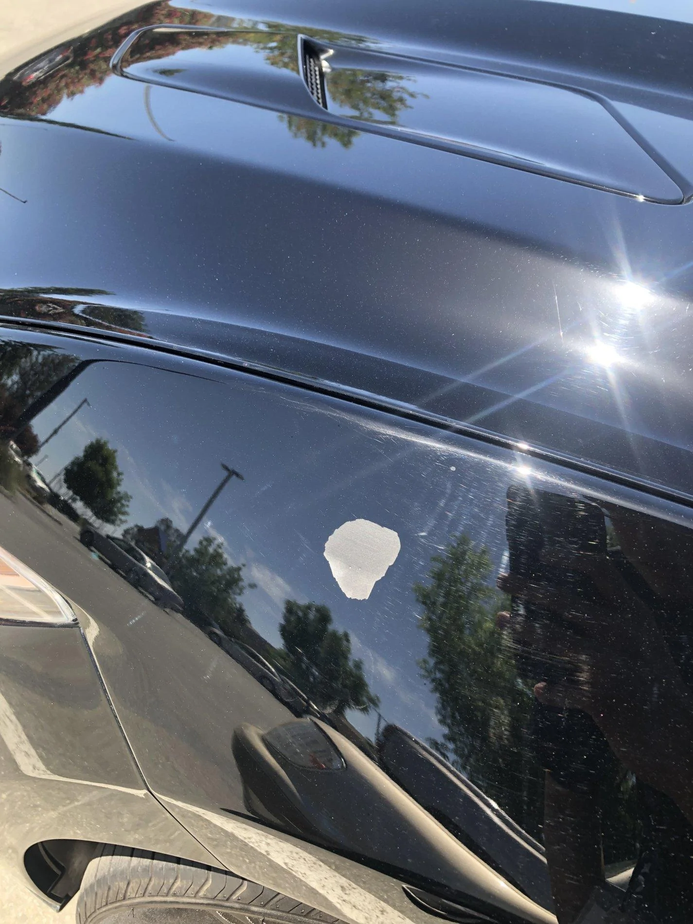

Well to cut it short I was away for a couple days and came home my car had some bird crap on it and it did some pretty good damage. I didn’t notice till I was washing the car this morning and paint started chipping off from where the poop was. Does anyone have any ideas on what I can do or should I just get the whole fender repainted? I’m good a diys but idk about this one.

It looks like there are two slight impacts in the metal itself in the effected area? Like two pinpoint sized divots? Maybe it was previously damaged by something else or maybe the factory painted over that blemish in the fender and it was vulnerable from that pre-existing damage.
You know what I hadn’t noticed that until now, but even then for it to peel completely off like that is weird as hell. I was thinking about sanding the area nearby and spray painting it but I can’t find any good spray paint to match the factory color. The paint also looks quite thin too, I have my side mirrors peeling on the top portion seems it’s a common problem with these cars.
that looks like a rattlesnake bite. Even Ford paint can't hold up to that.
I don't imagine a DIY repair will look very good.

Absolutely 0 chance that the damage there was done by bird poop alone. For it to chip and flake off like that, the panel had to have been repainted poorly. The poop isn't so acidic that it penetrates the clear, base, and primer coats. At most, it'll just take the clear coat off, but after it's dried in the sun, it's not going to keep penetrating down. Those dimples look like a tac weld puller spots. My guess is that the panel in question has been repaired and repainted very poorly before.
Yeah that’s what I was thinking also, but as far as I knew my car didn’t have any accidents reported and I never noticed anything wrong with the paint before. Just happened out of the blue

Something fairly minor may not show up on a carfax. You could get the car inspected to see if there is evidence of paint repairs.

Take it to the Dealership and see what they say.
That should be covered under the paint warranty because factory applied paint should not just peel or flake off after washing bird crap or anything else off of the car....
Did you buy that car new or used?
