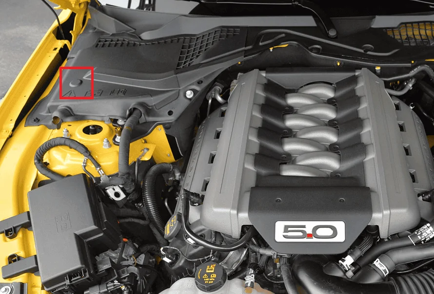

bmatt
May 17, 2015
290
South Carolina
Brian
2015 GT Premium PP, 2014 Honda Odyssey EX-L
This may be it, just guessing at this point though.

jasonstang
Oct 23, 2015
5,571
1,307
Denver, CO
2017 GB GT/CS 6MT
Nah that's just the battery cover.

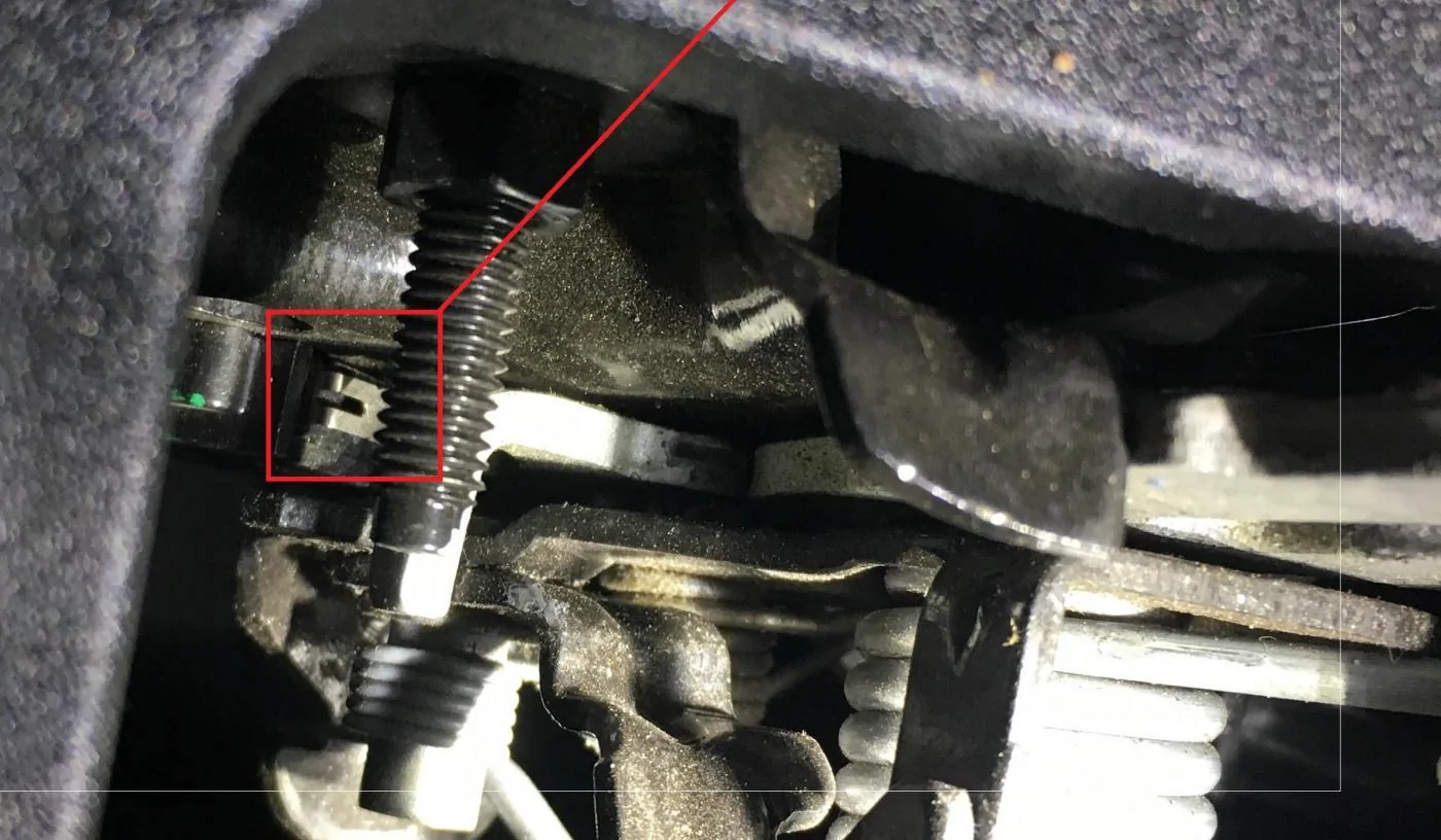

bmatt
May 17, 2015
290
South Carolina
Brian
Yep, here it is if you need, the contact is there and when the latch is closed it pushes that metal flange at the bottom down in contact with it, or so it seems.

Bartly
Oct 25, 2015
94
1,527
221
Out West
2016 Mustang GT
Got it. Took the latch out and loosened the screw holding the switch and rotated it a bit. Works like a champ now. Oh yeah, it's a small torx, I think a size 9. Mine wasn't marked, but it was smaller than the size 10 I have.
