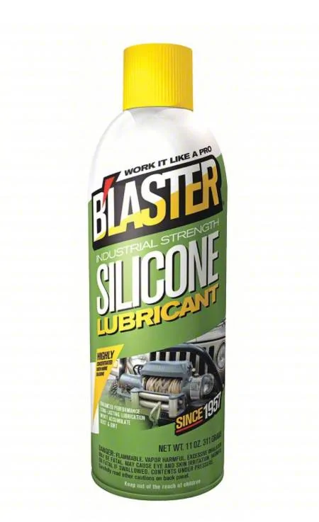

Lubricate the moving parts of the locking mechanism under the hood with a quality lubricant.
(Don’t use WD40, it’s not a lubricant.)
PB Blaster mfrs top quality products.
If wd40 isn't lubricant what is it I've used it forever as a lubricant.also use lithium and silican
In 1953, three employees of the Rocket Chemical Company in San Diego, California were trying to create a Water Displacement formula. when it was being created, they made 40 different formulas before they found one that worked. Because Water Displacement formula 40 would not fit right on a spray can, the name was shortened to WD 40.
As far a white Lithium grease, that actually is a good lubricant. It stays wet, and resist dirt. Silicone is an okay lubricant, except it attracts dirt, and should only be used in areas that are generally protected from dirt.
