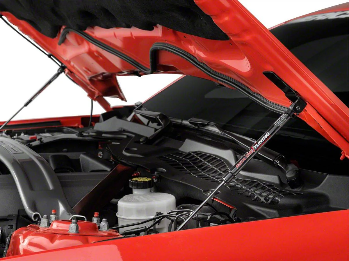

I really wish the hood was able to stay open without the little rod like most little cars have. It is very heavy and should have some counterbalance to make it easier to open and stay open. Given its weight, very dangerous.
Prop rods are just a way for Ford to save a few $$. I don't think it's particularly dangerous but do agree the car should have come with struts. Struts are a great little mod and not too expensive. I have the Redline ones on mine and love them.
Nothing about the spring or drop to latch bothers me. But I do wish the hood would pop up just a bit higher when it's released. It's a bit hard for me to squeeze my old arthritic finges in there to release the safety catch.

And when I saw the amount of deflection on the hood on struts, I removed them almost immediately. It's obvious Ford needed to beef up the hood to use struts, and that's probably why they didn't do that. Rather use the rod (with an insulator now), and avoid eventual damage, since I leave my hood open all the time car is in the garage (hooked up to a smart charger). In addition, you can still see the freaking rod (or where it was, if removed), so obviously not an OEM look. Ha ha. I actually like the rod now; it adds to the 'old school' theme, along with the manual parking brake, and stick shift, but to each his own :).
