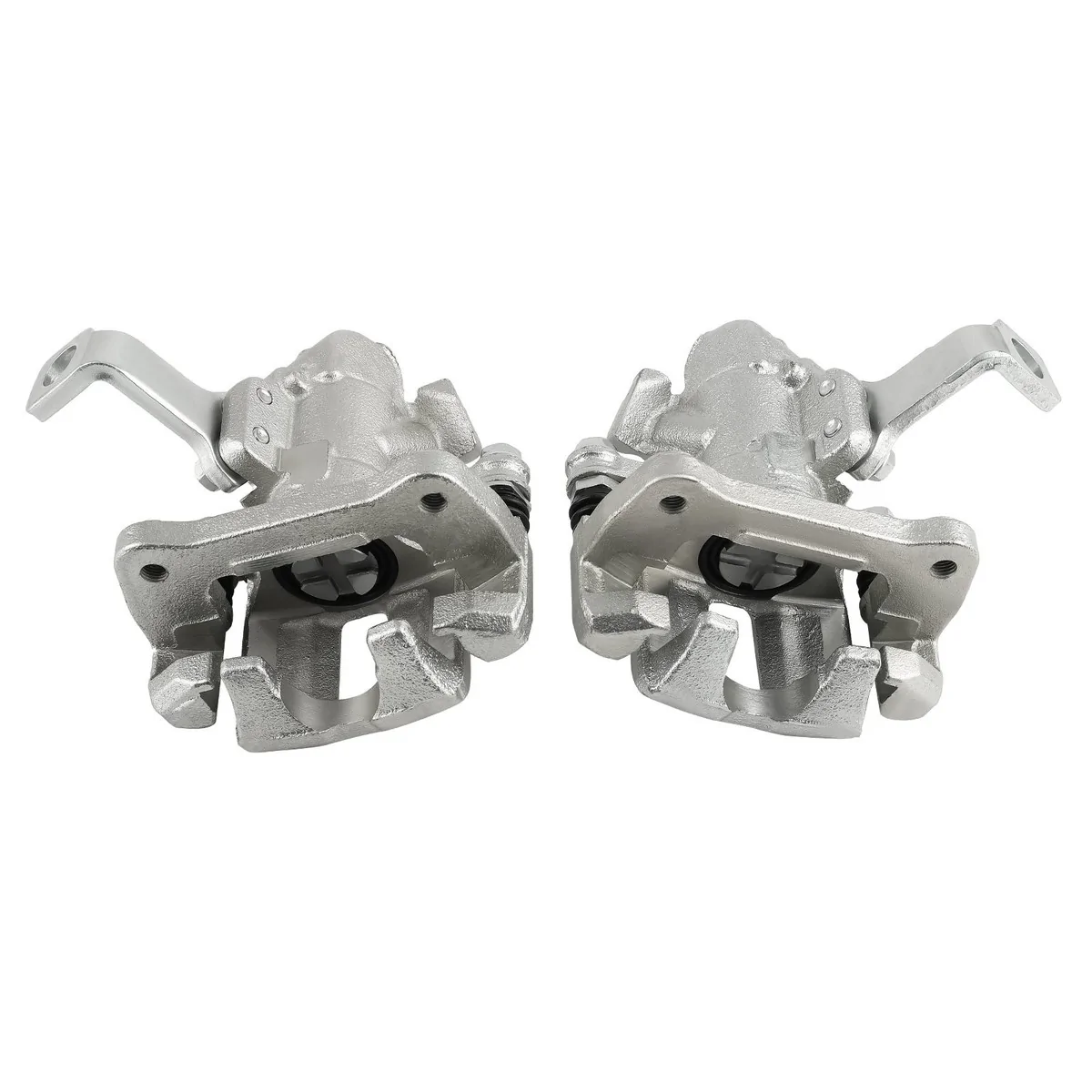

So his 2017 Civic has an electronic rear parking brake. I've never worked on one before so it was an experience for us both. The fronts are basic c clamp to compress the piston. The rears though, you can't just compress them. Im not sure why they designed it this way. The rears, you need a tool that not only compresses them but also twist them back in.. the rental tool looks like a c clamp but has notches in it to also rotate the piston while its being compressed.
I remember drum emergency brakes on trucks and older cars have the inside shoes to lock it down and a twist dial to.loosen it and adjust itself while going in reverse. I just can't imagine why they would design a piston that has to rotate and be compressed at the same time that needs a special tool? It makes no sense at all to me.

It's a Honda thing. Even the 90s honda rear disc had a cross in the casting piston. You had to twist it to get it to go in.
I'm not sure I get it. Most, if not all, cars with disc rear brakes have pistons that need to be twisted, due to the integration with the handbrake. The S550 is no exception.
I had to use something like this when I replaced the rear pads in my Mustang.
Doesn't look like a Honda thing to me, unless I'm missing something.
Yep, I've had this kind in my toolbox for years. It's been used on a lot of cars, maybe even once or twice on a Honda. 🤷🏼‍♂️

Just did brakes 2 years ago on my 2007 scion and brakes last year on my father's avalanche. C clamp was used to just compress both of them with no twisting needed.
Some cars with disc rear brakes have separate brake shoes for the handbrake. In this case the pistons can be simply pushed back in. Maybe the Scion is built like this?
But most modern cars have the handbrake implemented with the same calipers and pads as the actual brake. In this case the pistons must be twisted to retract. It's because of the auto-adjustment mechanism of the handbrake.
You'll have to do it on your Mustang, too, when the time comes to change your rear pads.
