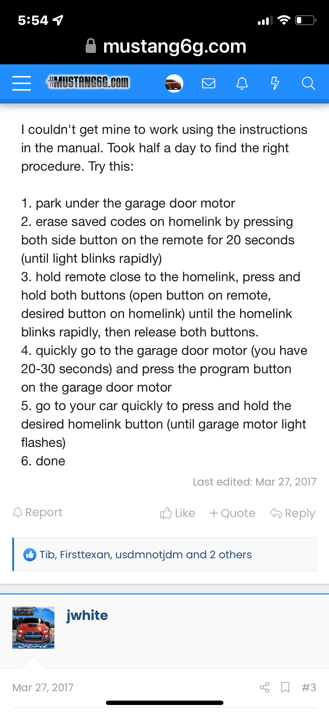

Yes on the forum!!! Picked up my 2022 Mustang last week and on Saturday followed the Ford instructions several times with no luck for some reason. I had saved instructions (below) on this forum earlier — both openers programmed to Homelink first time! Yippee!!
