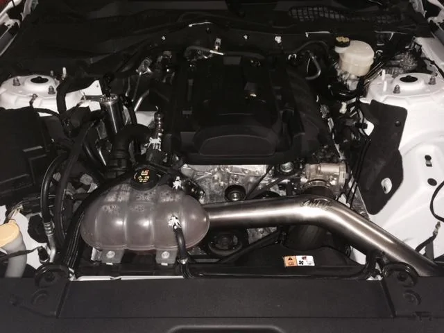

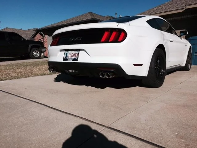

I'm building a production style build with the concept of what an SVO would be in today's world. Big brakes, hot suspension, svelte looks, and a turbo 4 that goes like stink.
2015 EBM Base, 3.15 AT
Adam's E30 Tune Cobb AP V3
MODS:

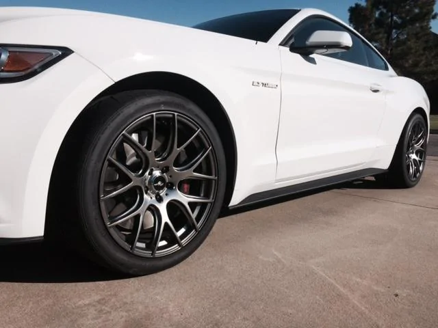

19x9.5 SVE Drifts Squared
275/35-19 Nitto INVO-street tire
17x9 Bullitt Wheels
275/40-17 Mickey Thompson ET Street R

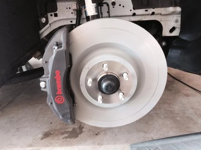

Brembo 6 piston, 15" rotor front brakes
BMR Cradle Lockout Kit
BMR Differential Lockout Kit
BMR Spherical Vertical Links
Mishimoto Intercooler
Turbo Smart IWG-75 w/ 17lb Spring
Turbo Smart BOV, recirc
UPR Dual CC/PCV Delete
Custom TBE, no cat, 3" DP, Gibson muffler and x-pipe, quad exit.
****************************UPDATE 01/19/2016****************************
Going full drag/street car. Looking for 10's.
ATM intercooler
Race Star 18x5's and 17x9's with MT rubber.
MAP 5558 Turbo kit enroute.
E85 testing ongoing with CP-e fuel rail and Split Second controller
Steeda Motor Mounts added
Watson Racing roll cage in the works.

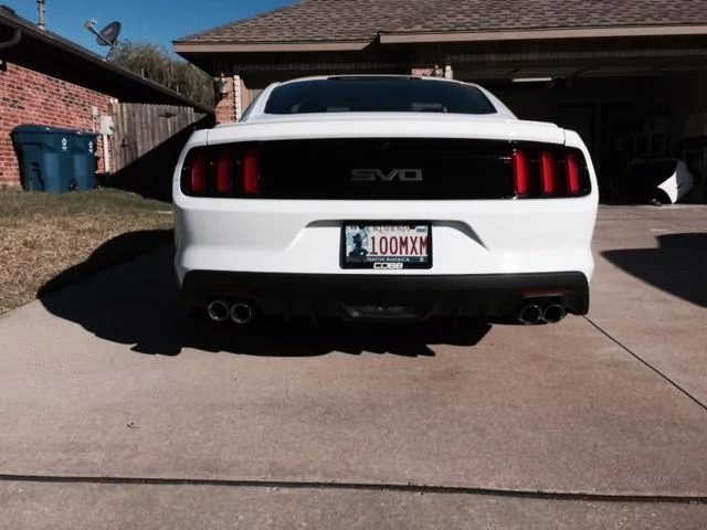

Cool build. I like the SVO badge on the back.

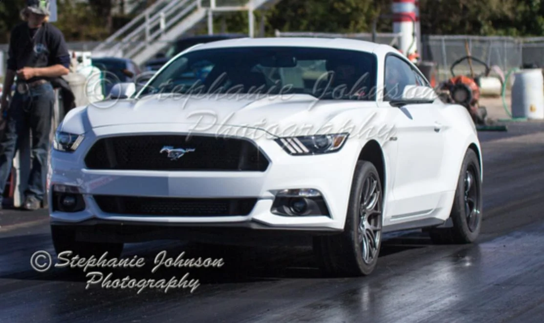

hey higdominator i've been following your build .. im definitely going in a similar route as you this spring (minus the drag radials) i got all seasons(base 3.15 gears auto) what kind of numbers should i see with e30 adam tune, fmic, intake, exhaust full weight?

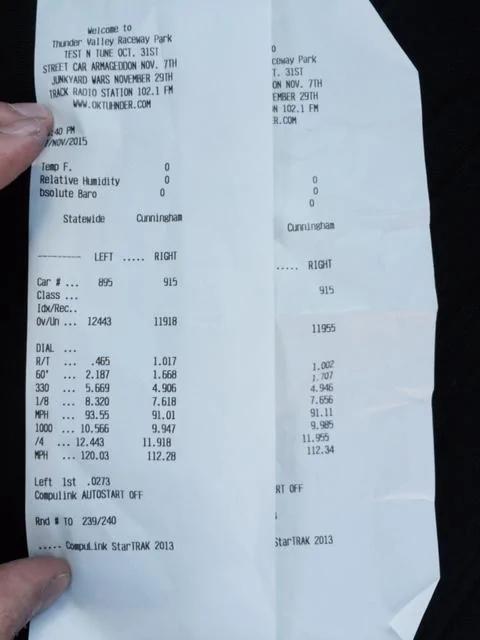

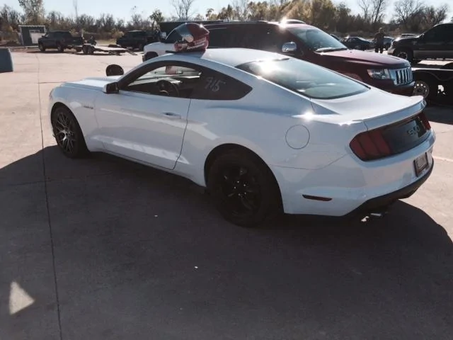

Maybe mid/high 12's on a really good day with all seasons. You will have to leave off idle and deal with traction issues when boost hits. Both of those kill your 60ft and 1/8th times which are essential on the stock turbo.
I went 12.5 with an E30 tune and 275 Nitto Invo's (street tire).

Nice numbers! What's your launch technique on the DRs?
higdominator
Aug 6, 2015
1,552
383
Central Oklahoma
2016 GT PPP
i may get some PP wheels + tires .. would that help at all ?
Maybe, not much. This car needs to launch on boost to get out of the hole. On Adam's E30 tune I could roast my tires just punching it at a slow roll when the boost hits. The car is just plain silly on street tires. Get some Nitto 555r's. They aren't the stickiest dag radials but they last a long time. They should be good enough to get you into the low 12's. Hell, I'll probably be at the track if you go out there, we can get the car to go fast, but it needs to 60 in the 1.7/1.8 range.
Solid burnout, brake boost to 3200ish and let it rip on the last yellow.
