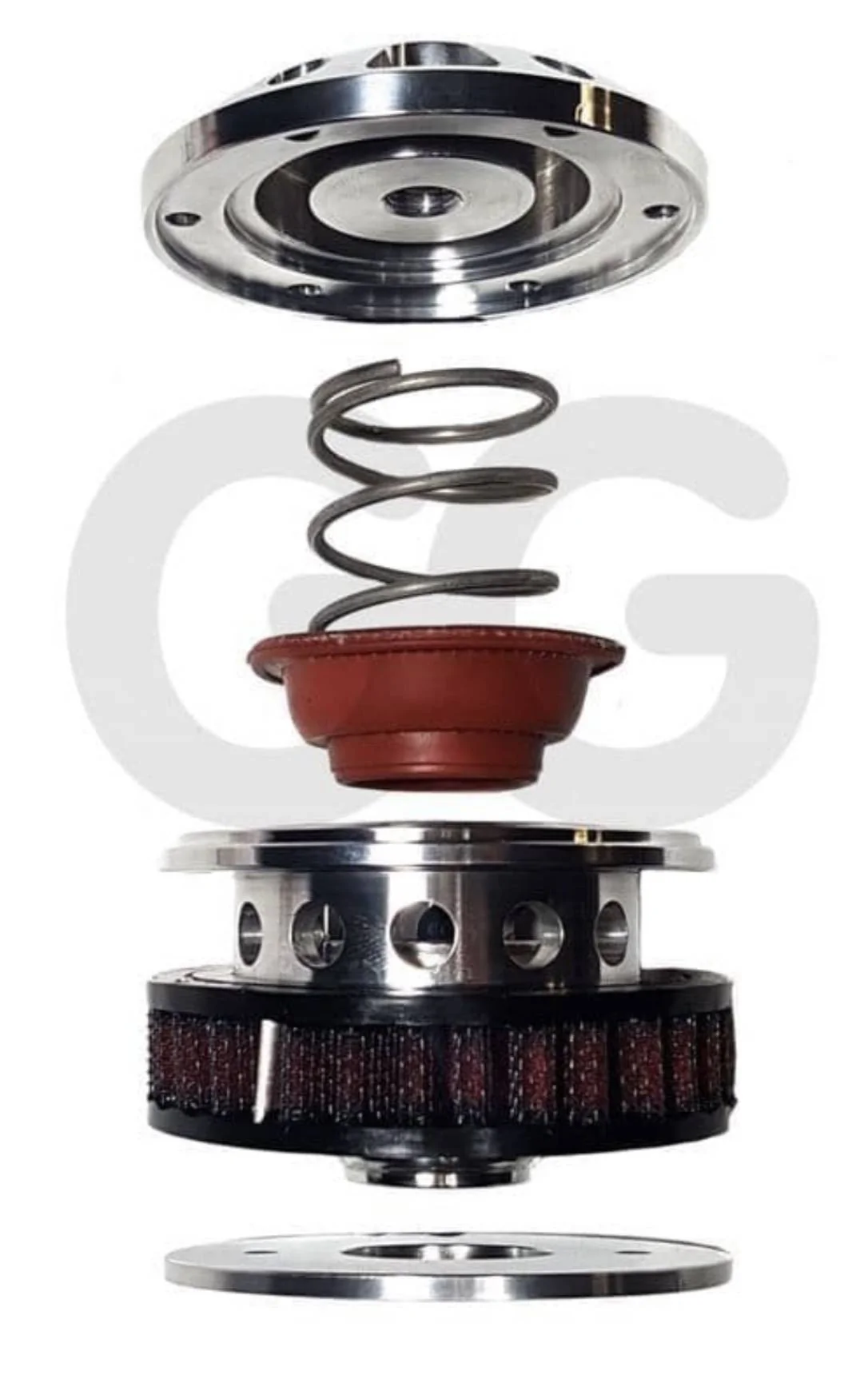

Valve connected either side of the throttle body.
Intercooler side is sealed with a silicon Kevlar diaphragm.
Spring sits on the back of the diaphragm and keeps it closed when both sides see the same pressure.
Engine side connects to inlet manifold.

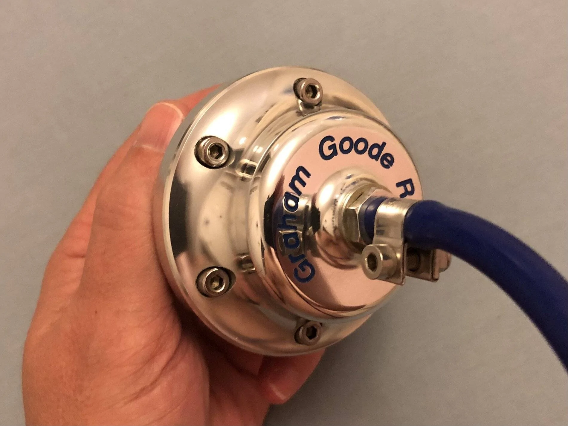

Dunno what you guys call them, but over here this is an old school dump valve (but rare with a K&N) - here’s an exploded view of the type that I have :
Heres mine, but with the filter and filter securing plate stripped off and bagged whilst it’s in storage :
