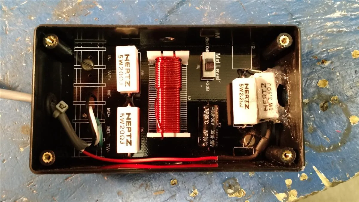

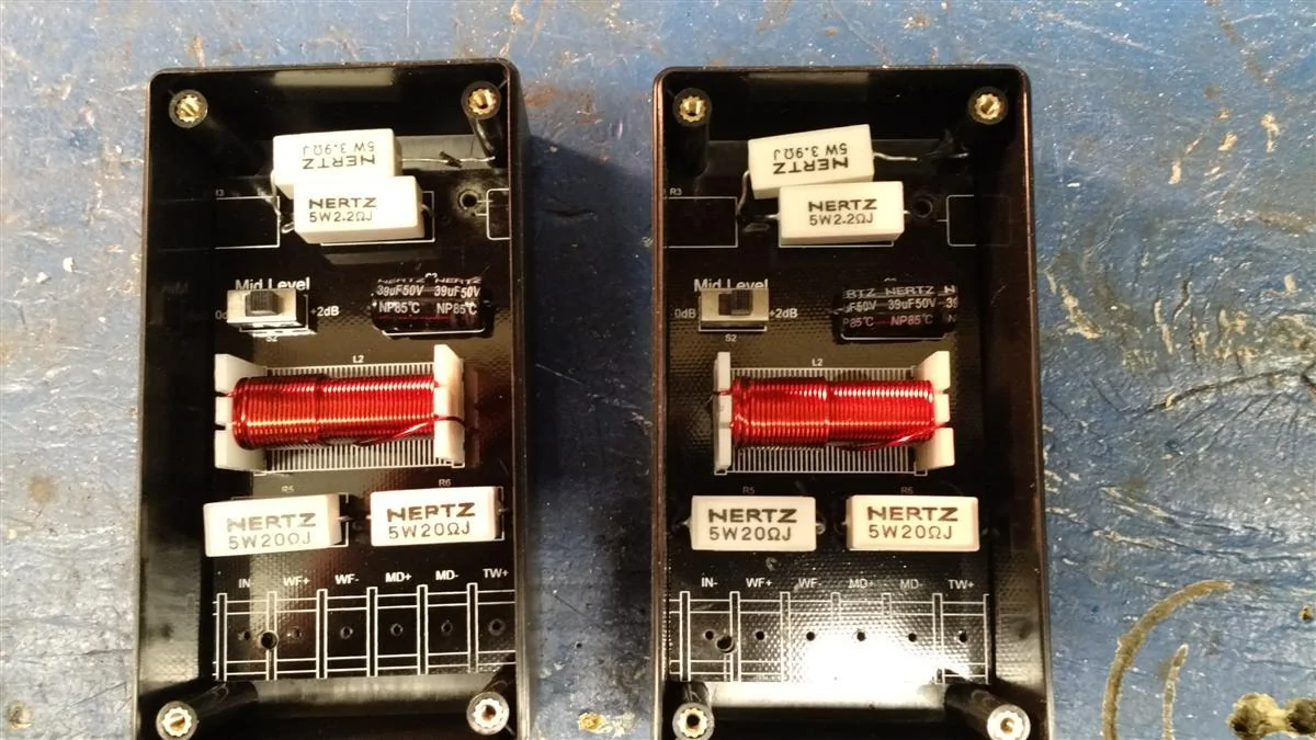

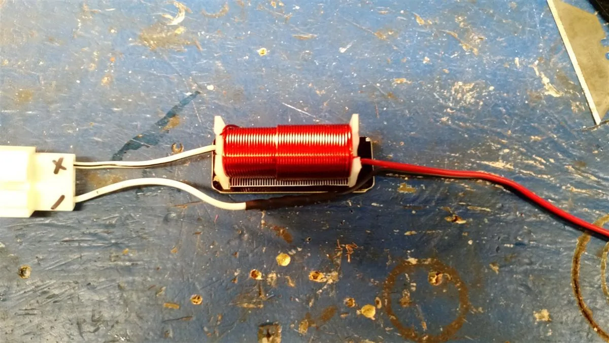

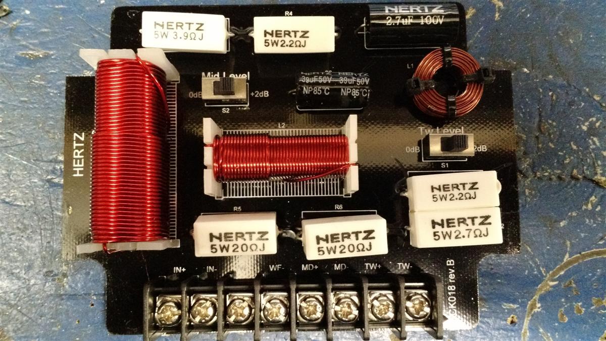

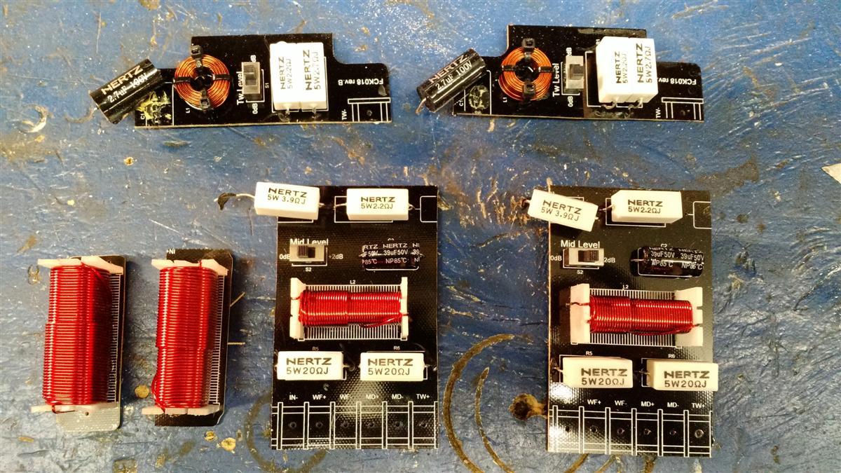

Ok....here we go.I just finished installing the Hertz mille 3 way speaker system.I put the JL audio 600/6 amp in some time ago,with jbl gto speakers all around.The sound was ok,but not as good as it should be.It was time to go to the next level.I am using all of the factory wiring,so it was a challenge with the crossover.I cut the crossover up into sections,and mounted each section with each driver.

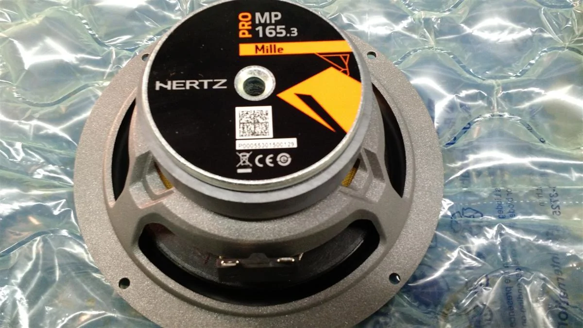

The quality of these hertz speakers are outstanding.You pay,but you get!

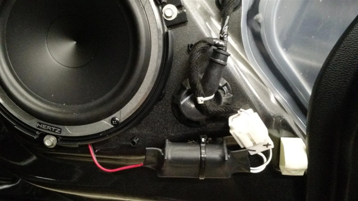

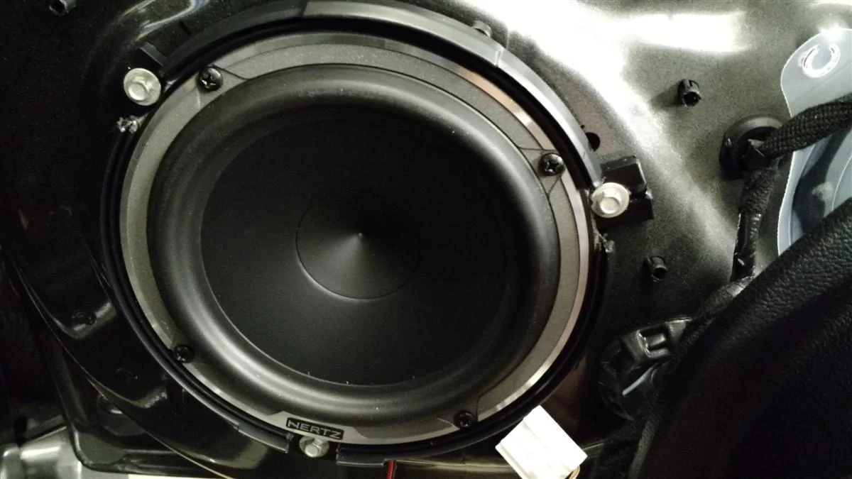

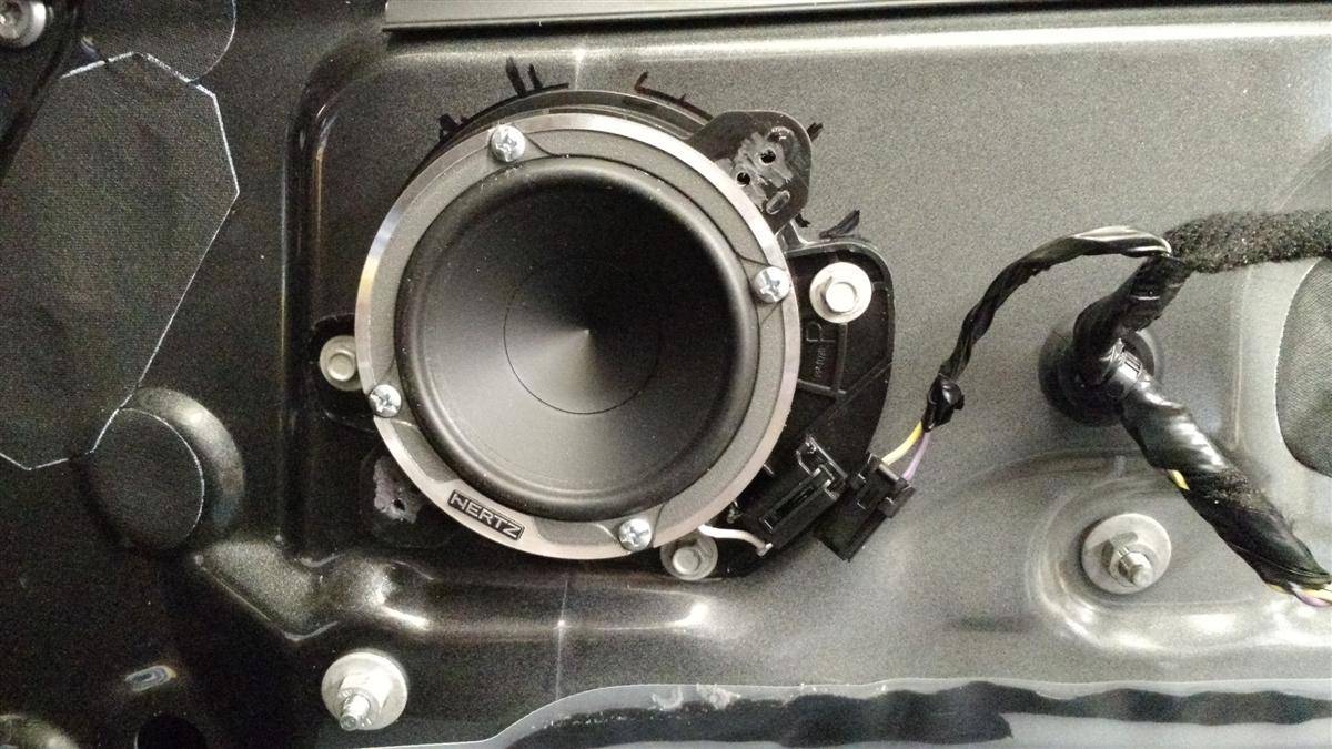

The speakers bolt patterns are wider,so the door had to be drilled and screwed through the plastic jbl adapters.

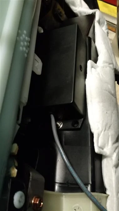

The mid crossover section I mounted in a box.It has both the male and female plugs on the cable to plug into the factory wiring.
Now the hard part was where to mount it.Inside the door panel,under the arm rest is a perfect flat plastic pad.Nothing is in the way.

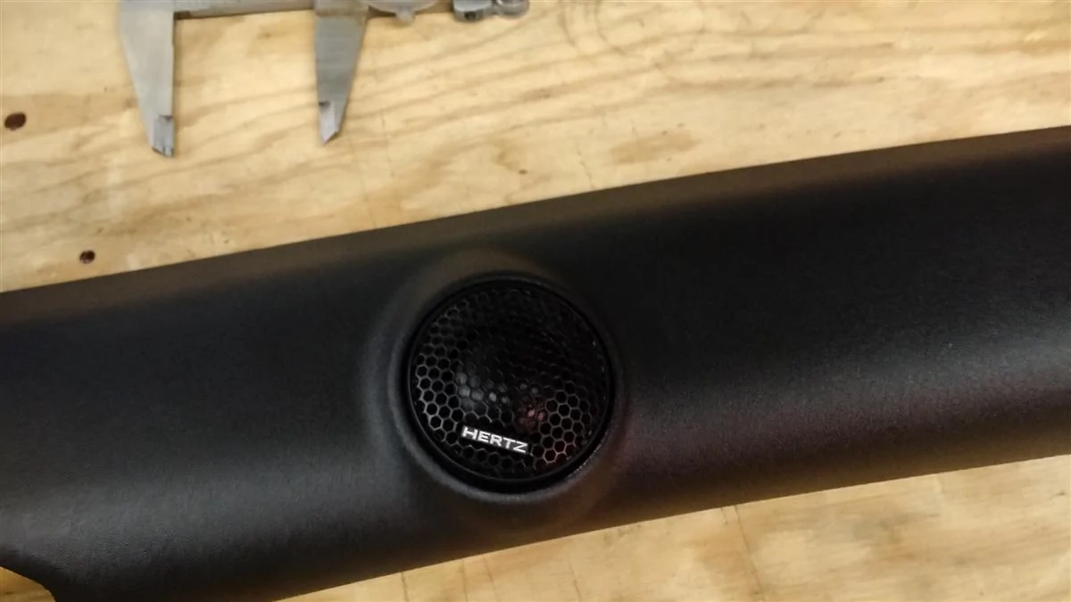

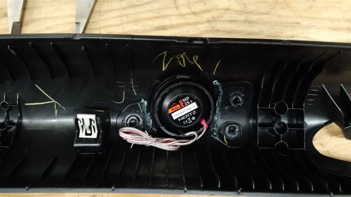

The easiest part was the tweeters.They fit perfectly into the factory recess in the A-pillar.

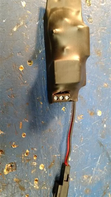

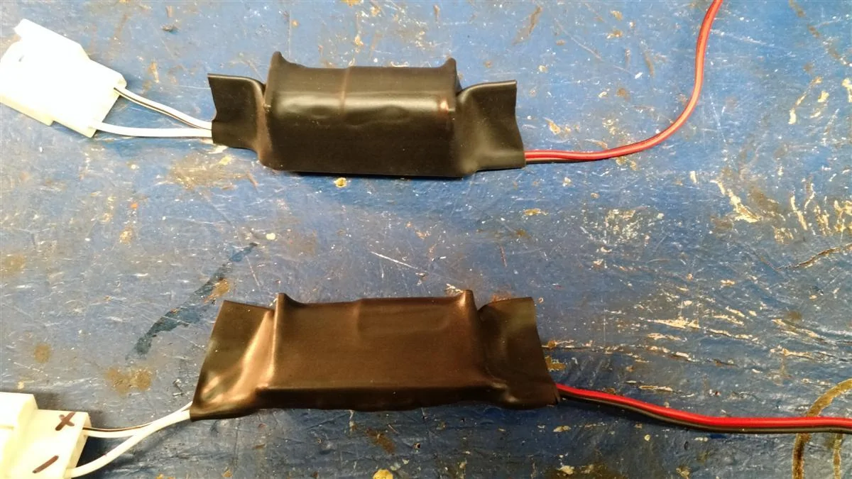

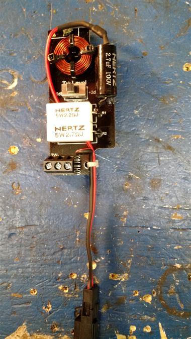

I modded the tweeter section by moving the cap and adding a molex screw barrier strip to make it easier to connect in the car.Both the woofer coil and the tweeter board are covered in heat shrink.
