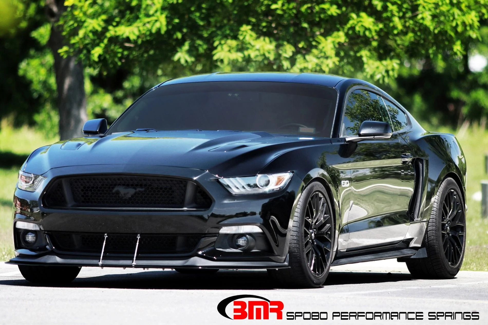

    This is the stance you can expect with the SP080 and wheels spacers ;) BMR_SP080_IMG_1402 copy.jpg

    Are those 25 mm spacers all around?

    i believe yes spacers on all four corners.
