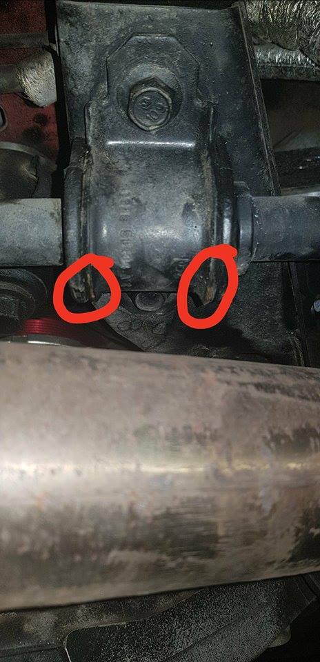

Slight update, last night i decided i'd see just how wobbly the exhaust could be ad noticed just where the mufflers clamp to the secondary pipes (after the Y pipe) were very close to the ARB holder/bushing support. I jiggled the exhaust and low and behold it was hitting.
When i'd drove without my mufflers on, the secondary pipe must have still been hitting if this was the case.
I've gone under my car just and undone the clamps on the exhaust and rotated it giving me around 2inches of room between the exhaust pipe and the ARB holder.
I haven't yet driven the car (Yay work...) to test, but i'm about to go out in the next hour.
For reference here's an image of the ARB holder and the slight marks and indentations that can be seen on it (which i think may have been what was fouling the exhaust)
Whilst i was doing this i also rechecked all bushings, and torqued everything to spec (Nothing was lose), i also did the "axle test" (Shaking the wheel vigorously) and the axles are fine (and also torqued to spec)
Could this have solved the issue? Take your bets.

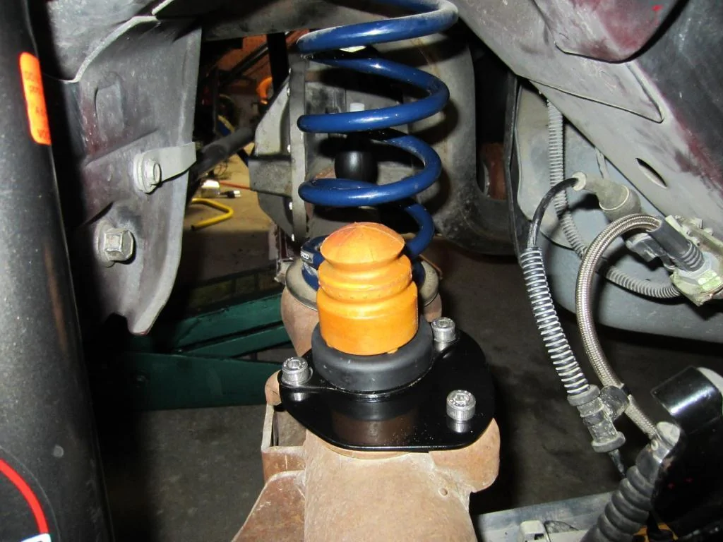

its not jsut the lower arms hitting the bump stops hard is it since you've lowered it ?
errrrrrrrrrrrrrrrrrrrrrrrrrrrrrrrrrrrrrrrrrrrrrrrrrrrrrrrrrrrrrrrrrrrrrrrrrrrrrrrrrrrrrrrrrrr I have no idea. I dont think so?
pull a rear wheel off and check the bushes its the orange thing in this picture in front of the spring. This picture is full size when you lowered it you should have chopped the same amount as you lowered off it so you don't bottom out too soon.
