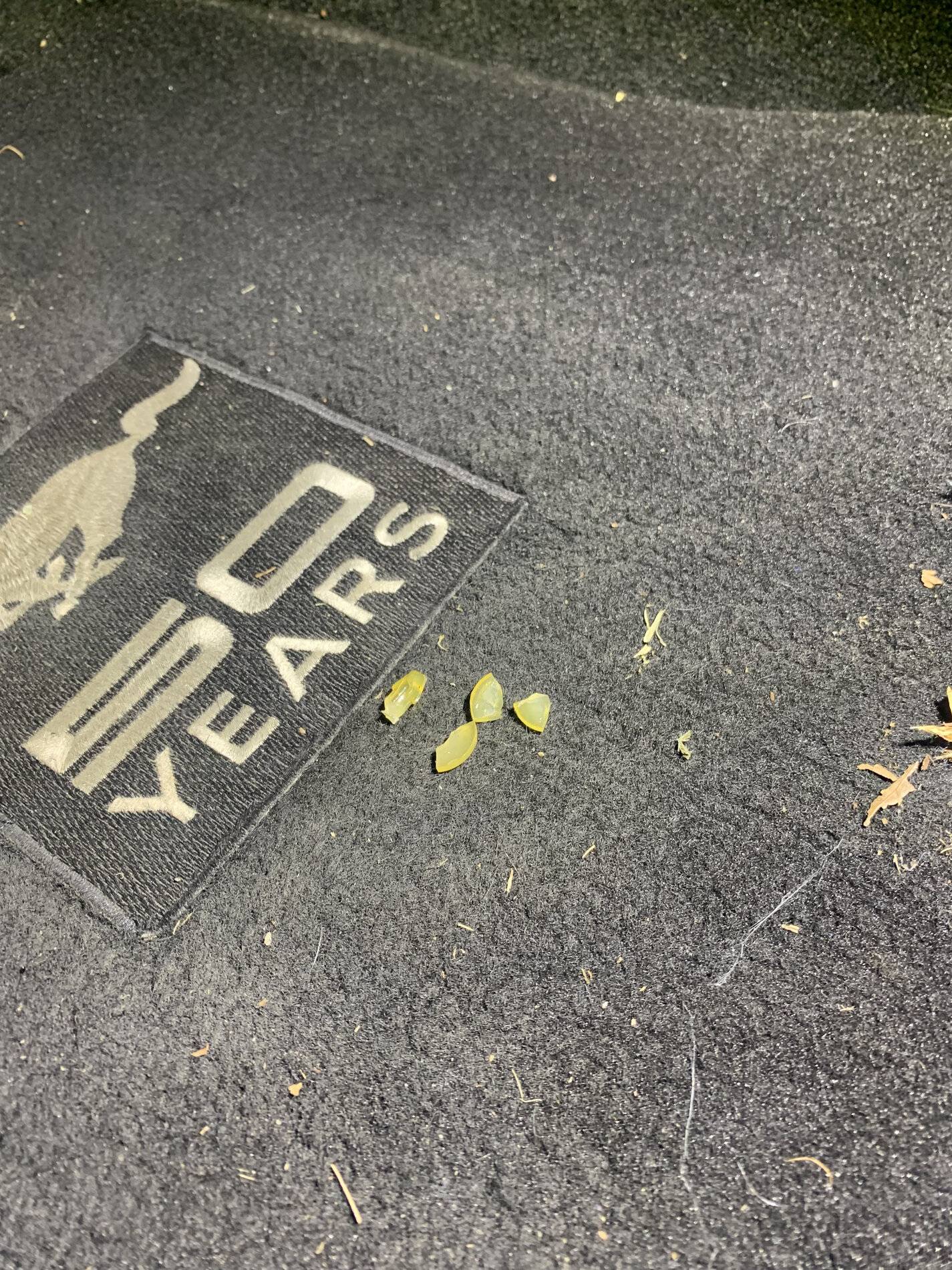

I believe its this..!!!! Hoorah. Off to the parts store now.
after already removing and cleaning MAF and TB :)

Having made the fix, replacing the brake pedal pad.. all is fixed. I have taken the car out even some spirited driving no issues.
