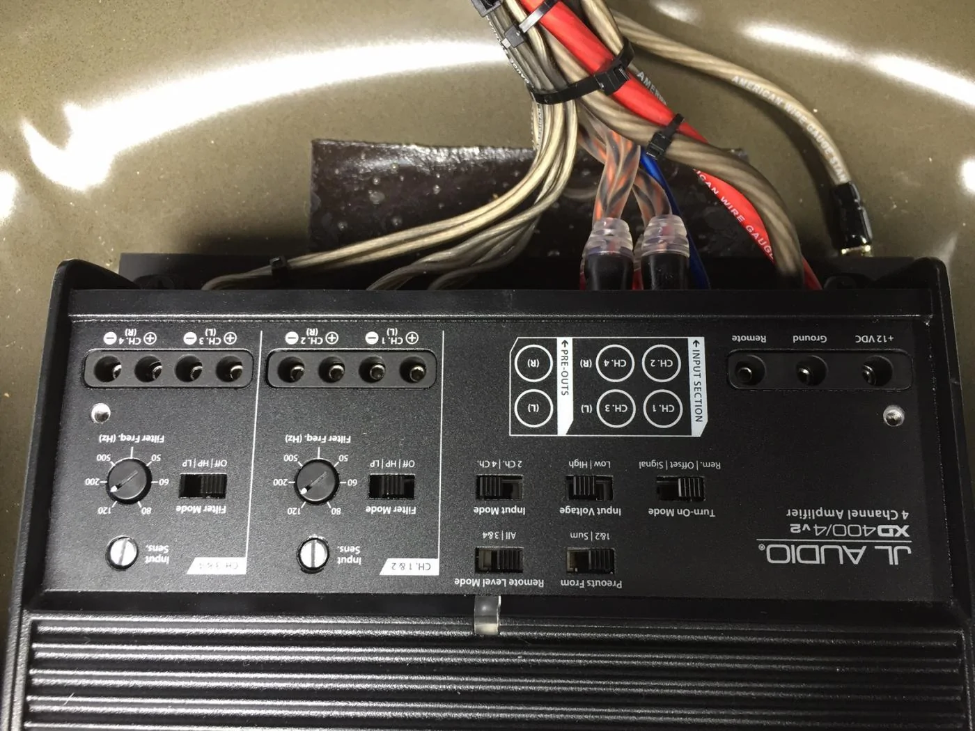

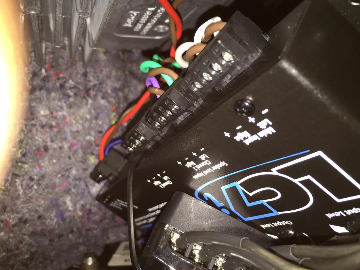

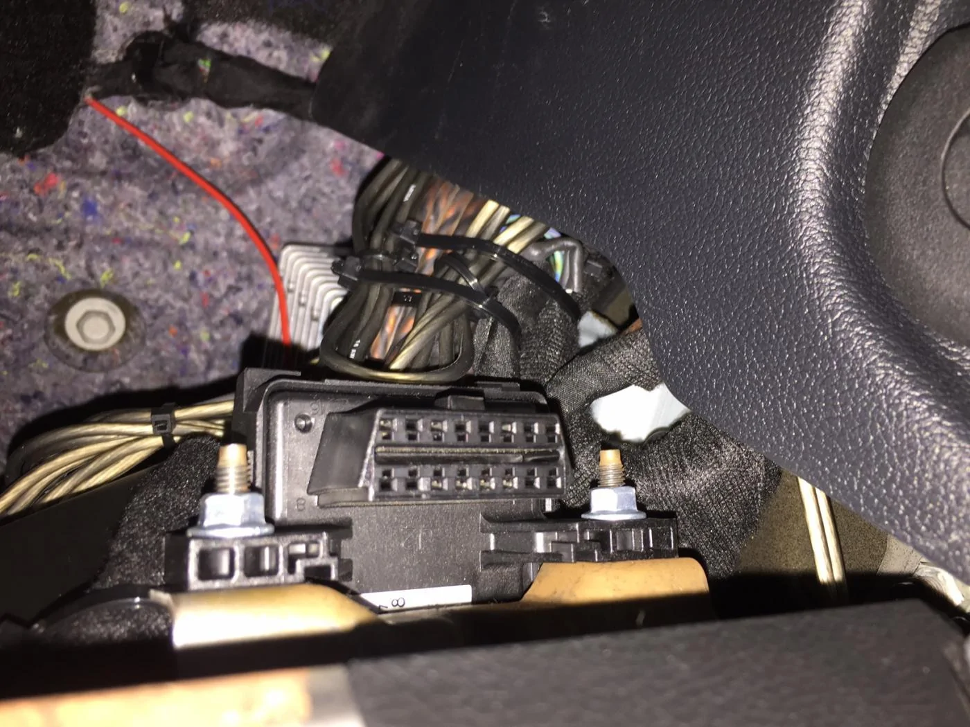

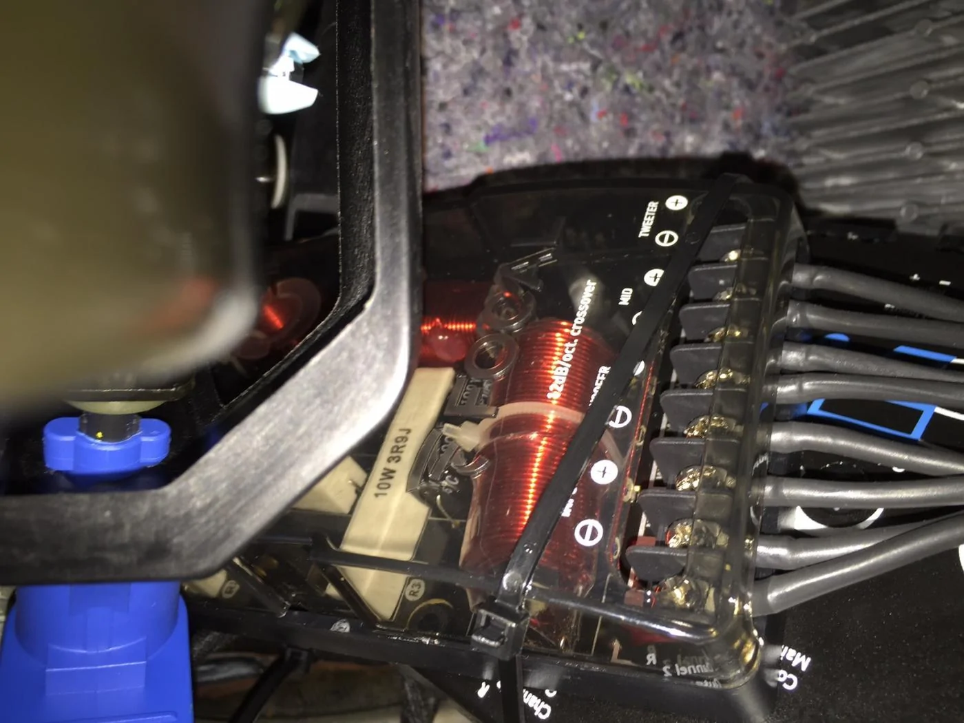

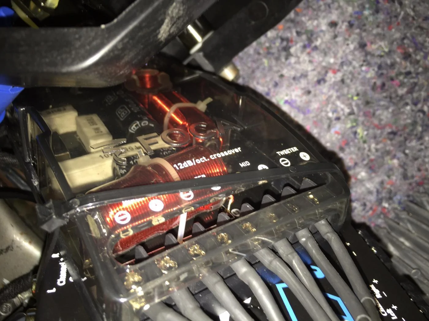

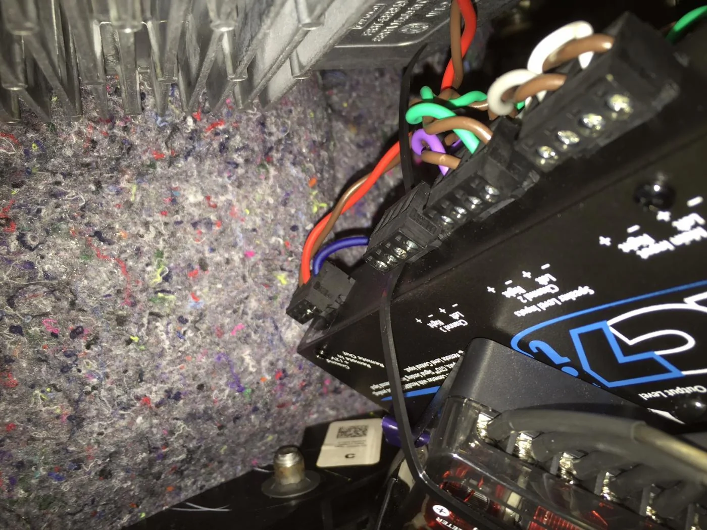

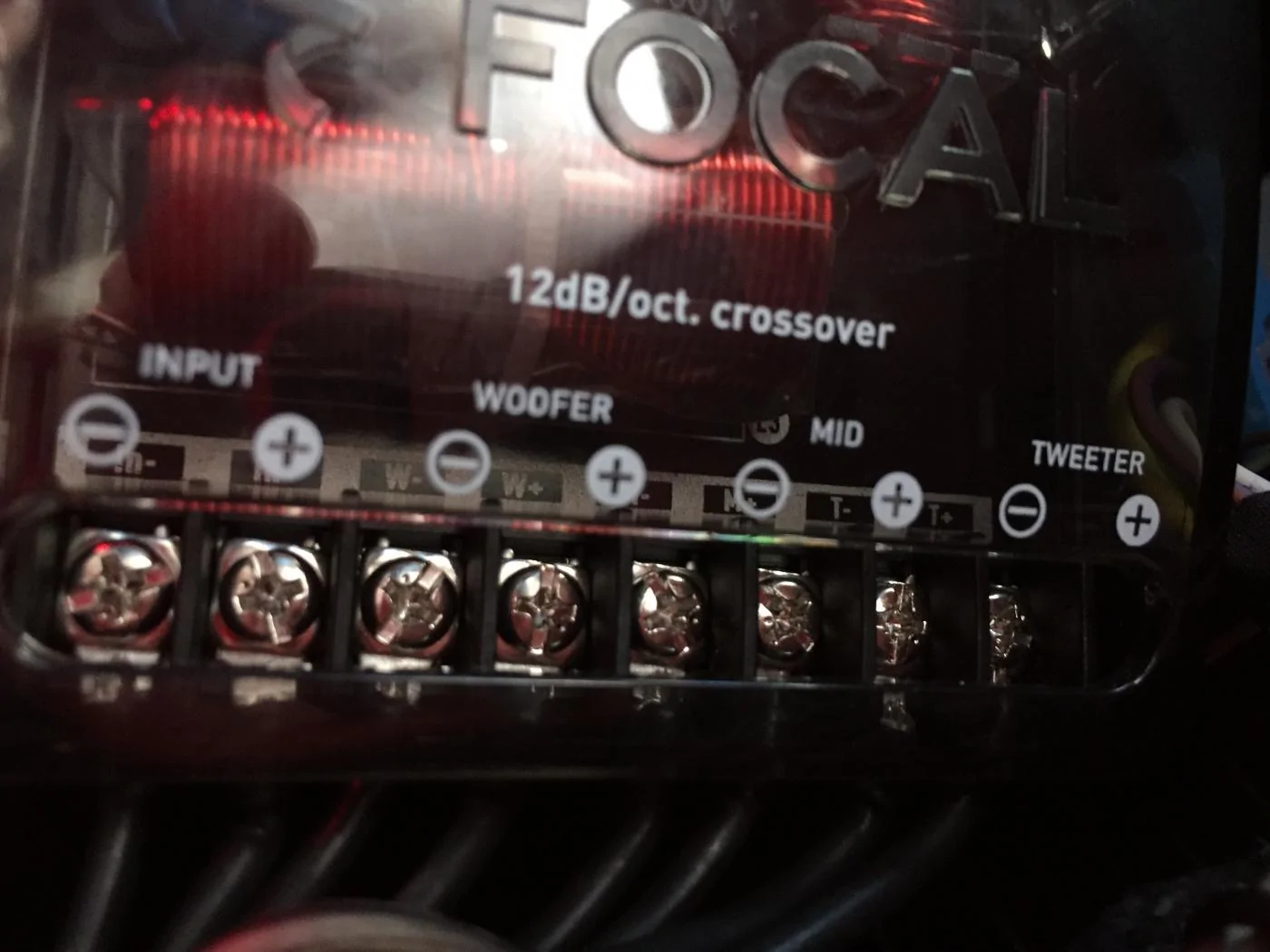

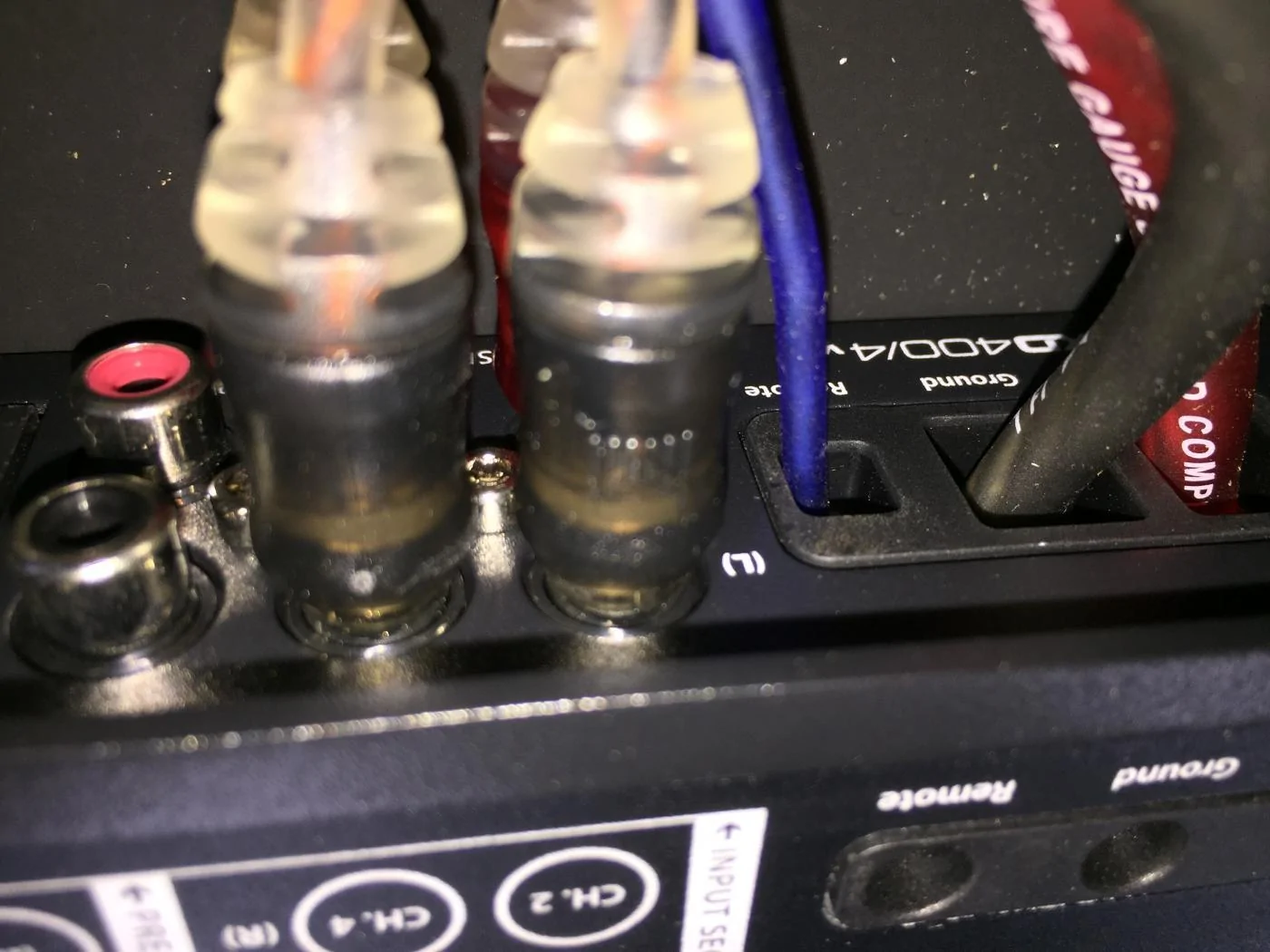

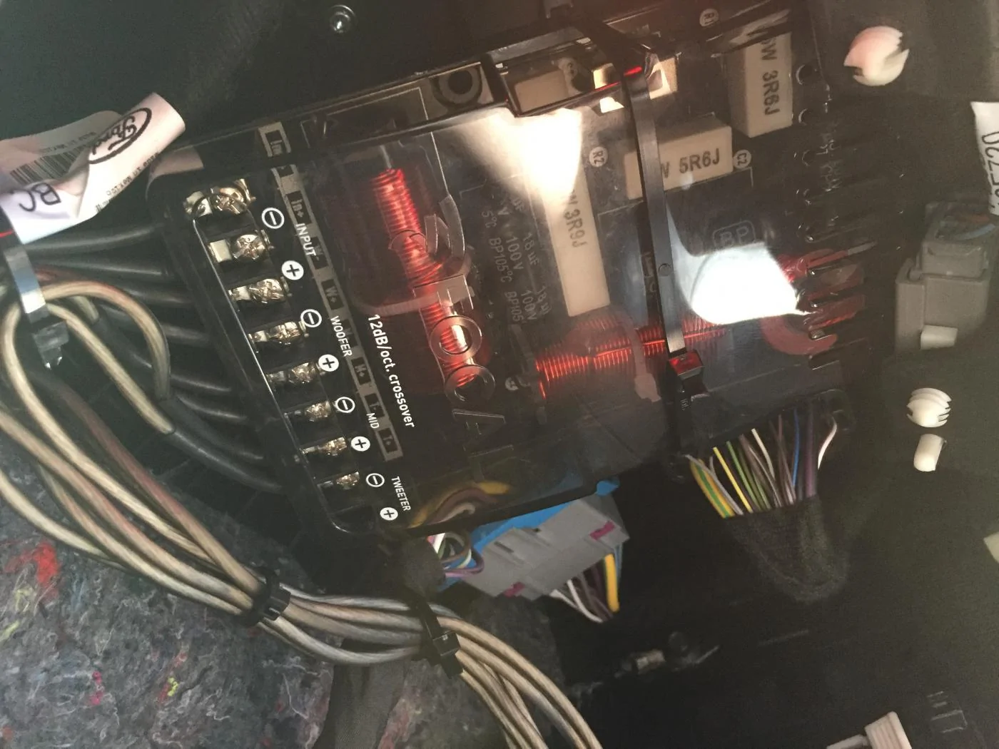

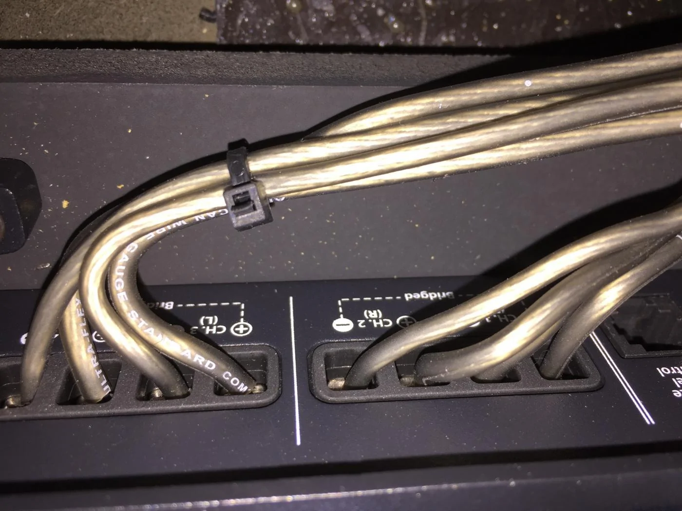

Correct, a channel per speaker from the amp. However, if the tones (seatbelt, alerts, BLIS...) aren't even playing out of the speakers anymore maybe I should do like SergeyMelnik said and just wire up the front 3 ways with 2 channels each for more power and clarity?You said that they installed a jl400/4 driving the front 3 ways and the rears,correct?The black plug down by the factory amp in the kick panel has the low level preouts you want.
I've sent him a few PMs with the latest being about the new plug harness he was working on that you mentioned.Ask OEM radio if he has the harness finished yet for this plug.
I'm going to call tomorrow and try and get the details from the tech who did the install. All I can say for now is that the amp is located in the trunk where the spare tire would go as the 15s didn't come with one so that spot was available. Thanks again.Give us some more info as to where the amp is mounted,and how they wired the speakers to the crossovers.We will get this sorted out,promise.
