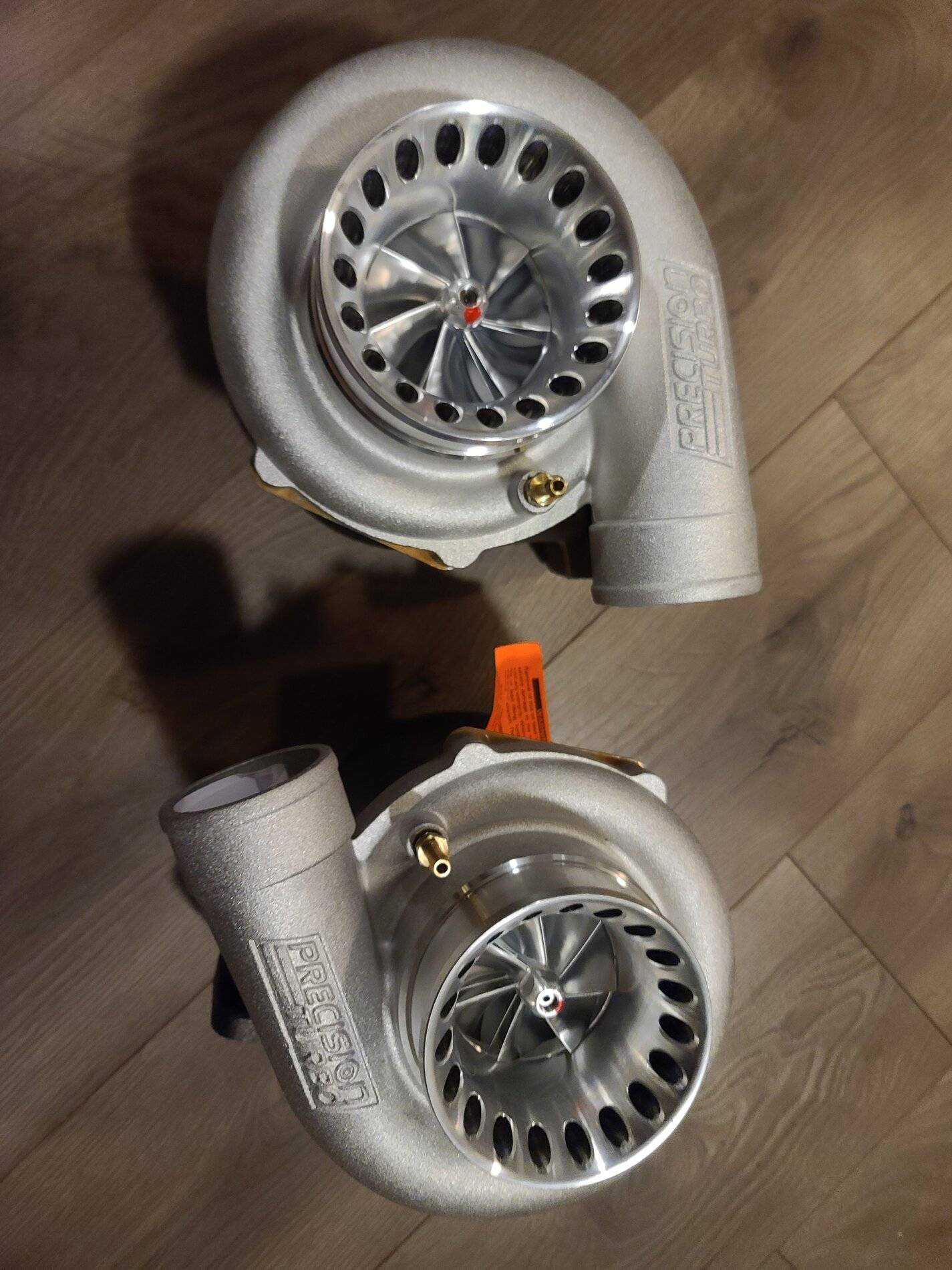

I ordered the hellion sleeper kit for my gt350 going with pte 68/70 gen 2. Still waiting on the kit to come in but I've started buying the supporting mods for it. Just trying to get an idea of what all I need for the kit. So far I have a fore triple pump full system , eboost 2 with single solenoid

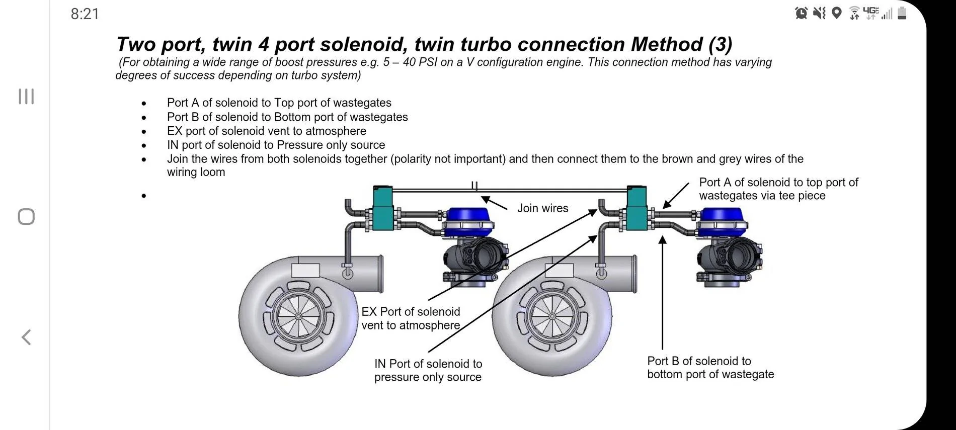

May want to look into the selonoid for the eboost. On mine hellion recommended the two four port selonoid setup. I’ve heard it’s harder to control the boost with a single selonoid🚲.
that is what I was looking at and will be doing just like this

Yup, I did that with the exception I capped off the compressors and went to my vacuum block instead.
would it not be better to have them on the housing for quicker response vs the vaccum block
Can’t remember my reasoning........... did have it off the compressors originally and changed it.

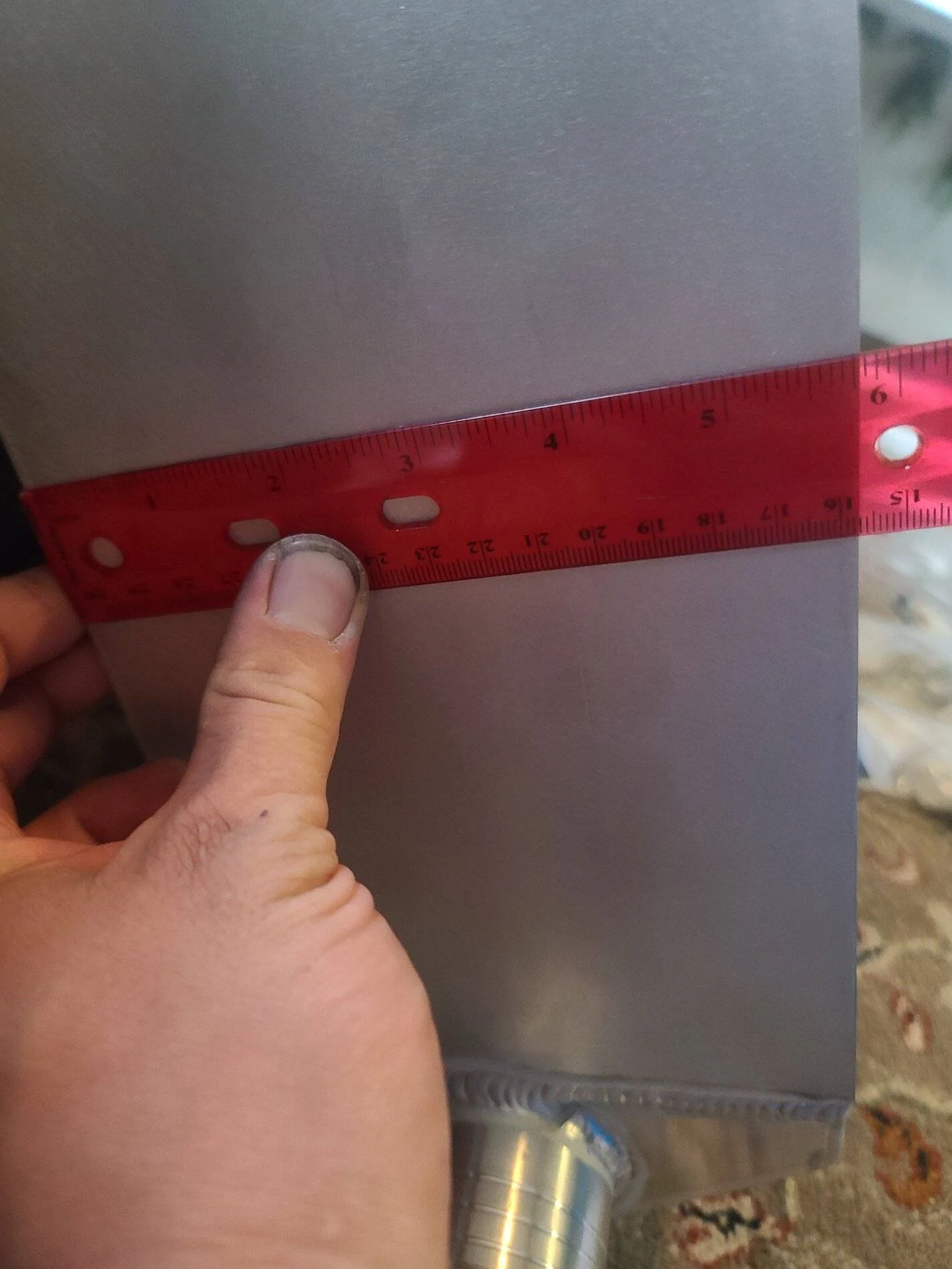

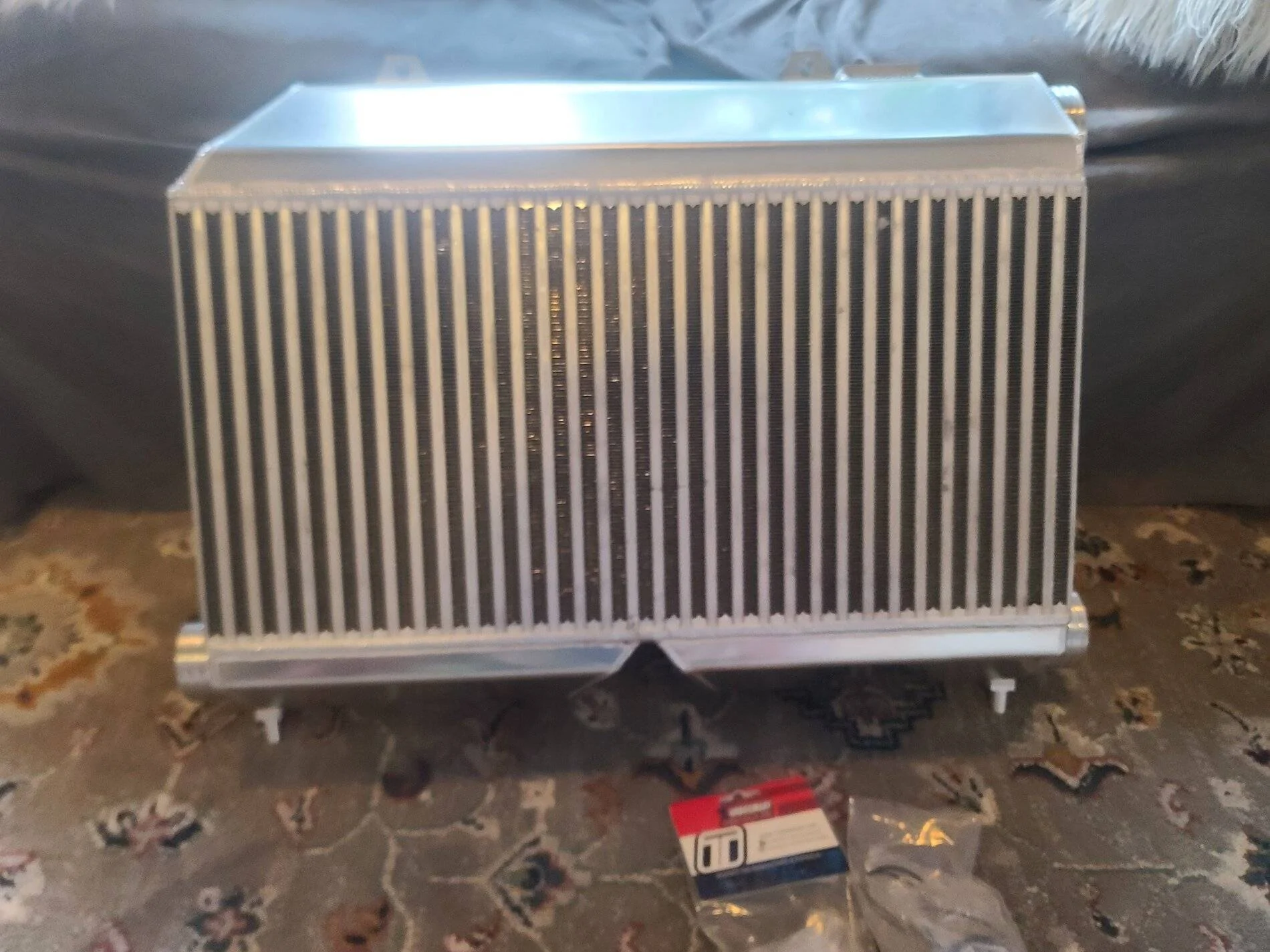

intercooler and two 4 port Mac valves showed up today went with the 6 inch version this thing is hefty at 41 lbs

is this the $750 "race" IC unit? and for spark plugs, lots of guys run the NGK 6510's.
yes it was 750 to upgrade to the 6 inch race intercooler and that's the plugs I bought today
