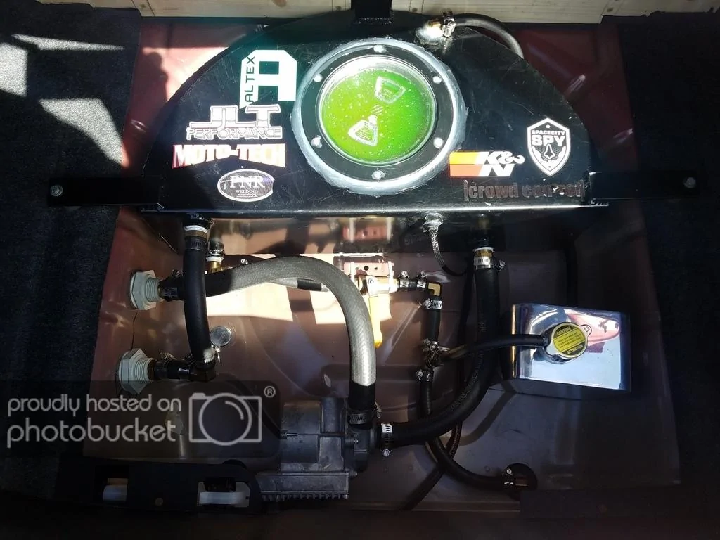

some background info before my questions - My car has a Roush blower, with a VMP heat exchanger/fan setup, and an spare tire mounted ice tank. The pump is a Rule 2000 Bilge in the ice tank. Shortly after I bought the car the pump died and my inlet air temps went up to about 185 degrees. I babied the car home and parked it till I replaced it with another. I bought the same pump just to buy me some time and get it back on the road. A little over a month later (yesterday), it died on me again so I have once again parked it. I drive roughly 30 miles one way a day and can take between 20 minutes to an hour and a half to drive those 30 miles.
My question is what is everyone running for their heat exchanger pump? I really don't plan to drag this car, so i'm really looking for a reliable pump that can run all the time and is suitable for daily driving with occasional "spirited" driving. What kind of flow rate does this actually need? The Roush kit seems to come with a little 5.5gpm bosch style pump (which my car is missing) - is that sufficient/reliable enough? I've looked at a handful, but figure rather then guessing i'd see what others are running. How often are you replacing pumps?

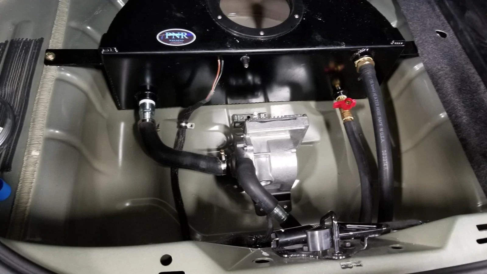

I didn't/haven't tried the VMP upgraded pump - because I wanted to retain my ice tank in the system, and after doing a bunch of research on flow rates etc, I went with the Stewart EMP pump. The main reasons were that this is the pump that is/was used on the Ford GT, has been used on numerous transit busses throughout the world, and had a life expectancy of around 10,000 hours. I figured if it was good enough to use in fords supercar, reliable enough to be used in transit busses, and had enough hours between failure I should be able to drive around 7-10 years before failure - those were all arguments I couldn't beat with other pumps. it was pricy by comparison to other pumps, but it's been running in my car as a daily driver since august of last year without any issues.
The mounting instructions said to mount it a specific way, but everyone else I had seen with one didn't have it mounted the way the directions said to either, plus it would have put the weep holes on the top of the pump, which made no sense to me. this may reduce the lifespan of the pump, but if I can get at least a year or two of use out of it before failure then I think it was worth it.

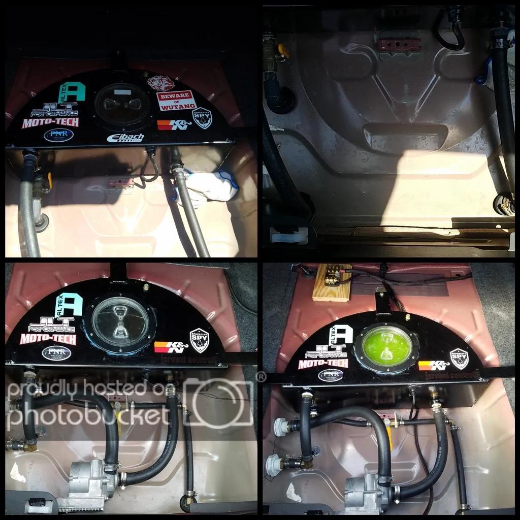

By the time the dust cleared this was my finished install.
Most of the pieces I needed I bought off amazon (mostly because the local hardware/auto stores didn't sell them). I ran a 2AWG power wire from the battery to a distribution block (tongue and groove), then ran an 10 AWG wire to the pump, this should ensure I receive sufficient amperage to the pump and gives myself expansion for a couple of stereo amplifiers later. The old wiring that ran into the tank for the bilge pump was repurposed with a float switch that was wired into my relay signal source. This way if I blow a coolant line under the car it'll shut off the pump before any damage occurs from running it dry. I had an issue with the tanks breather so I added plumbing for an overflow tank, then modified the cap so it wouldn't hold any pressure. I was able to close up all the holes in my trunk to keep moisture out of it. the original setup had no grommets or seals to prevent moisture getting into the car, but the plus was water that leaked out (there were a lot of issues with the original setup leaking) would just drain out. now I have both, sealed and a way for the water to get out.

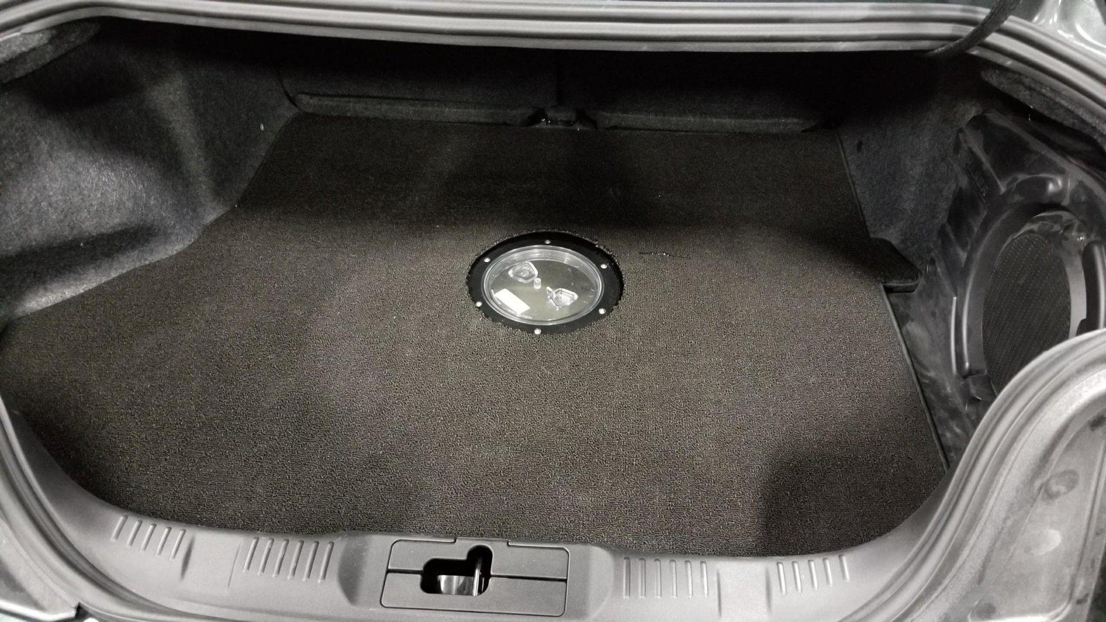

Once I don't have to worry about freezing temps for the season, I'm going to pull it all apart again and bed line the spare tyre compartment, replace the rubber lines that run along the body with copper lines, and modify the float switch so i can lower the water line in the tank to be able to add ice again if needed. I've also started building a Faux floor to cover it up and give me trunk space again, since my tank doesn't sit flush with the spare tyre tub.
