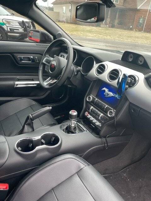

It works entirely off the plug in the steering column. You have to route the wire up to the top part of the dash and then find a place to mount the box. I didn't bolt mine down it's just floating

Sorry auto correct I meant the obd when I look at the installation it seems like you have to have it plug in.
Nothing goes in your OBD port, the big plug is in the back of the steering wheel then the other box plugs into that. Then you plug the box into the HUD or it may be prewired on the other end i don't entirely remember.
Then all of the information it's entirely contained within the HUD and the box. You can switch from KMH to mPh despite what the website says. The hardest part of the install legit it's lining up the protective film like trying to do a screen protector on a phone
Awesome thank you I thought that big plus is the obd
