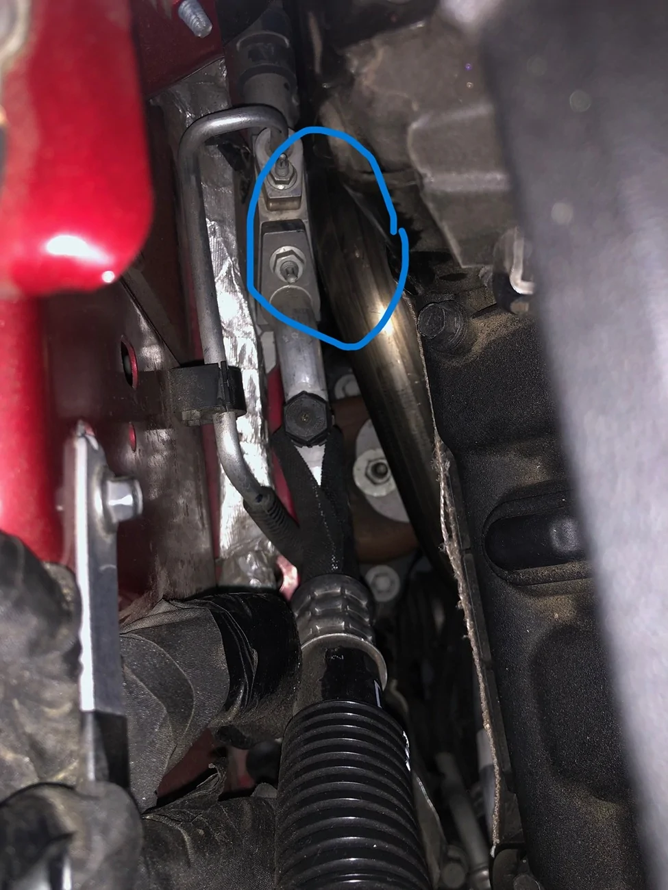

I think I got a new set of Ford OEM exhaust gaskets, but don't remember needing anything else other than what came in the kit. I think they came with O2 harness extenders, at least my kit did.
One thing, the headers were super tight around the AC bracket. Really tight. I ended up using a piece of silicon turbo tubing, bent it 90 degrees and drilled a little hole in it so that I could put it between that AC component and use a nut to hold it on. I did it to reduce any chance of the metal-on-metal vibration causing false knock. Seems to have worked, my tuner said he didn't see any false knock in my logs.

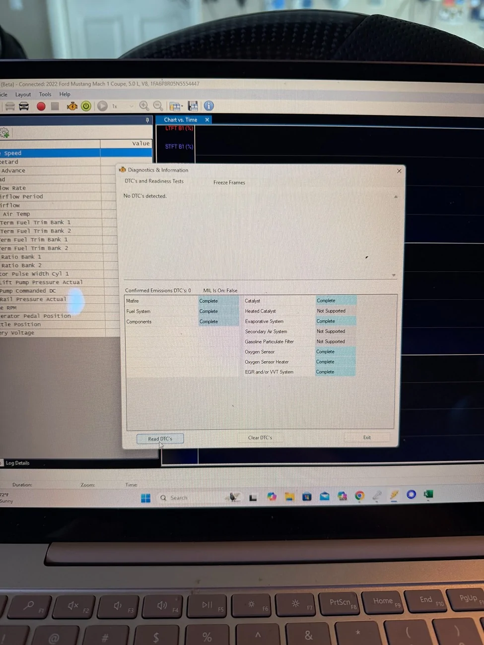

The factory connect works with the Steeda H/X pipe. I had that setup for awhile. I just installed SP headers to my SW cat back and had to get the different H pipe and elbows for the performance connect. I went to Gesi 450 green cats. I ran the defoulers with the install, so will see if they are actually needed after some miles. Wont really know until you know. They are cheap, regardless. Trying to pass for readiness monitors for inspection. I purchased new ford header gaskets and hardware. Don't need to since can reuse the factory ones and the SP headers come with the hardware. Car is definitely louder across the board. Sounds mean AF. Is louder across the board. Cold starts my neighbors may hate me now. 0730 today and could feel the eyes on me lol. Can def feel the torque curve change to higher up in the rev range. The OEM headers had a deeper sound. FWIW
You might clear the CEL but I doubt you'll get the emissions to go ready. and you'll likely screw up the FAOSC.
I got it to pass. Emissions is all good
