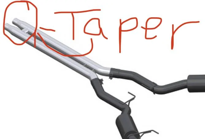

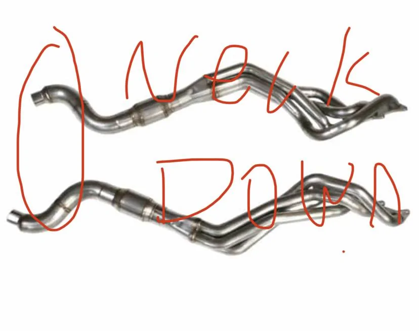

I bought a set of Texas Speed headers with the off road connection pipe. I have MBRP street cat back system on now. The MBRP mid pipe has a tapered end at the connection pipe end and it doesn’t look like it will mate to the TS pipe. Do I need to by a resonator delete pipe to make this work? Who makes a 3” resonator delete? Everything I’m finding is 2 1/2”.

No. Your factory coupler/clamps slip over the tops of the taper.

Exactly as sabtaj has said. The tapered ends butt up to each other and the factory band clamps overlap and tighten. The connections there do not slip over each other
