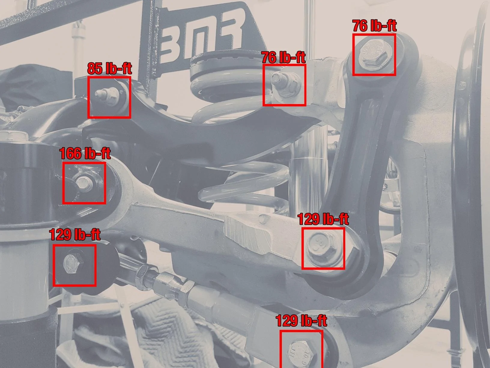

I have asked them to do the following according to the tip from @BMR_Tech
FRONT: (anywhere there are rubber bushings)
Front Radius Control Arm - inner mount
Front Lower Control Arm - inner mount
REAR: (anywhere there are rubber bushings)
Upper Camber Link - inner and outer mounts
Toe Link Outer Knuckle Bushing
Rear Control Arm Front Inner Mount
Rear Control Arm to Knuckle Mounts
Anythig else I should ask them to do?
