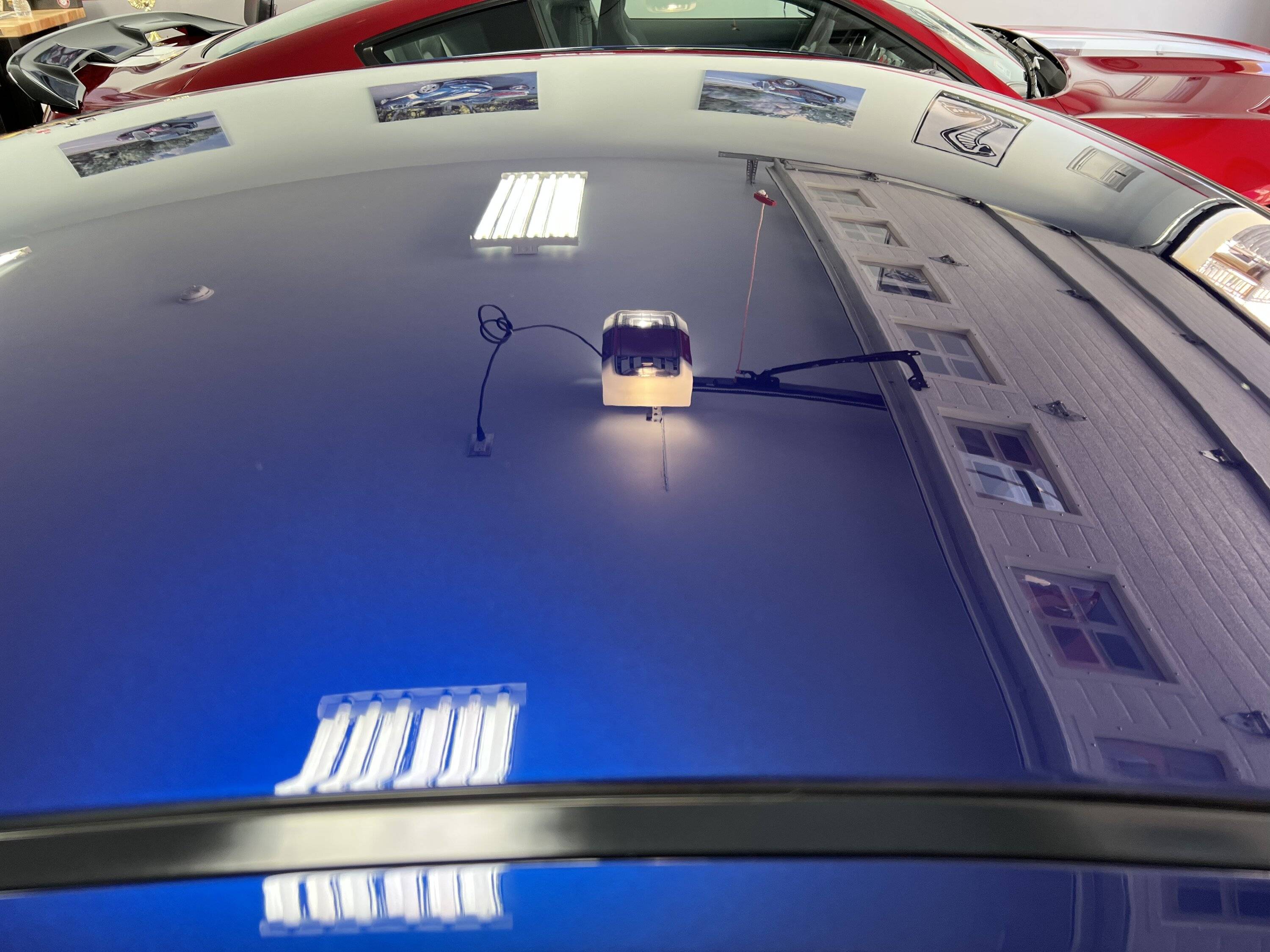

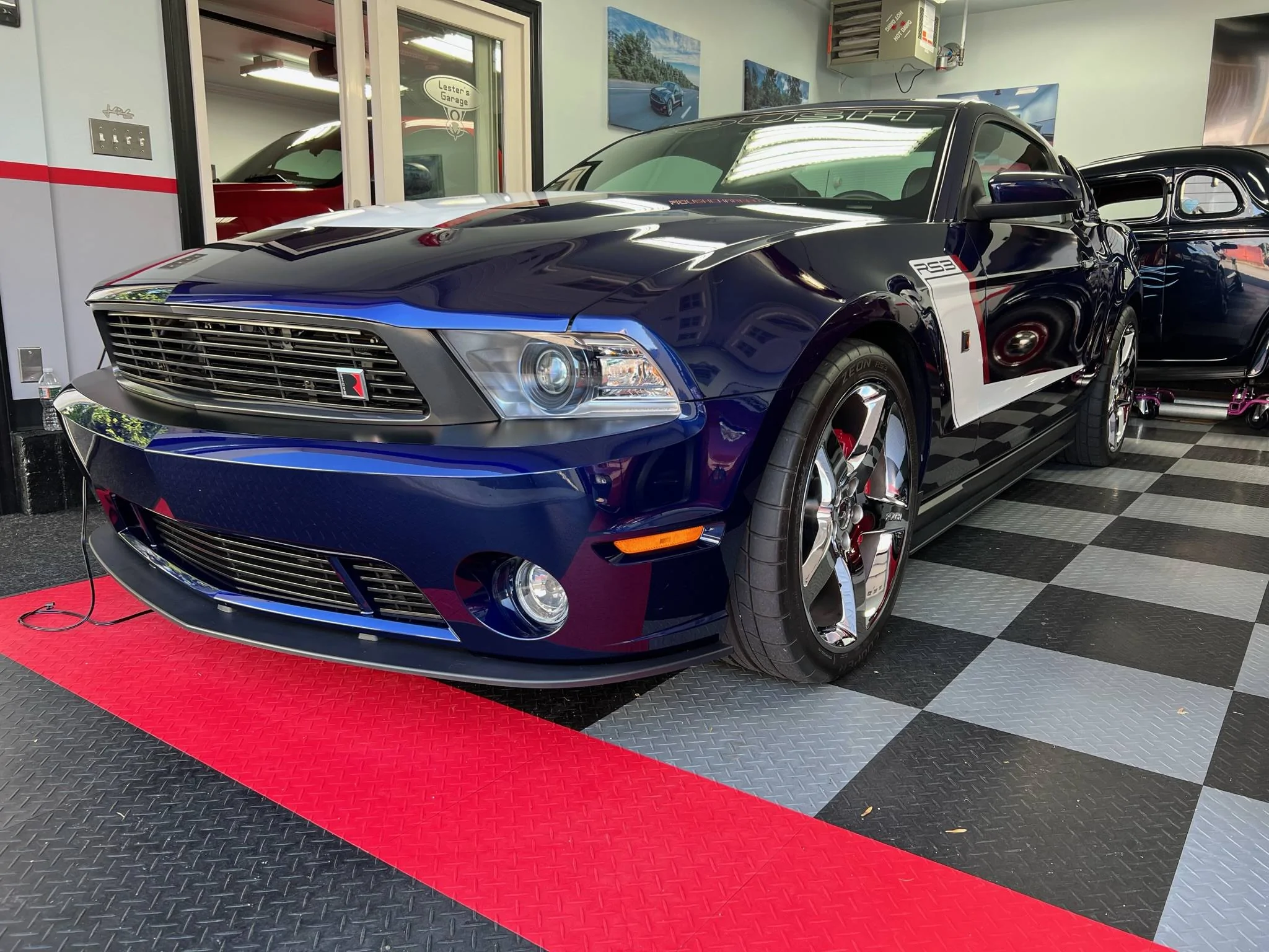

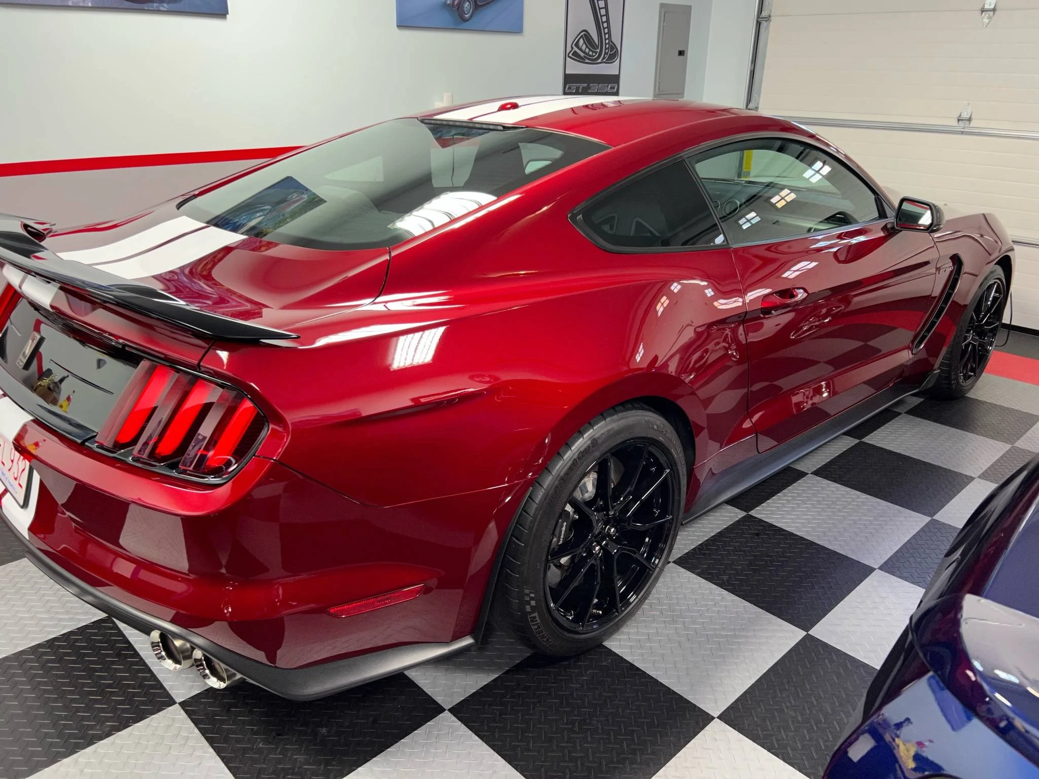

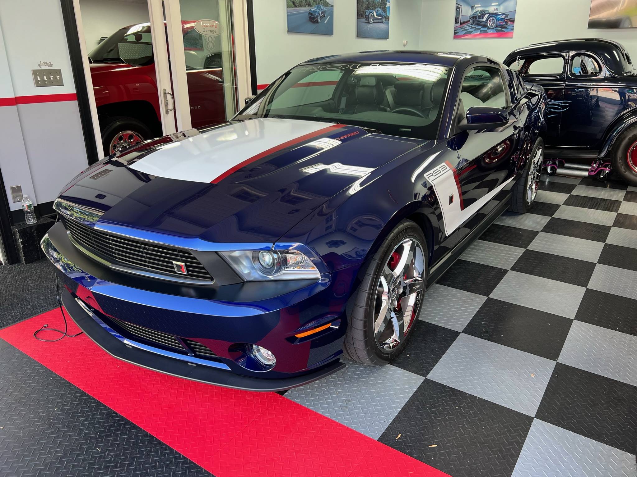

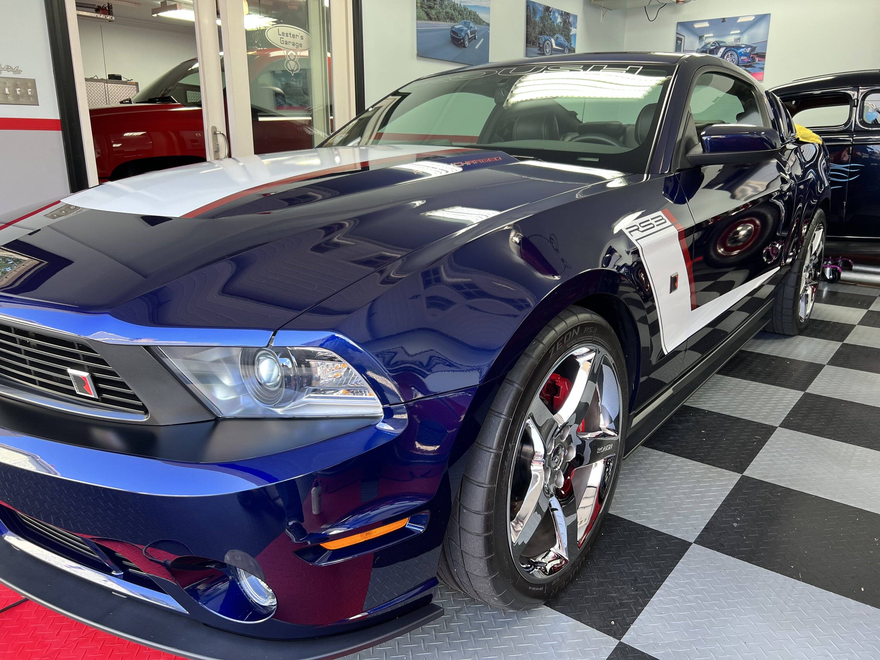

Hi Mark! The following is just my opinion. I’ve had this discussion/argument with more people than I can count. I’ve chased high end carnauba waxes for over a year. When I say high end I’m talking about Zymol Ital ($175), Zymol Concours ($244), Zymol Destiny ($1045). All have high percentage of carnauba but the issue I had with all of them was the carnauba melted on the top surfaces of the car on really hot days. Carnauba melts at 180 degrees. The hood on a black car in the sun looks like it has an oily film on it and you can write your name in it. It will wipe off but reappear on a hot day. All that money spent and I wasn’t happy.
I have two things I’m interested in when it comes to wax. Shine and longevity. I have a gloss meter, like the name implies it measures gloss. I take about 25 measurements and take the average. It takes away someone’s opinion of what is shinier. I strip the wax off one of my cars use what ever wax and do my measuring routine.
when I detail a customers car I record the process of everything I used on my IPad. When they come back I can I can see and measure what products are superior. On my own vehicles I don’t care about longevity because I’m constantly detailing them. It does matter on a customers car. My absolute favorite wax for my own cars is Koch Chemie WO.01 Highest numbers on my gloss meter (average 108) Ridiculously shiny and crazy slippery.
Below is a list of waxes/sealants that I really like and strongly recommend. I haven’t tried every wax on the planet and I’m sure there’s some awesome stuff I haven’t tried yet. But I can tell you with confidence these products work well. I just looked at my spreadsheet on my IPad and I have 66 products in my arsenal. I’m not going to list them all!
Koch Chemie WO.01
Koch Chemie S0.02 sealant
PolishAngel High Gloss Sealant
Polish Angel High Gloss Wax
PolishAngel Cosmic Spritz
Wolfgang Fuzion Wax
Wolfgang Deep Paint Sealant
All the above have measured the highest numbers on the gloss meter. I’ve got a ridiculous amount of other products that are good but just don’t give me the higher gloss numbers.
A comment about the PolishAngel High Gloss sealant.
After the product is applied to the car it looks really unbelievable. 12 hours after it cures it‘s ridiculously shinier.
The gloss numbers confirm it. But you don’t need a gloss meter to measure it you can see the difference, it hits you in the face.
Again just my opinion on all of the above. I know there’s other very passionate opinionated detailing people out there and their cars look awesome. When I get into a discussion/argument on products that someone says is better I hand the the gloss meter and say show me!

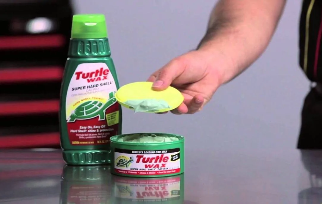

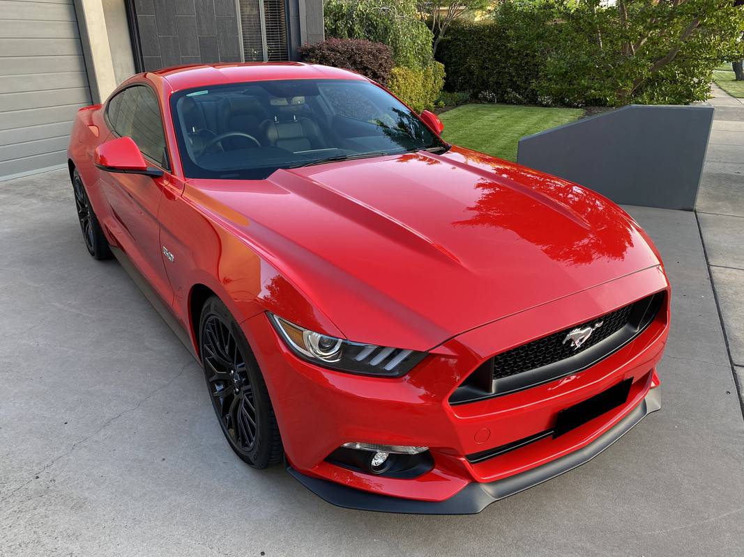

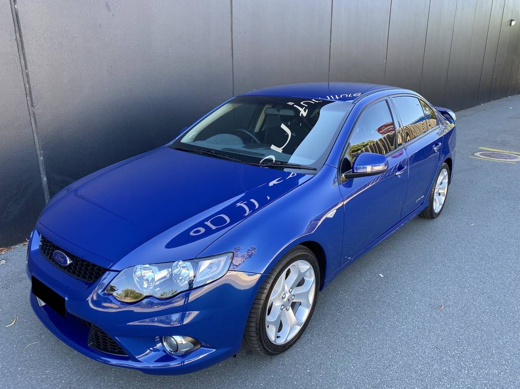

It's been nearly 20 years since I have used a Turtle Wax wax product, their good old Super Hard Shell..........................
Despite messing around with ceramic coatings of late, I still think traditional waxes and sealants have a place, both in terms of the way they look and the user experience. There is a certain level of satisfaction in applying and admiring a wax, hard to describe but definitely a factor.
For me, if I'm reaching for a wax or sealant, I have two that come to mind above all others -

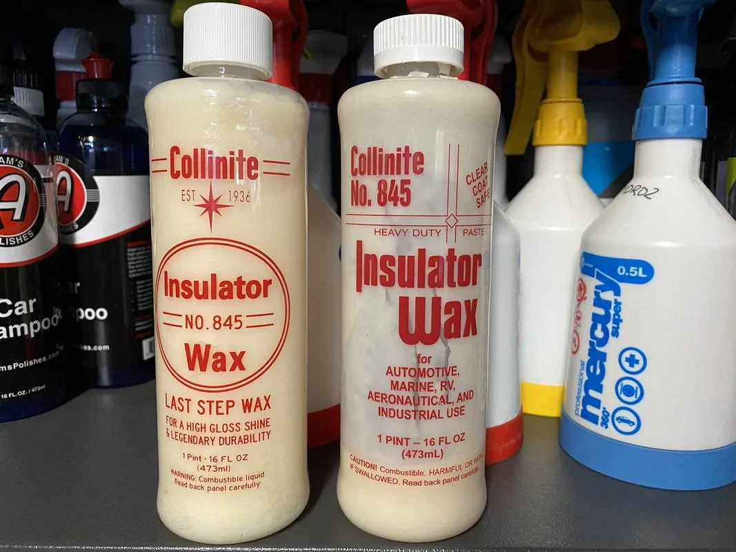

Collinite 845 - a very old, very proven liquid wax that is just magical in how it makes paint look. You need to work for it though, 845 has a few quirks. First, you need to warm the bottle up in the sun or under hot running water to liquify the wax. Second, apply it as thinly as possible, more is NOT better and will only make the removal a pain. I use a soft finishing/waxing pad on my polisher to get smooth, even and THIN coverage. When applied as such, the removal is smooth as silk. Lastly, as the product cures over the next few days, it can exhibit a slightly hazy appearance, this is completely normal and is removed at the next wash. The gloss actually improves further after a day or two after application as well. Durability is between 4-6 months depending on conditions.

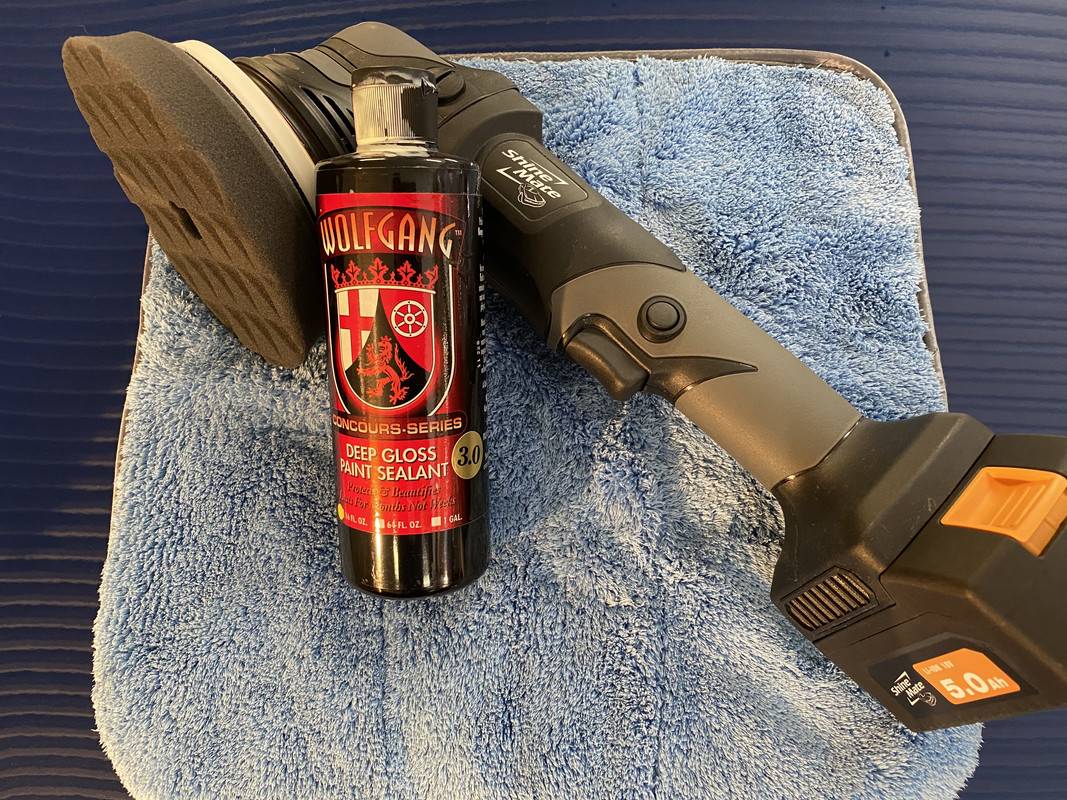

Wolfgang Deep Gloss Paint Sealant - this is another proven performer, one that absolutely excels in the gloss and slickness categorys. Again, a product that has a quirk or two. (I would say at this point that product "quirks" are not restricted to these two products, all LSP's have an application quirk, even ceramic coatings). Apply Wolfgang DGPS thinly, again I use a polisher for this, to the whole car in one go and leave to set for 45min before removal. You will marvel at the wipe off, it's smoother than 845 and a truly enjoyable process. DGPS is oxygen activated and needs a 12-hour cure before getting wet or damp to ensure a thorough bond to the paint, so plan accordingly. Wolfgang don't really advertise a longevity claim for DGPS, I would say expect 3-4 months on a daily driver, a year or two for a garage queen.
It's pretty hard to beat Wolfgang DGPS for gloss.................................

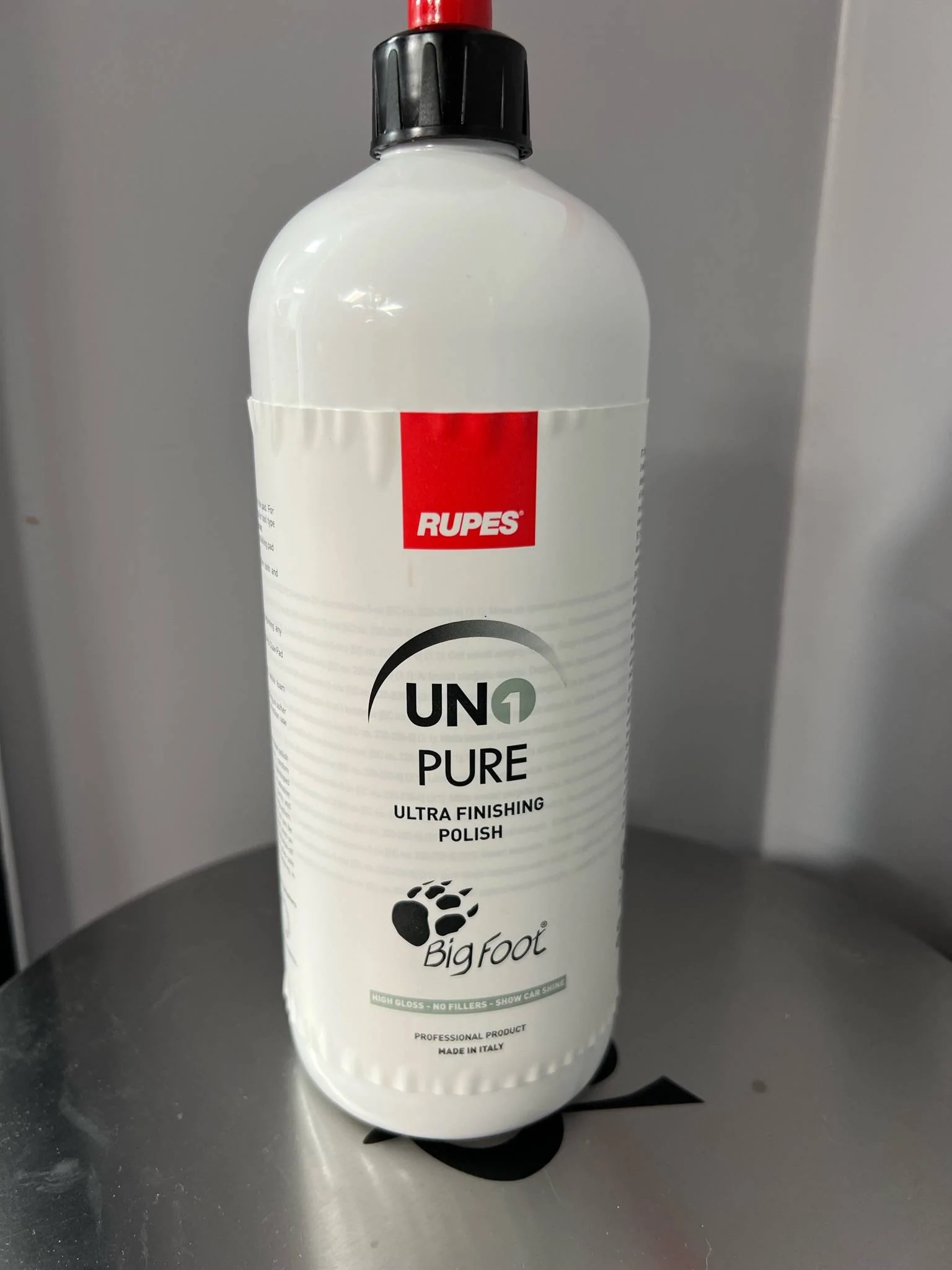

Another product I didn’t mention that works really well if have a machine to polish with is Rupes Uno Pure Ultra Finishing Polish. Great on soft black paint or on a car that’s been paint corrected and you want little extra pop.

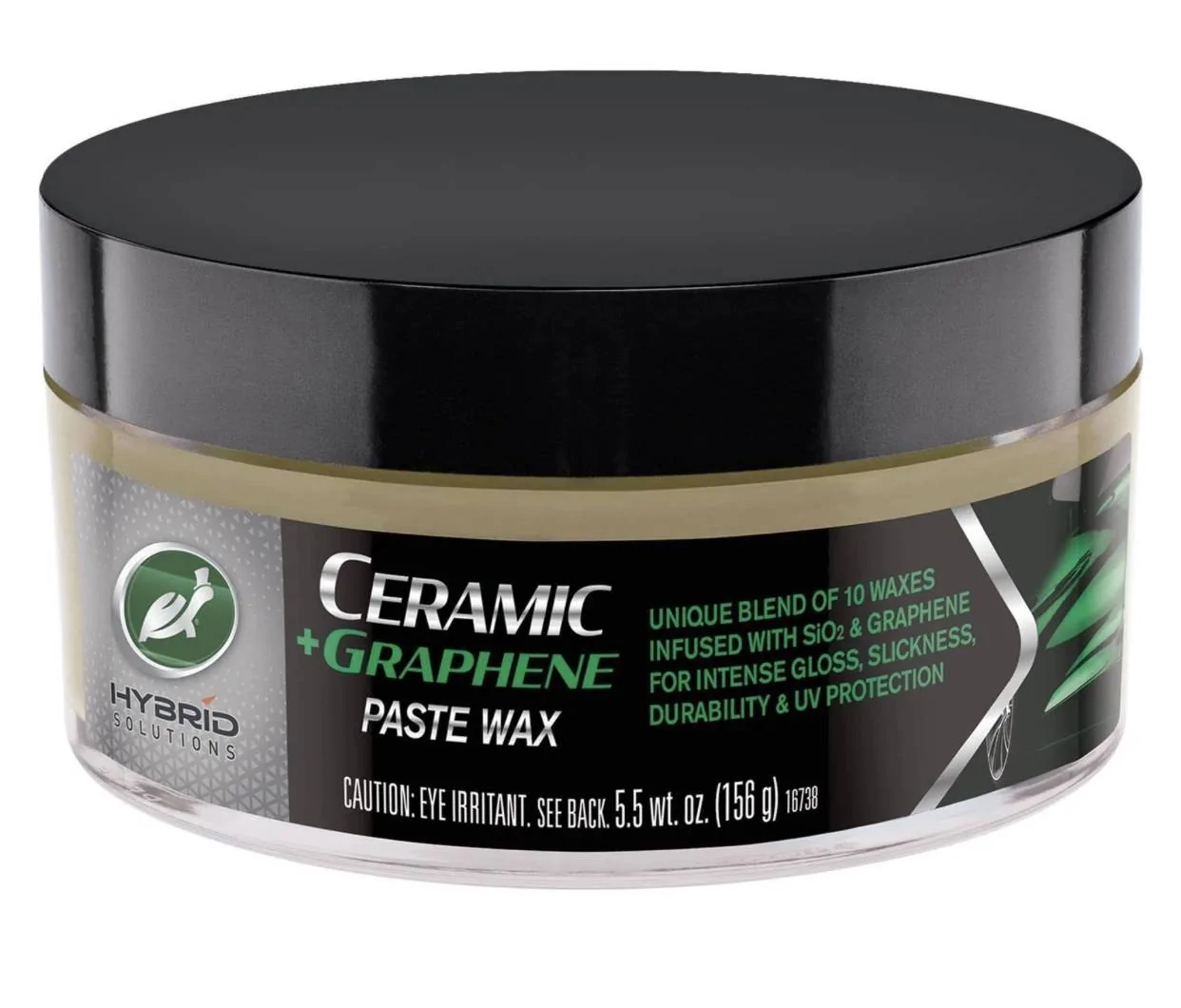

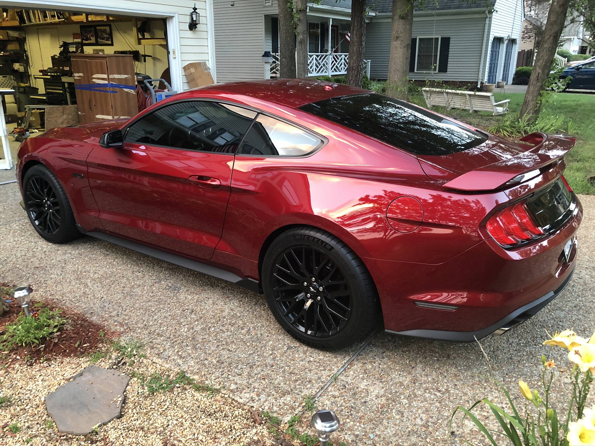

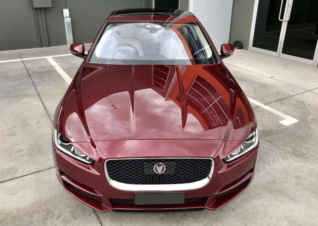

I have used the new turtle wax graphene ceramic and a blend of other things with good results and last longer than the the traditional turtle wax.. not a great picture but the gloss is very good

Wow! What a great color! Nice choice!:like:
