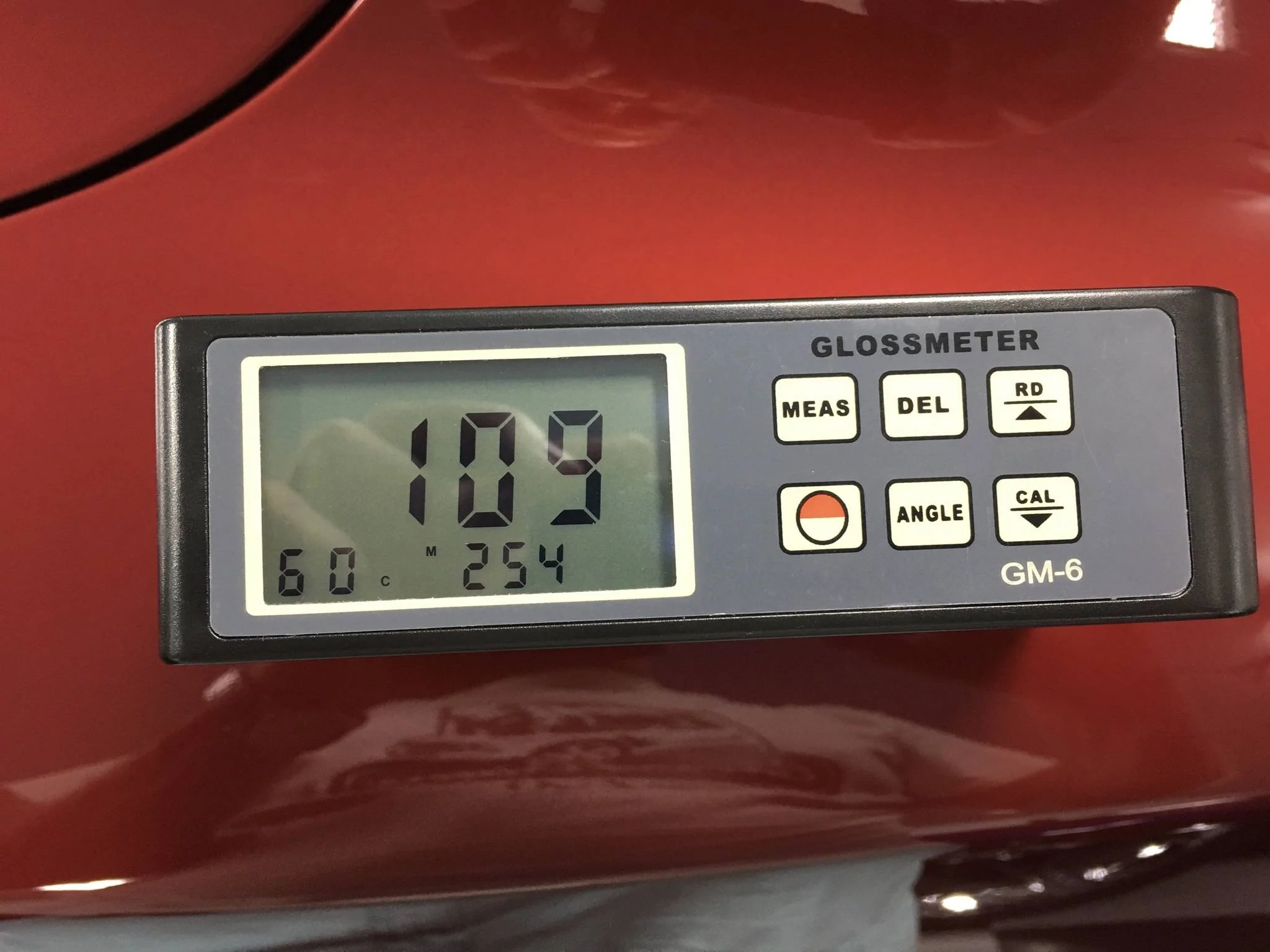

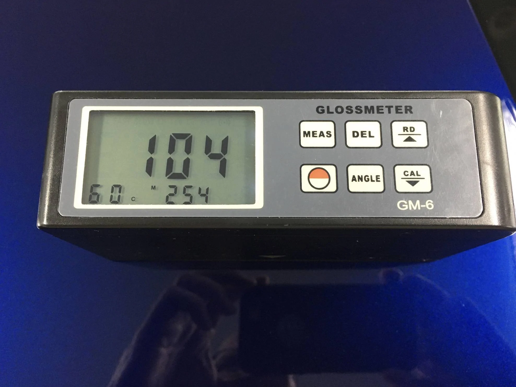

From my testing with a gloss meter, layering does not increase shine/gloss. It might help longevity. If you strip the wax or sealant off using a paint prep product and then apply what ever your favorite product is, that’s the best shine/gloss your going to have. Two coats sometimes, depending on the product help shine/gloss.
I’m guilty of waxing my cars waaaay to much. Measuring the end result my gloss meter the numbers go down. Then I strip it, light polish, apply wax or sealant and the numbers are crazy high (104 to 110). A finish that is in the high nineties looks incredibly shiny, with a little patience and the right products the finish looks crazy meaning numbers are over one hundred. So my obsessive cycle goes on and on like a dog chasing his tail. Wax, wax, wax, wax, strip, polish wax, wax, wax, wax strip, polish etc etc etc. Not only that! I’m doing this with all four of my vehicles. I think I might have to visit Doctor Phil! Hmmmm, I wonder if he would want his car detailed!:crazy:

There are people who swear by layering, but that right there is proof that it won't make your car shinier.
I‘ve done my testing numerous times with multiple products and got the same results. I’ve been layering waxes for ever with different brand name waxes on top of each other. (And still do, I can’t help it) After a couple months or so, I’ll pick a panel on the car, wax it, measure it after being freshly done, strip it, reapply the wax and get a higher reading on the gloss meter. General about 5 to 7 gloss meter numbers Higher. Also the color on that panel is a slight bit richer. Then I do the complete car over. If I’m trying a new wax or sealant I do the exact same thing on a panel except I split the panel in half, one half with the old product, one half with the new product freshly done, then measure both new and old. But I always strip it first to get accurate numbers. I also recalibrate the meter each time. For me it’s the perfect thing to do a rainy day with the music cranked up loud!
