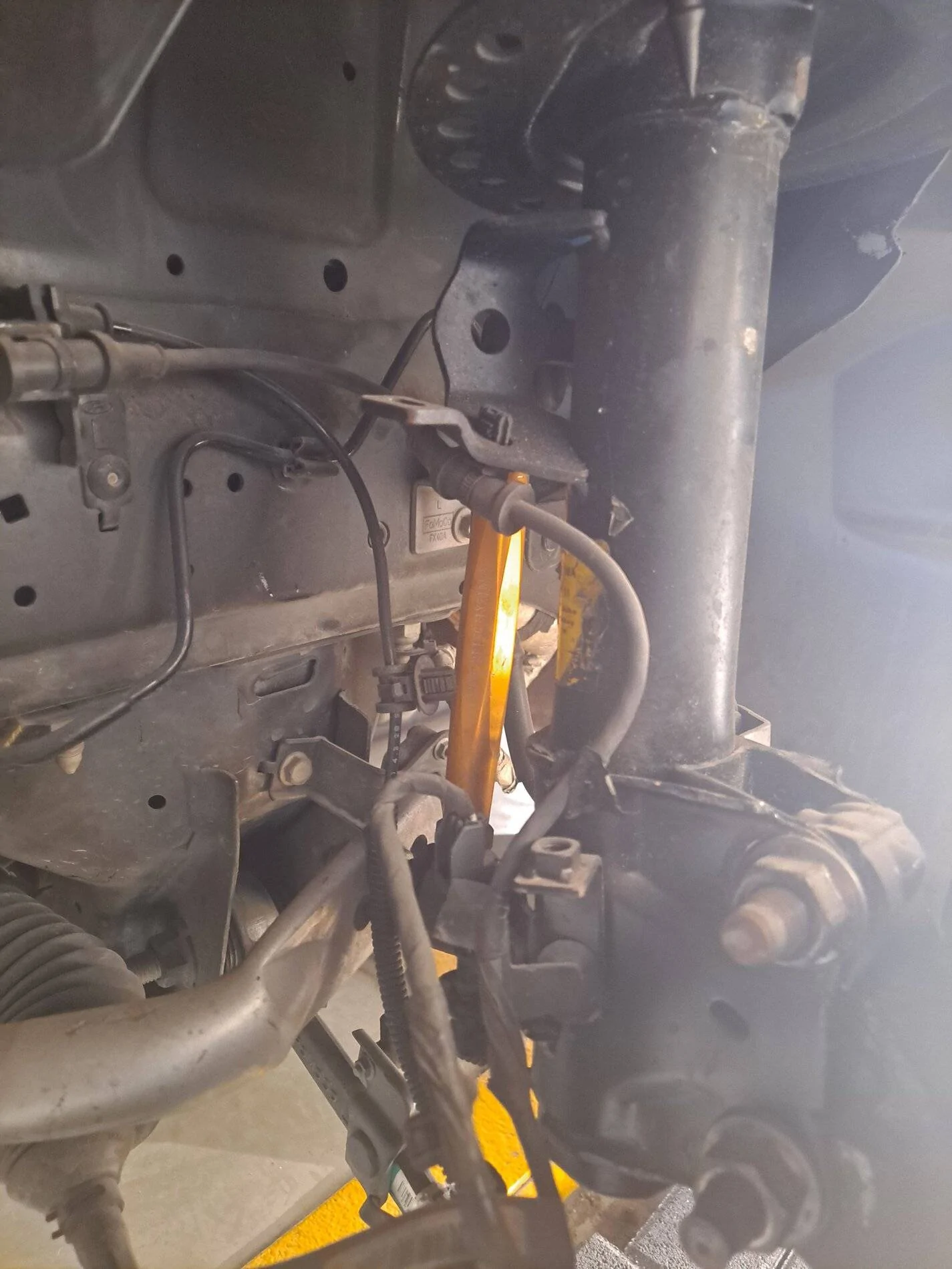

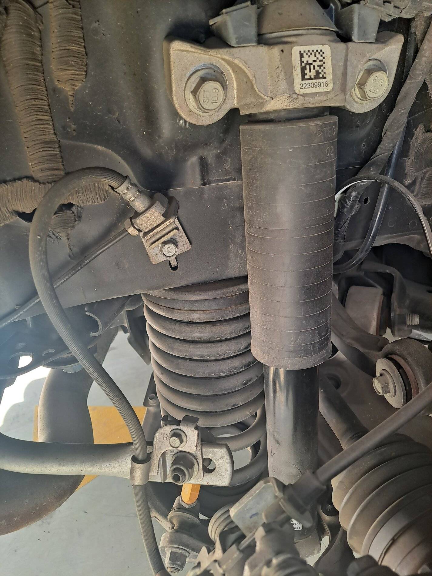

Folks I really need your help. I bought a 2020 GT PP with Magenride. I am not experienced much in tune ups, but the ride is too stiff and I feel every bump on the road and the dampers are not working at all to make the dumps easy on me. I have been looking around if someone can help me figure out the reason for this stiffness.
After researching for many days I found out that the sway bar is not stock (the yellow thing in the picture. I think it is Whiteline brand?)
and I was also told that the springs are not stock.
So my questions are:
- What springs are these? can someone tell from the pictures?
- Will it drive like stock if I buy stock springs? and the lowering will be gone?
- does the sway bar contribute to the stiffness?
Any other valuable information is really appreciated as I am totally new to this. I love the car but I really hate the harsh ride and I dont know what's causing it.

I'm no expert, but I'd say somebody lowered that car too much and probably didn't take the Magneride into consideration. If you're ok with a slightly stiffer ride than stock and being 3/4" lower than stock, you should look into the Ford Performance handling kit that is made for cars with Magneride. Also, the yellow part you're referring to is just the sway bar end link, not the actual sway bar.

Thanks for your reply. So what lowers the car this much? Is it the springs alone? The end links? Or everything?
I already bought a second hand stock springs and waiting for them to arrive, but I wonder if I should do anything else to return it back to stock (in terms of height and ride quality).

The springs lower it. Both the springs and swaybars contribute to the rough ride.
The swaybars are adjustable tho, and yours appear to be set on a medium setting. You could/should absolutely set those to the outer most hole which is the softest setting if the ride is bugging you (in addition to changing out the springs).
The endlinks are just more durable that the stock ones, no negative impact on ride.

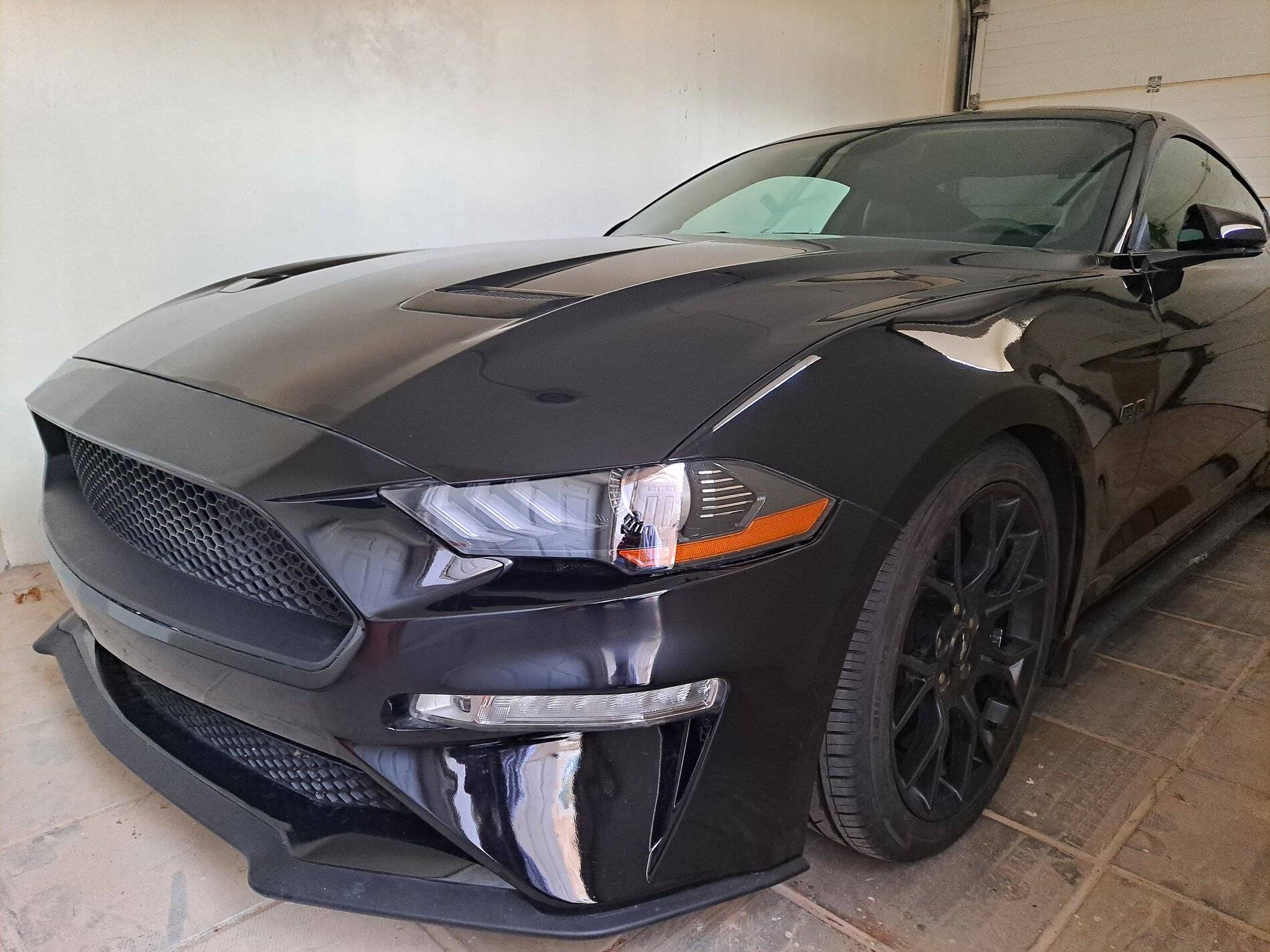

This is unrelated, but it looks like your car has two different side skirts.

The car is so low that I lost the right side skirt in one of the bumps !!

Thanks .. I will adjust it to the outer hole once I do the spring job.
